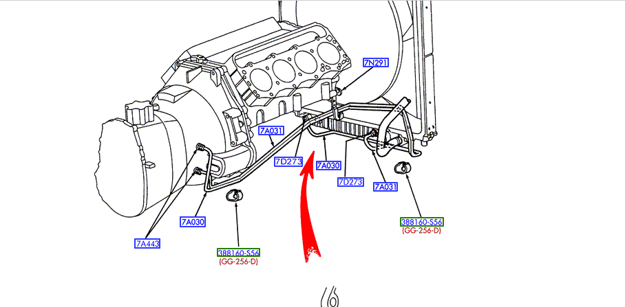

Since transmissions do not have drain plugs on the converters, dropping the pan will only get you about 1/3 of the fluid changed which isn't worth the time doing which is why most places us a flushing machine. It hooks up to the transmission cooler lines, the tech will put 12-14 quarts of new fluid into one tank which will then be pumped into the transmission, via the transmissions pump, while old fluid is being pumped out. In this case, the only thing going in or out is transmission fluid, no chemicals. There are a bunch of companies that spiff service managers and techs to use a flush product (bottle of snake oil) that is supposed to protect and clean the transmissions guts better than just fluid alone. Whatever.

What is this intake flush you speak of?? Basically flushing the high pressure fuel lines? First I've heard of this.
Anyway, I am not in the automotive industry, so I can't claim to be an expert. My father was an engineer for Ford and I've stolen most of my knowledge from him simply by pestering him with questions while I was a teen.
He's always said that chemical flushes/additives are completely unnecessary. The only time it becomes necessary is when you have deferred maintenance on your vehicle for too long, and at that point it's usually too late and you're just applying a band-aid.
He also said it is best to remove as much of the old fluid as you can and replace it with fresh fluid. Unfortunately in today's day in age that often requires fluid exchange equipment (especially with transmissions). But the advice I got seems to largely match what @flip said above, so I'll keep going down that path.
Which reminds me... need to see if the manual trans has cooling lines going up front of not. Pretty sure it doesn't but haven't really looked at it.
Manual trans doesn’t have any lines.

If I remember correctly, some of the old ZF shit I used to work on did.
True, I should’ve specified. I was only referring to the MT-88
