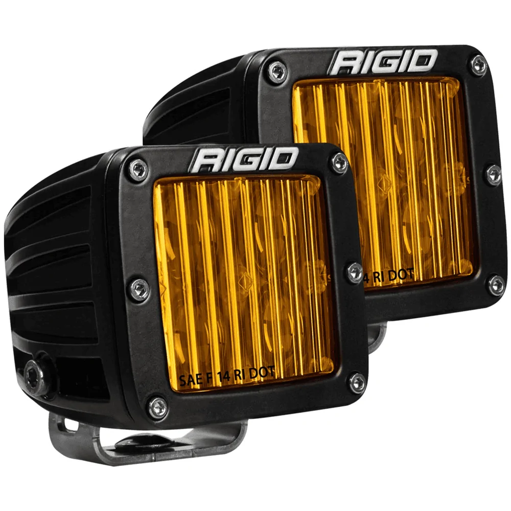

I ordered this as a solution for FOG LIGHTS for the front steel bumper. RIGID Brand to match factory ordered lighting equipment. It comes with mounts, wiring harness and a switch (won't need the switch if you have the overhead accessory switches. $294.00 Note: I will post as a comment a video showing quality comparison between Rigid and a cheaper brand. The cheaper brand's housing in 7 months was all faded and even though it looked like a copycat of the Rigid, the light output was inferior. "You get what you pay for" applies.
SAE J583 Compliant Selective Yellow Fog Light Pair D-Series Pro Street Legal Surface Mount Rigid Industries (rigidlightshop.com)

Good choice and I will be going with clear lenses mounted in the triangles on the modular bumper. Looks like a single screw right in the center and these may just slip right in at 3" in size.

:love:Wow those look good. I would of thought they would be more expensive.
Now you have me looking through the Rigid catalogue:unsure:Good find(y)

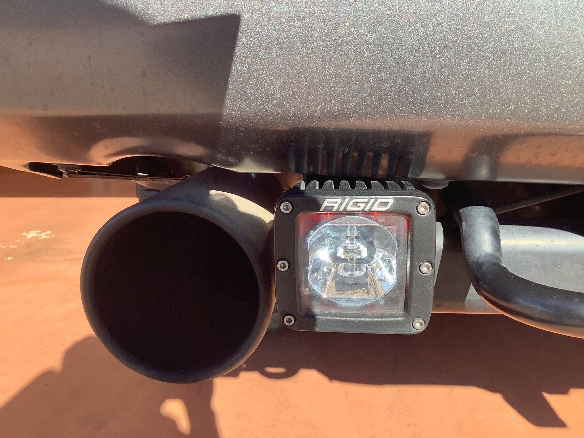

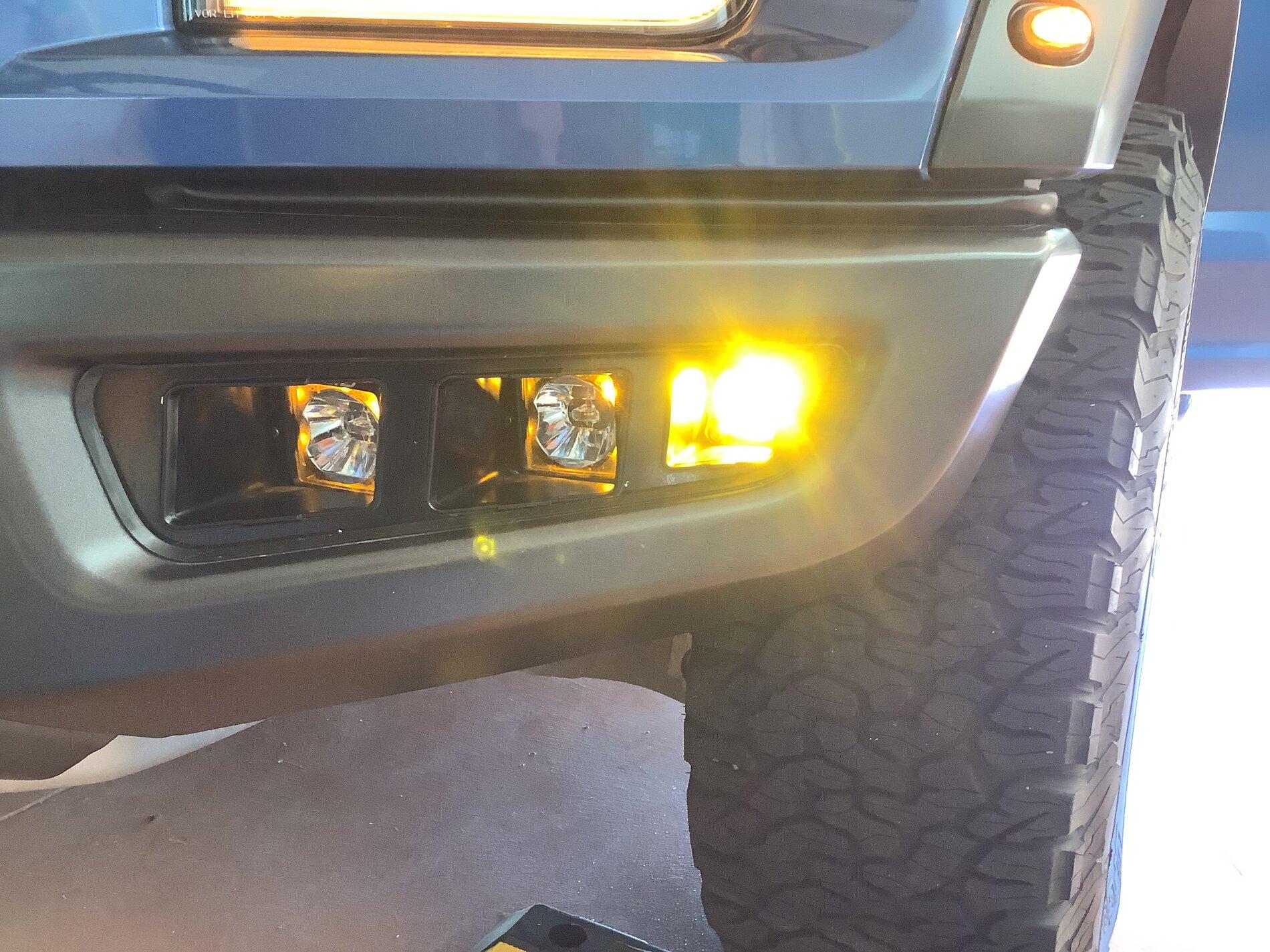

They make an insert for the Raptor bumper. I use the upfitter switches to run . The lights are Rigid. I use the fog and the white lights for running lights. They clear lights have little tiny amber lights in front and red on the back. The rear are hooked up to my reverse lights with a diode. I can turn on the front white and reverse lights with different switches View attachment 81286

I just received them. Very nice and well made. Now I just need a Bronco Steel bumper to attach them to!!! :cool: :ROFLMAO:

I was originally looking at something like two Rigid fogs and mounting on top of the bumper, but now I'm leaning towards the 6-light kits that fit in the openings of the bumper like the Raptor. I expect they'll have a kit for the Bronco before I get my MY22.
@RRaptor Am I correct in assuming each pair of lights is designed to be connected to a different switch?

I am using 4 of my upfitter switches. The lowest power ones.
#1 for the amber and red backlighting
#2 for the front amber fog
#3 for the front white lights
#4 for the back white lights
I put a diode into my reverse lights so they don’t back feed power into the system when I use switch 4, and the back lights come on when I use reverse.
