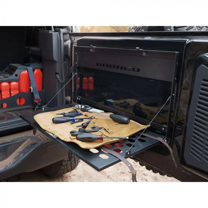

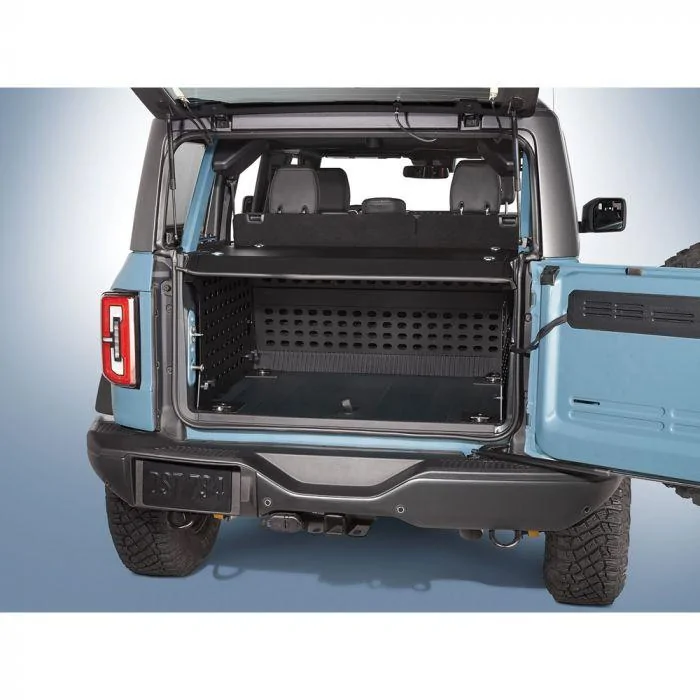

So I am looking to add the deluxe raised lid cargo area enclosure and possibly the tailgate folding table and I was wanting to see if anyone knows if they are compatible. Also, would like to hear anyone’s experience using your FordPass Points and ordering through the dealer. Anyone had luck with getting the dealer to honor the current 15% discount? Will dealers let you order over the phone with FordPass Points? Thanks for any info!
these are the two items I am attempting to install:
Ford Bronco Folding Table and Cargo Area Enclosure Compatible? C77E9BFA-C2DF-41F7-8D83-7EF141646382
Ford Bronco Folding Table and Cargo Area Enclosure Compatible? FBA75798-58DD-4245-964F-73B5E397FCE1

Word of advice, be careful when you drill your holes for the tailgate table. I have installed two, mine and a friends the past two days. When you drill, use bit guard. I barely touched the outside, and I have a dimple. When we installed his, we used a drill bit guard and it still happened. We were super careful and cautious.
Damn it’s making me question getting it. First it may not fit under the lid of the cargo area enclosure and your the third person that has mentioned dimpling the tailgate when screwing in the table. 😳
I don’t think it was from the bolt that went into the tailgate. I think it was from the drill bit. We noticed the dimple after drilling not when we attached the table. 🤷‍♂️
Use a uni-bit or step drill bit then no grab and a nice smooth hole
Yeah, I could have used those before I installed it. I have a little dimple on the bottom left side of the tailgate. You can only see it when light hits it at an angle.

The two can be installed together, but the table knocks off the rubber edge strip on the enclosure.
