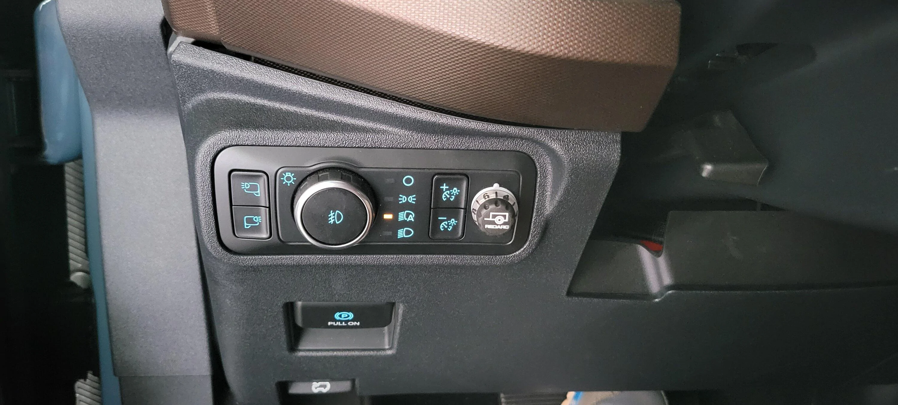

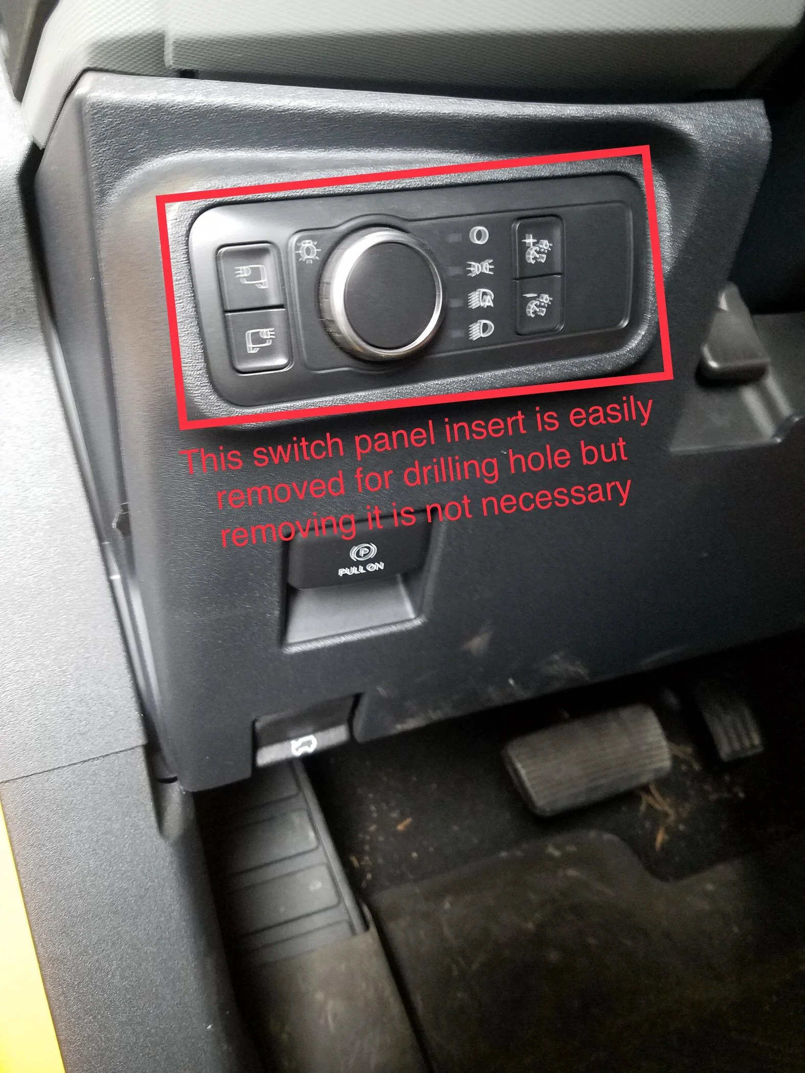

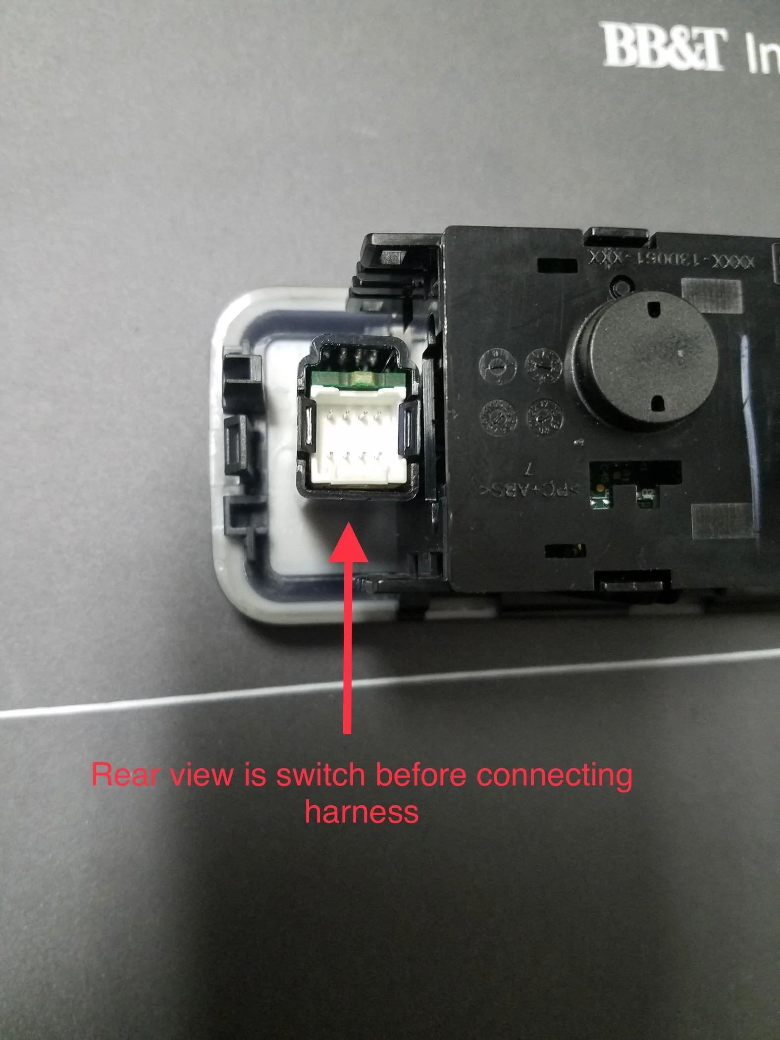

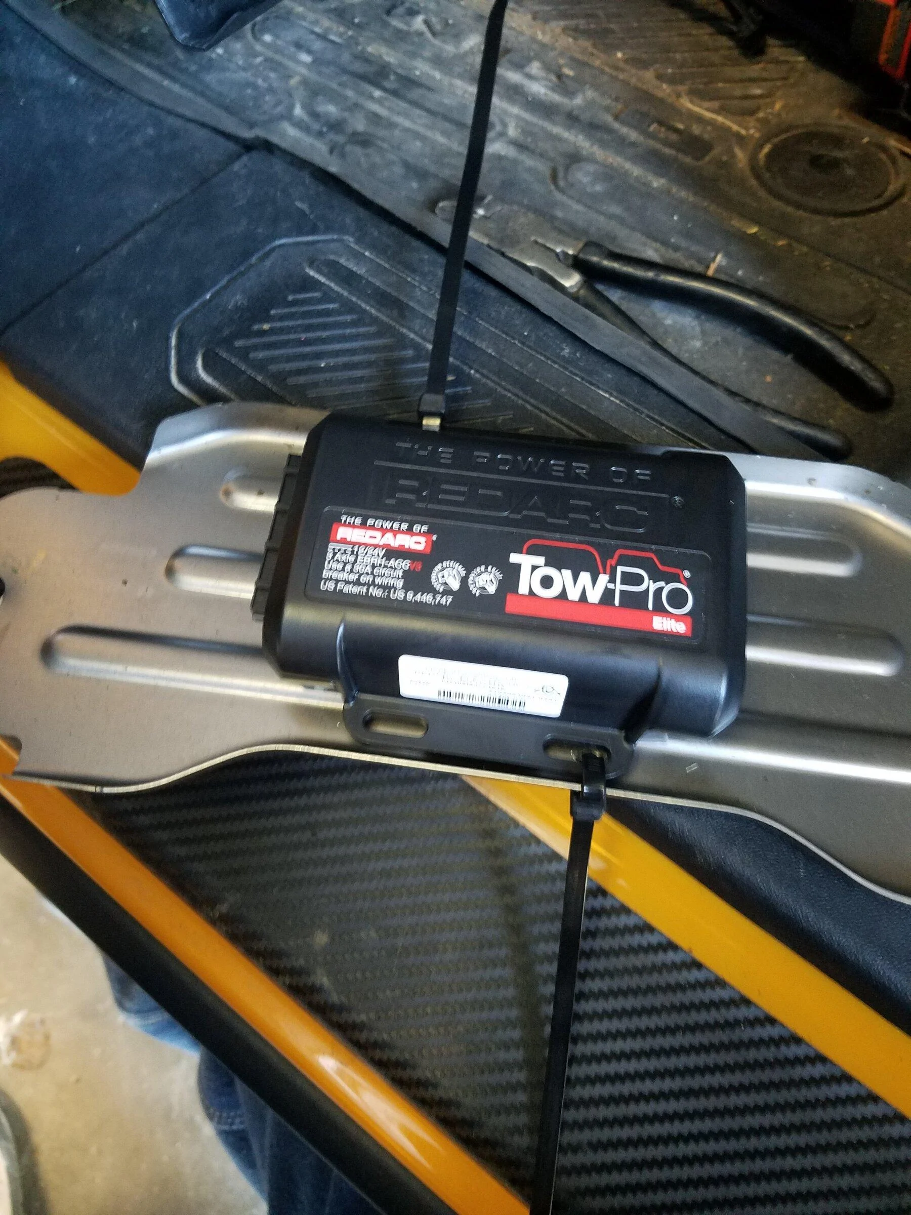

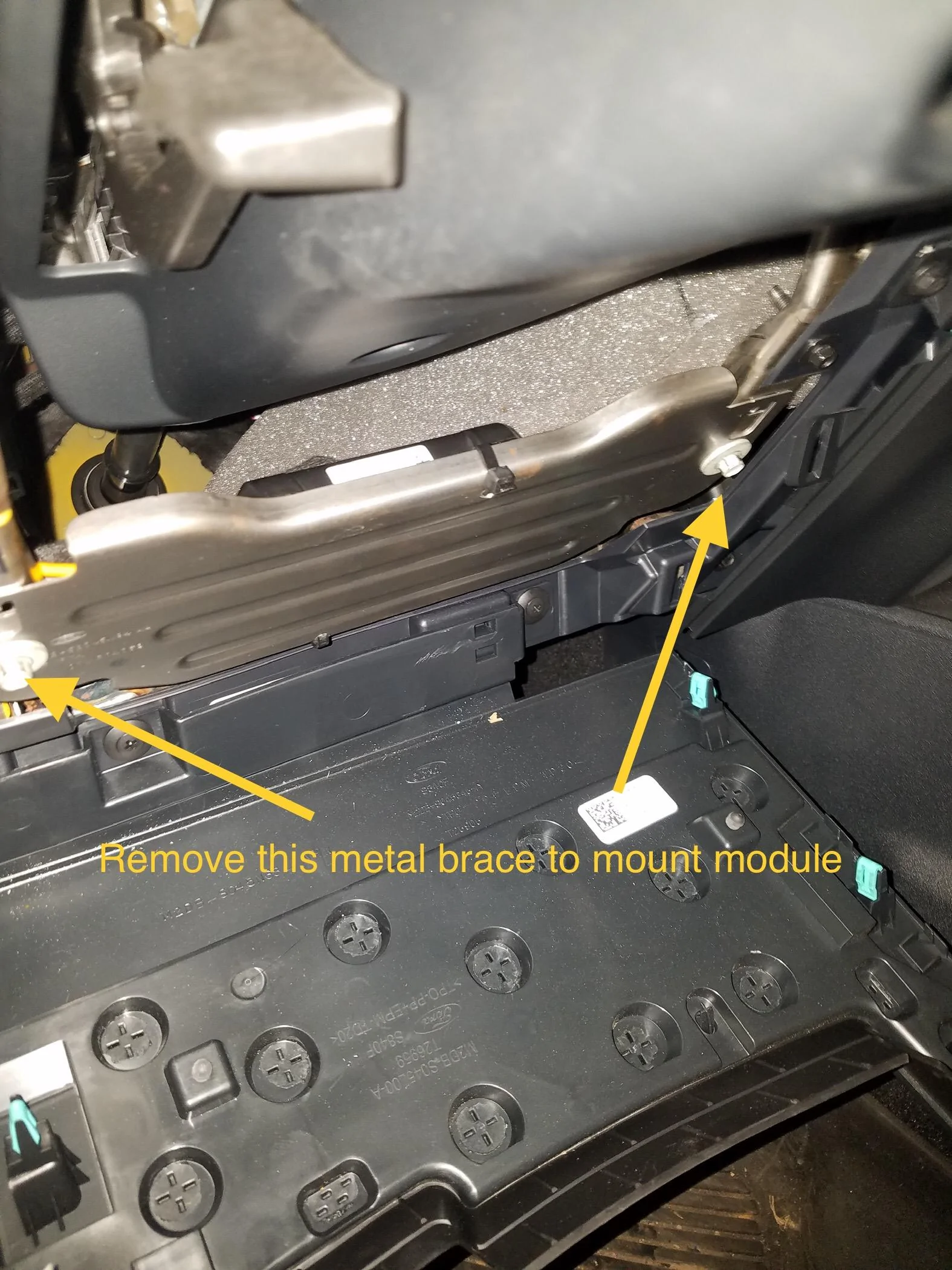

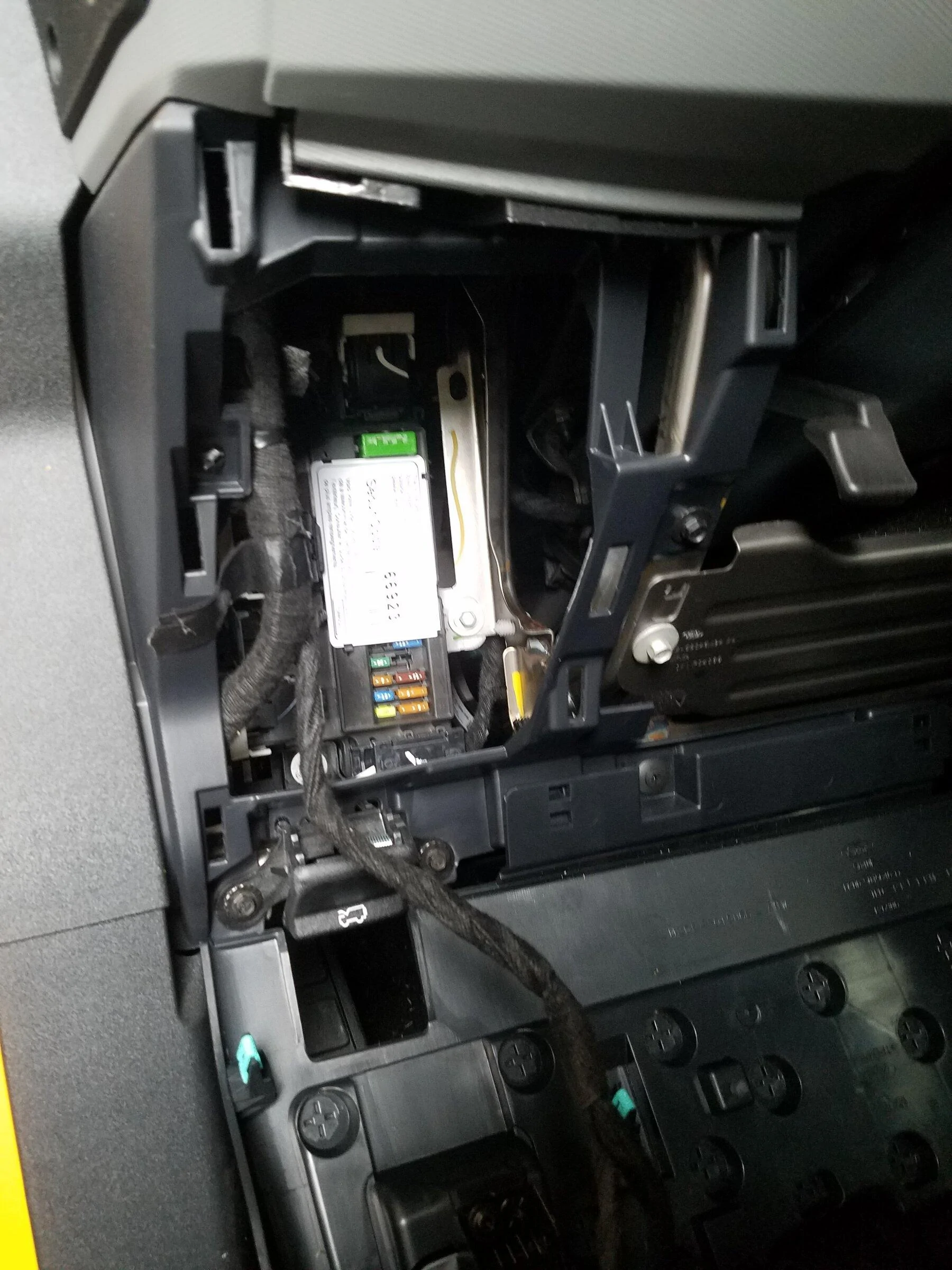

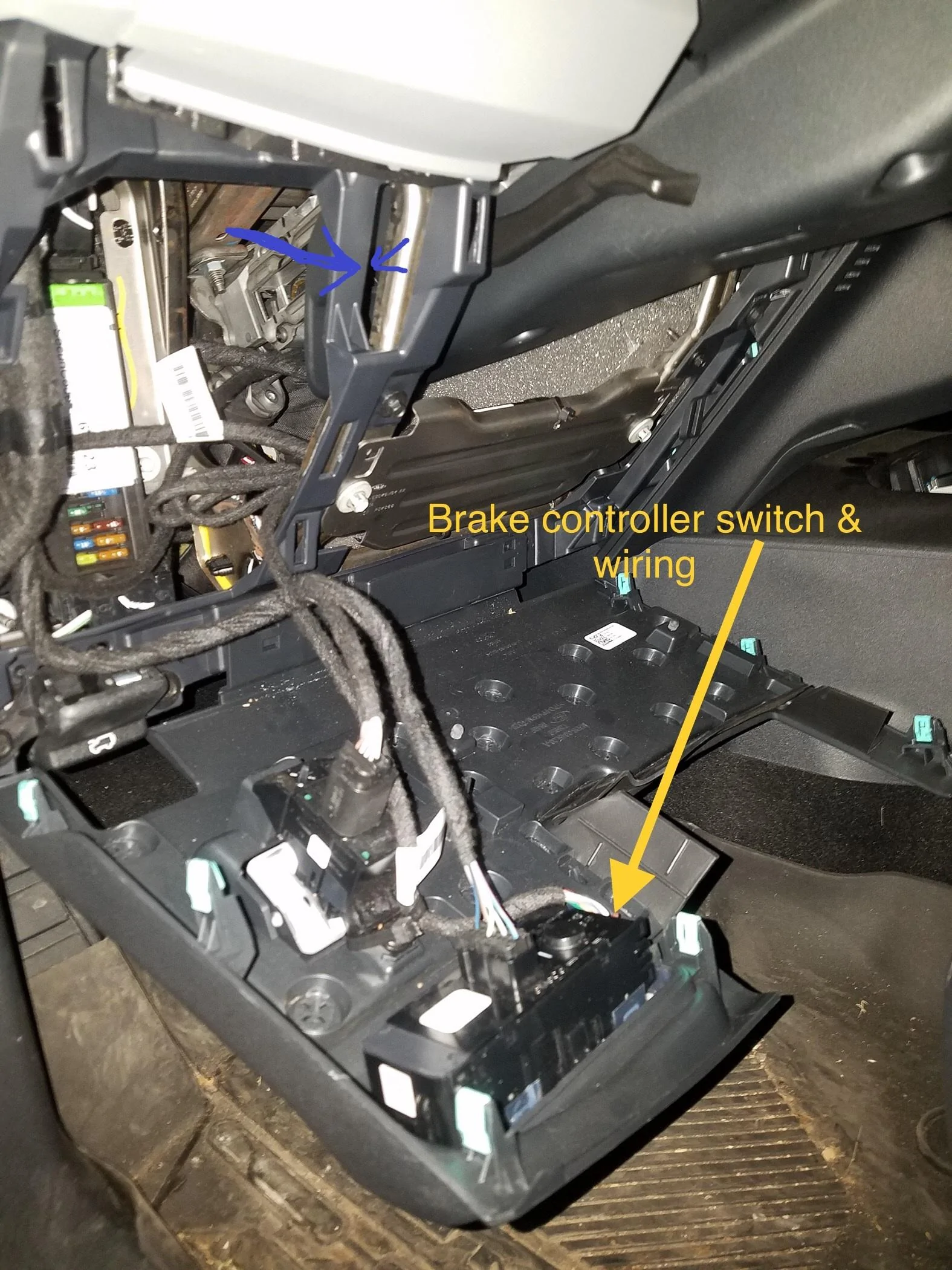

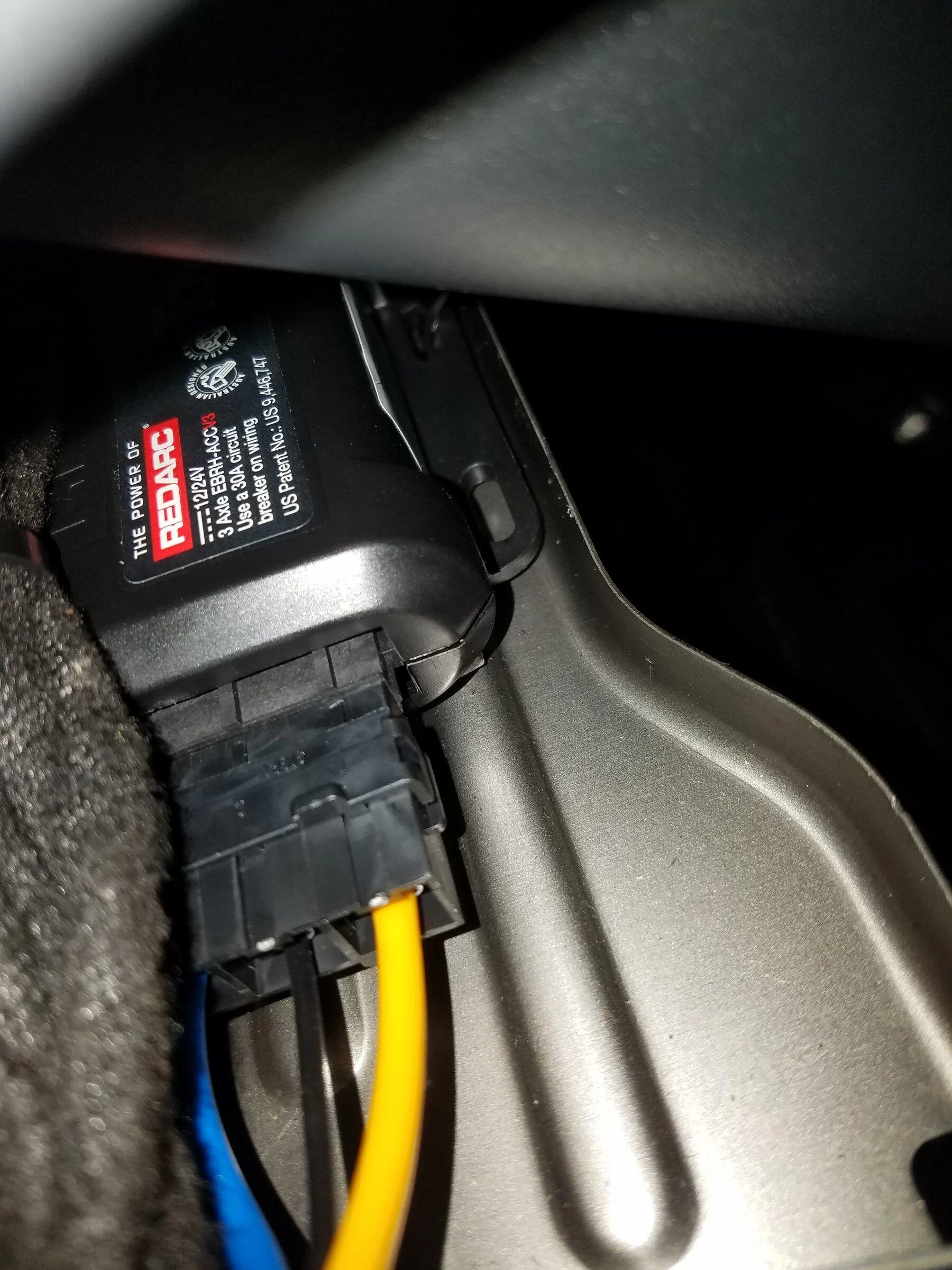

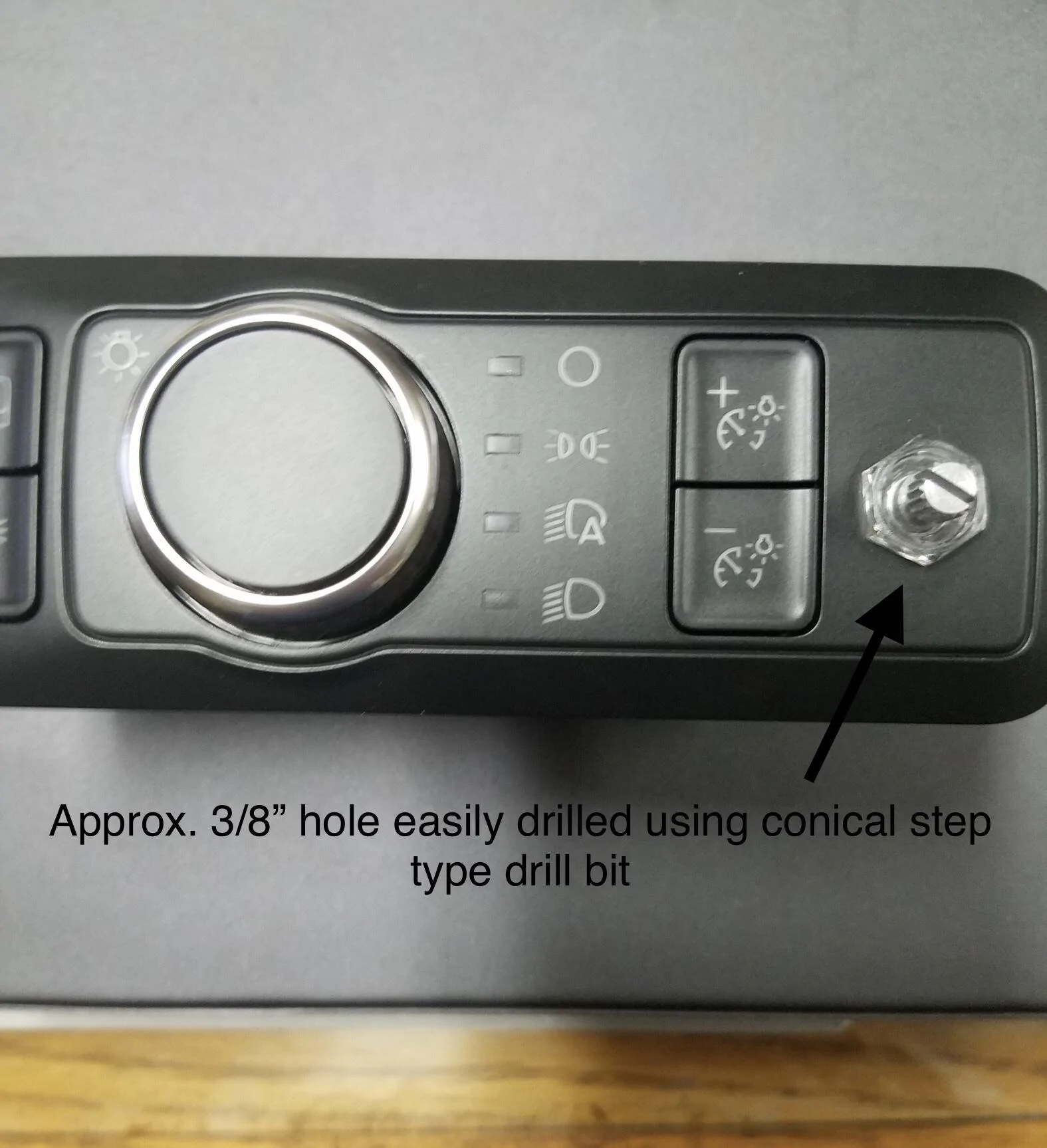

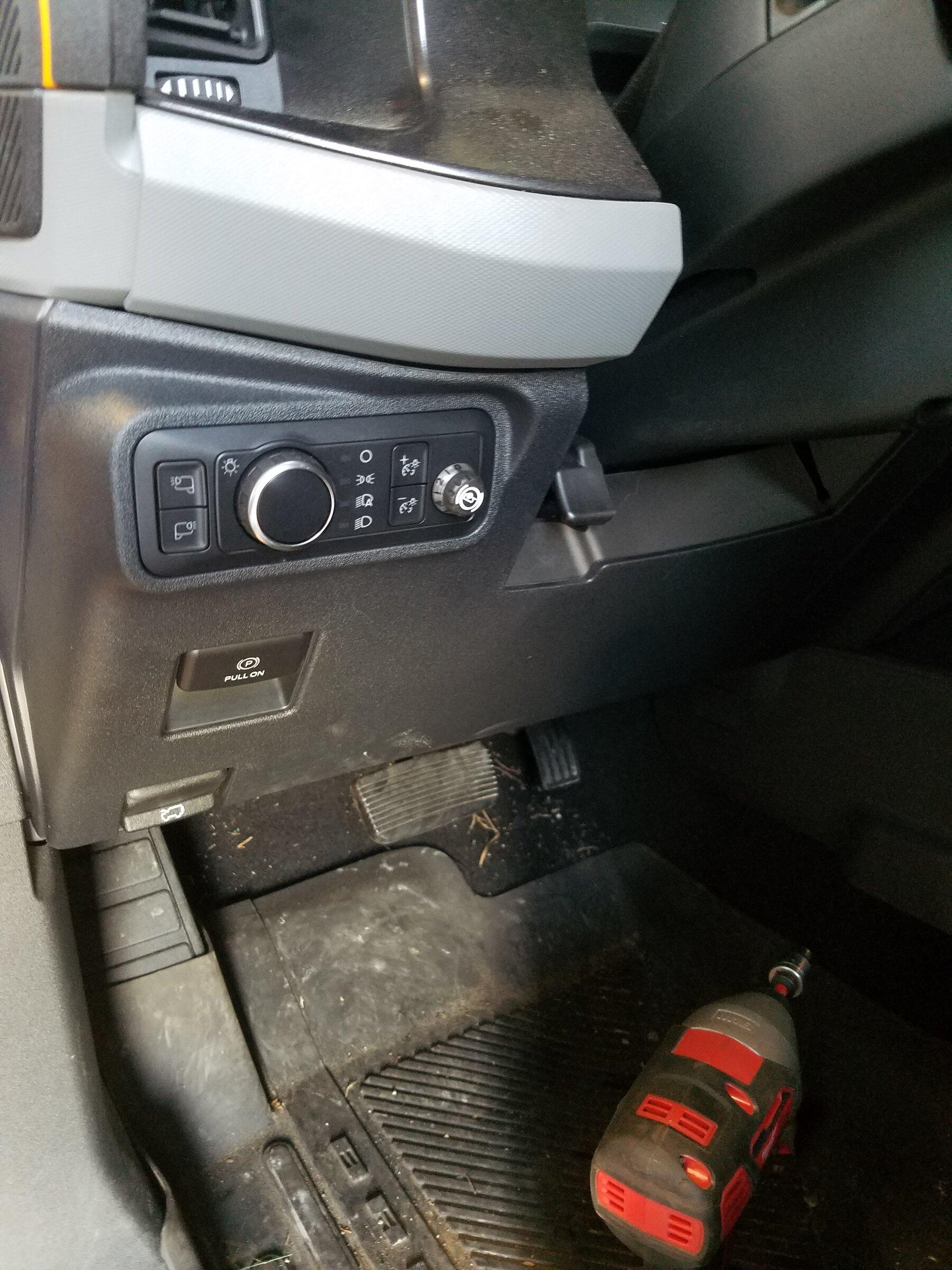

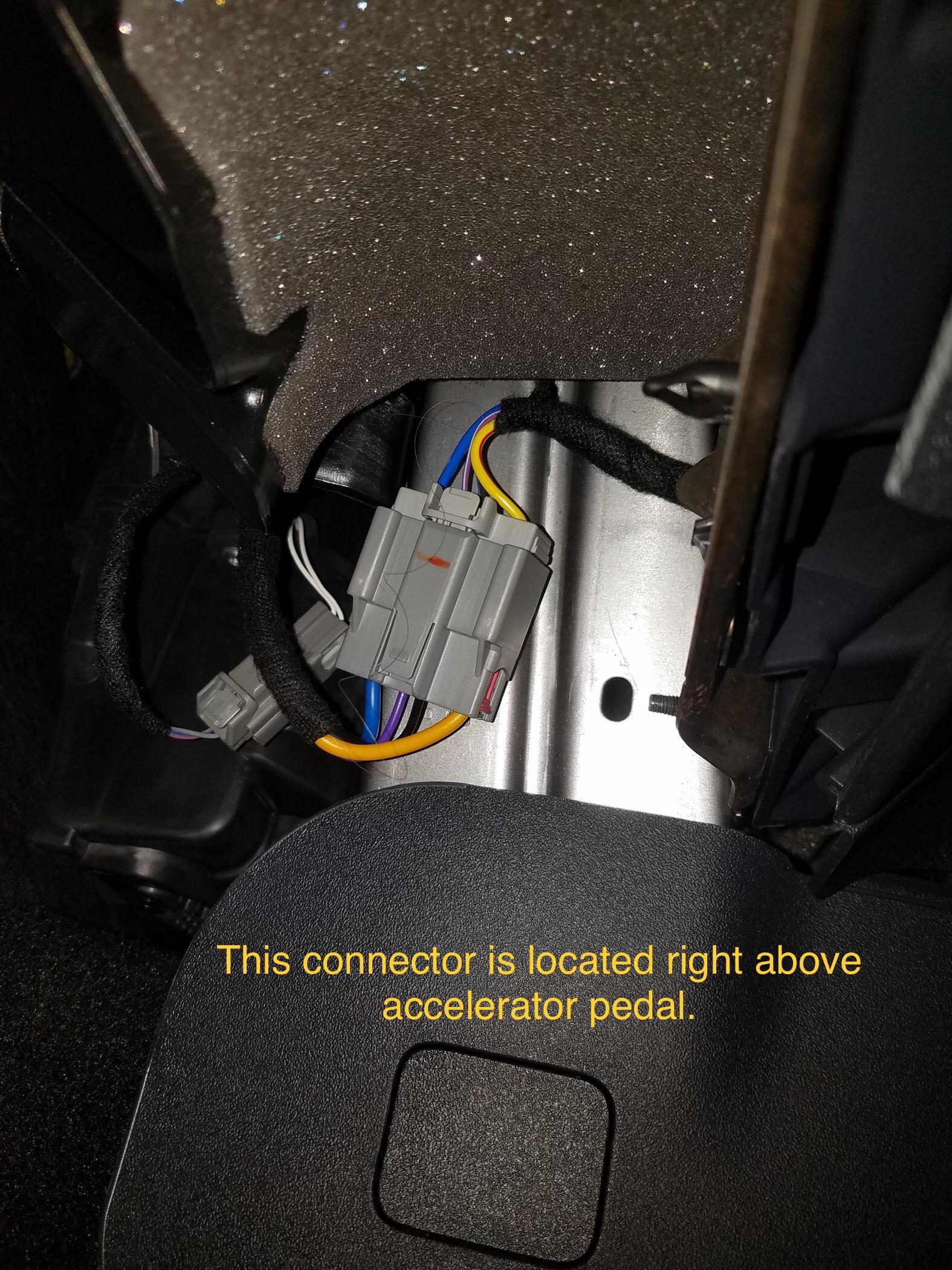

Just thought others may like to know that there is an option when installing the controller. My grandsons are like monkeys and have been known to climb over the console which I feel would inevitably render the control knob destroyed if placed per instructions. There is plenty of room to place all components of the kit on the driver's side by popping the hinged lower dash panel. It is how you access the fuses as well. Used the conical step drill to make the hole on the headlight switch panel. Discarded the supplied bezel. The factory wiring harness for the controller is already located right above the accelerator pedal. Be careful popping it loose, lots of razor sharp objects under all vehicle instrument panels.!! Ouch.! Very quick install without removing console or glove box.! The module is stuck to the metal plate under steering column , using supplied sticky tape, with a couple zip ties for insurance (I did trim the tails off after the pic.!).Hooked to a trailer and the led lights up when applying the brakes. True plug and play for those of us with the factory tow option. If anyone else has posted using this location for the controller switch/knob my apologies, many searches did not find this method.

Very clean install. I just picked up the kit and am getting ready to install it, but was also trying to identify possible alternate locations to the center console. I also am not a fan of that spot. I saw the location you utilized and was wondering if I could install rhe knob there without the supplied "trailer brake" plate. I also don't like the fact that the plate requires a 1in hole!! to be drilled. This method allows for a much smaller hole AND the mounting location for the module is easily accessible without having to take anything apart! Also looks like a cleaner install. The center console location def makes it obvious it wasn't a factory install, where this location allows the new knob to blend in with the others and give it a more factory look.
Good to know it's possible. I think you've convinced me to go with this location. Well done and thanks for sharing.

Yes.! Throw the faceplate away.! We all know what it is and which way to turn the knob.!

Just completed the install today on mine for the Liberty Tow Pro Brake Controller in the same location. Not sure if they changed the switch or not on the Tow Pro Elite, but mine uses an ethernet cord between the dial controller and the module. I had to slighty modify the vertical dash support as it hits the back of the switch where the wire comes out. Had to slightly modify the support where the blue arrow is to allow room:

I popped the cover down last week to wire in a USB and saw where I nibbled away the same piece. I thought to myself that I should have included that little tidbit of info. You did good.! Thanks for sharing.

Yep, just a nibble. Final Product below. Looks like the Liberty Tow Pro version has a metal nut. So much better than the console location.
