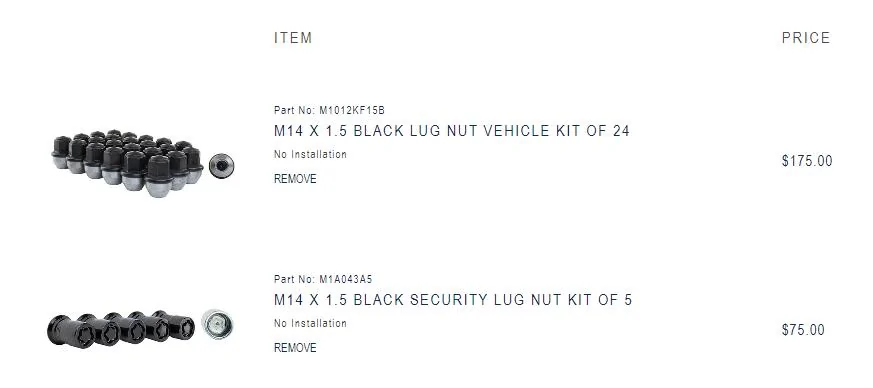

It appears McGards are pretty proud of their lug nuts but I assume at that price, they are quality and don't nick/peel easily?
lastly, what about just the Ford locking lugs? Crap or ok to purchase?
Ford Bronco Ford Braptor black lug nuts - better / worse than other options? 1730985752654-50

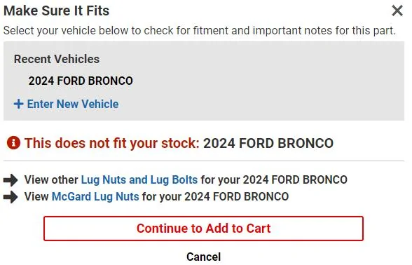

Edit: So, when I enter the 64034 part # on Summit, I get this message:
Ford Bronco Ford Braptor black lug nuts - better / worse than other options? 1730986236511-m8
Summit is saying I need part# 64074 for the Raptor?

The specs for each 64034 & 64074 appear to be the same to me —> 14x1.5 RH conical bulge in steel black chrome.
Looks like the only technical difference is the 64034 are are slightly longer at 1.95” and the 64074 are 1.64” long.
and, don’t forget our wheels are 6 lug each plus 3 for the spare so you need to order 7 packs of 4 🤪

Thanks for clarifying. Last question, I think lol. Do you know anything about the Ford locking lug nuts? In the picture, it's hard to see if they are two part or will have issues as you've mentioned with the regular lug nuts.
I don't - the McGard ones are 1 piece and I opted out. If someone wants to take my 90+ lb wheels and tires - that'll take time...I'll know, and that'll become a big problem for them.
