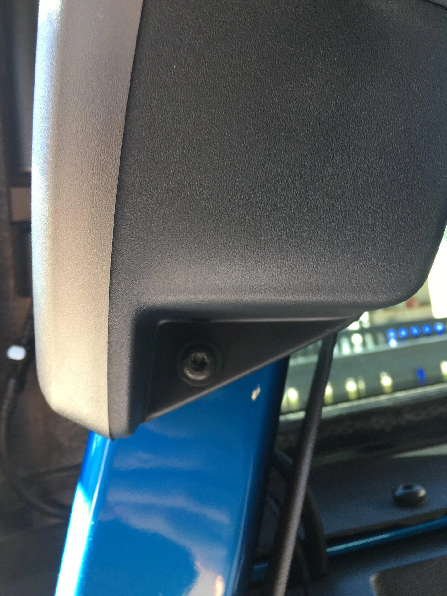

So this is the only points where the Bimini is fixed so to frame. Part of the install is to attach a strap to the lower mounting bolt of the rear speaker ( shown ).

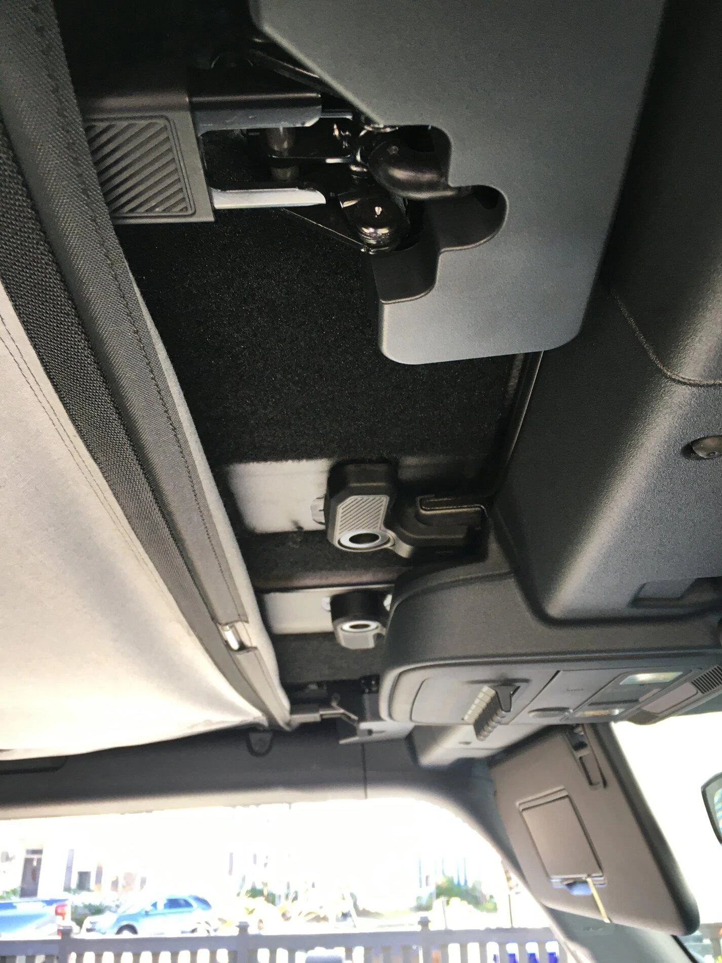

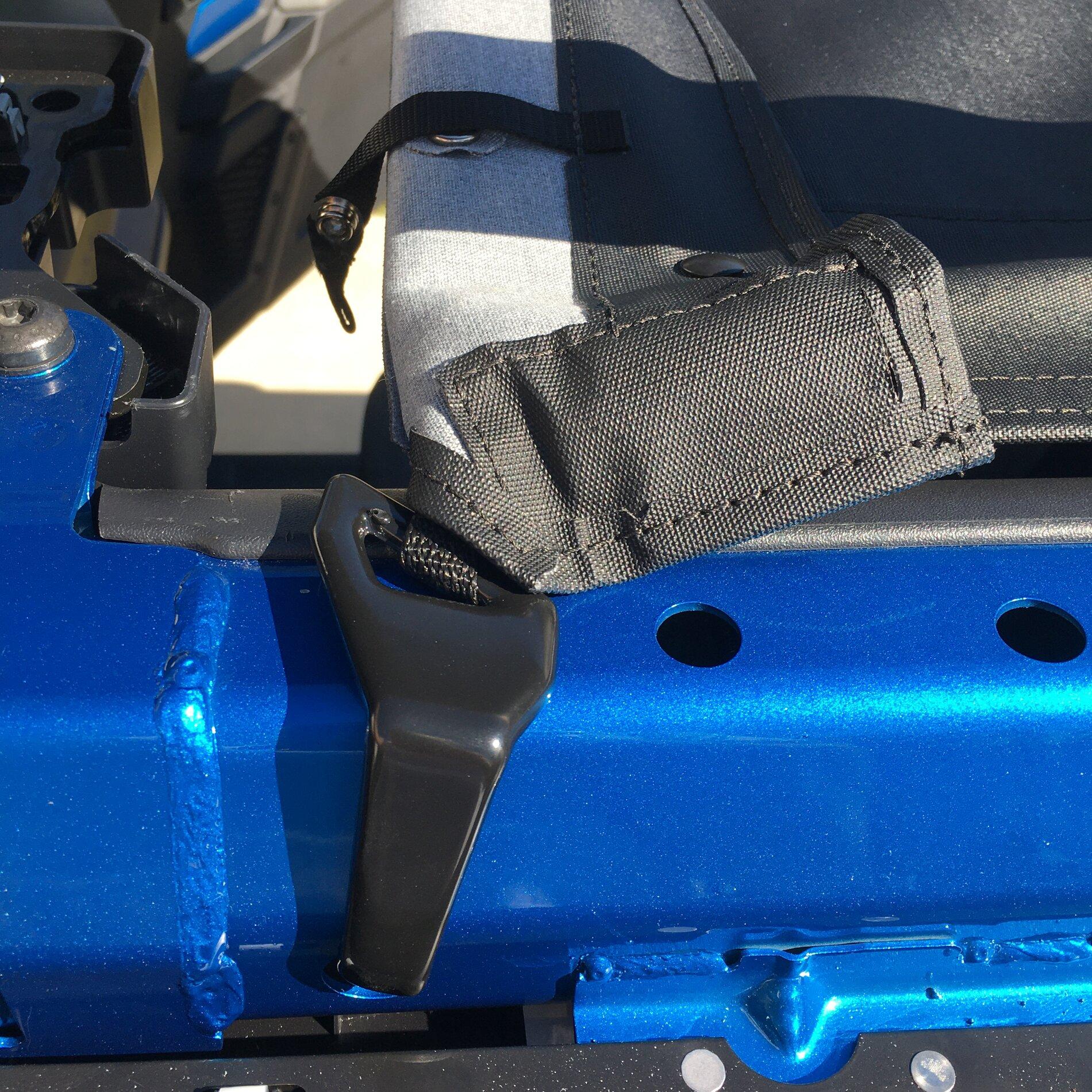

Front clip - Snap clip hanging goes into front panel mount.
Bimini postion is rolled back to allow access for Front MIC panel latching

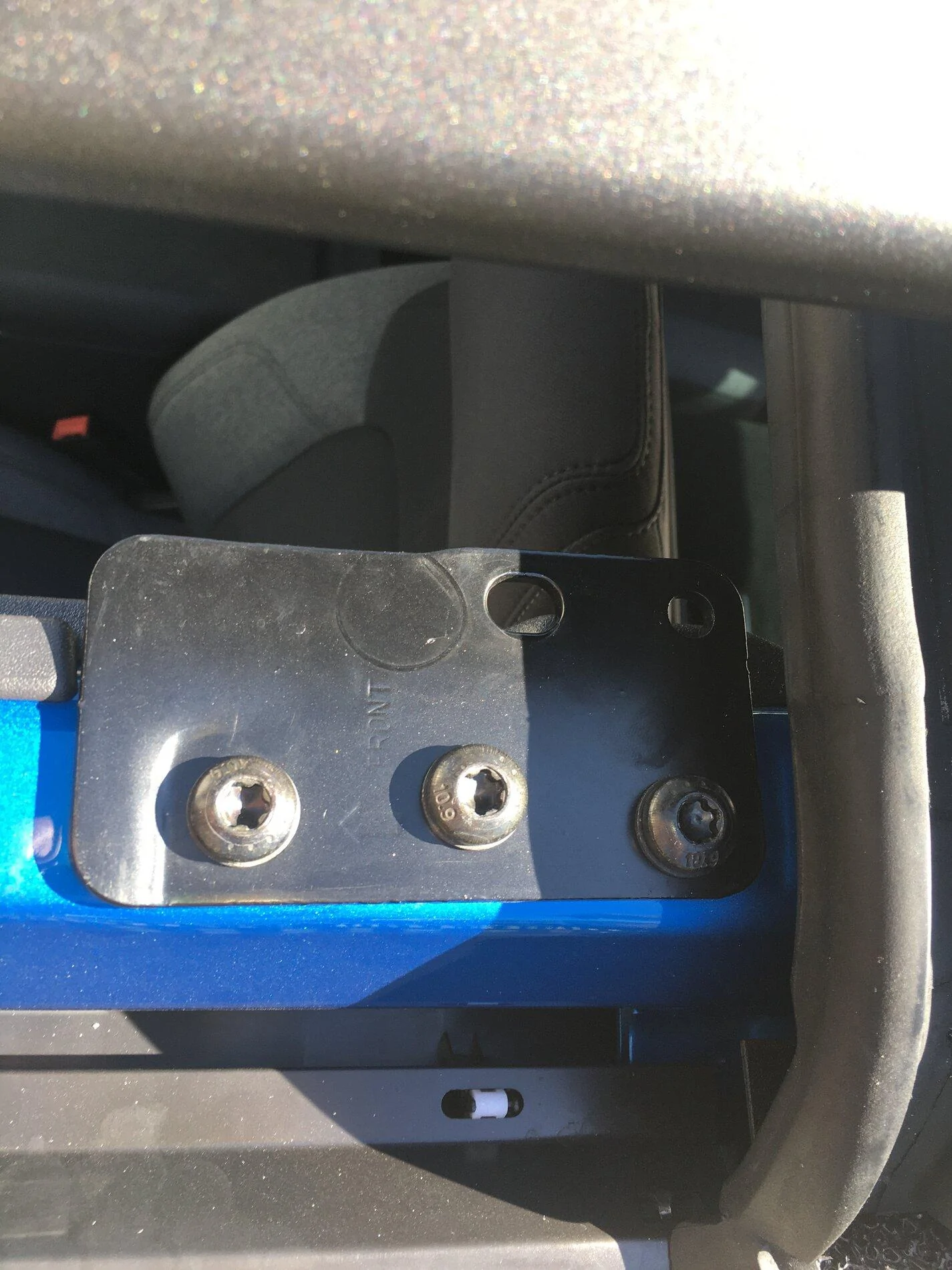

Top view of mounting point of Mid Bar bracket before and after install. This is where the back of the front panel latches. Gasket shown is the leading edge of the back shell
