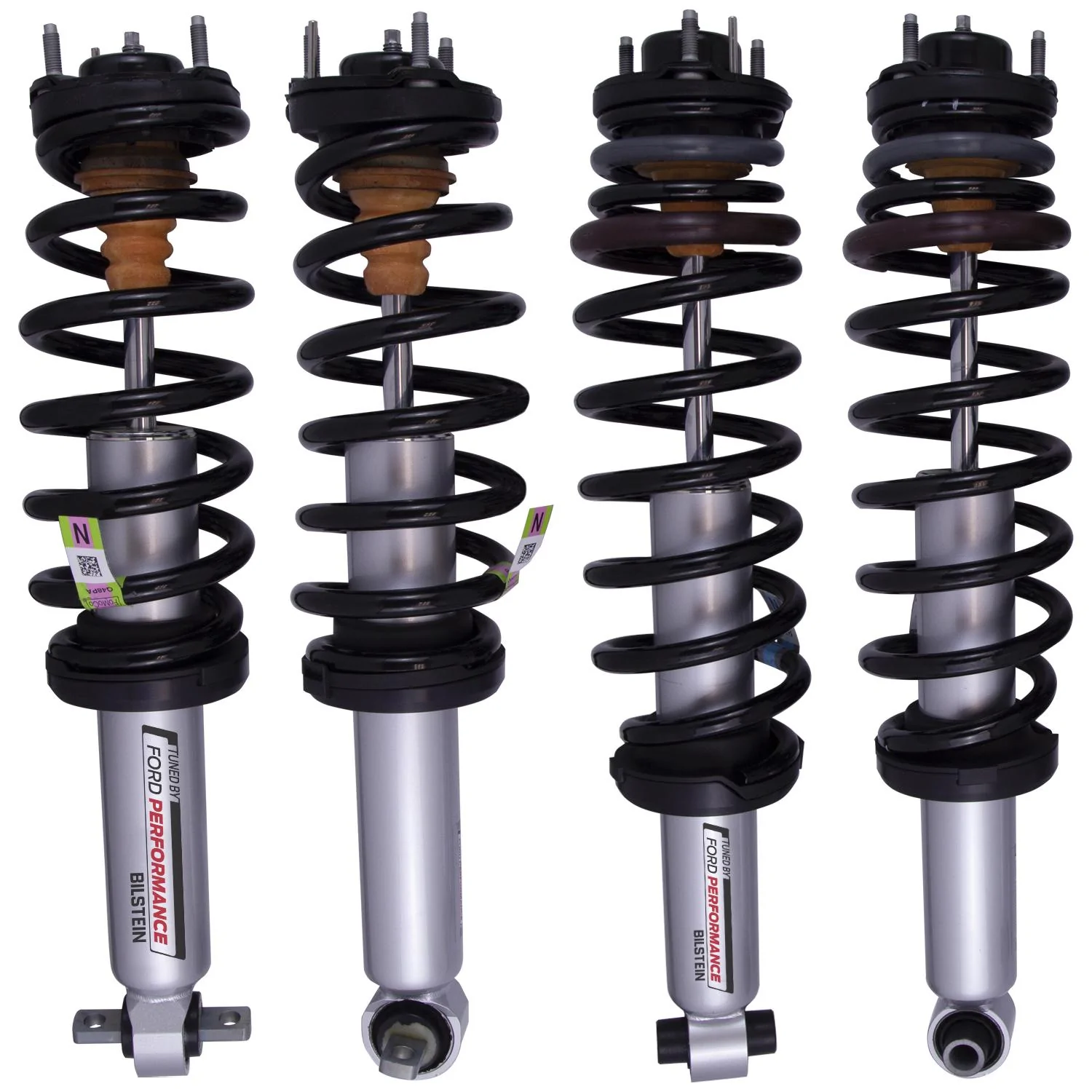

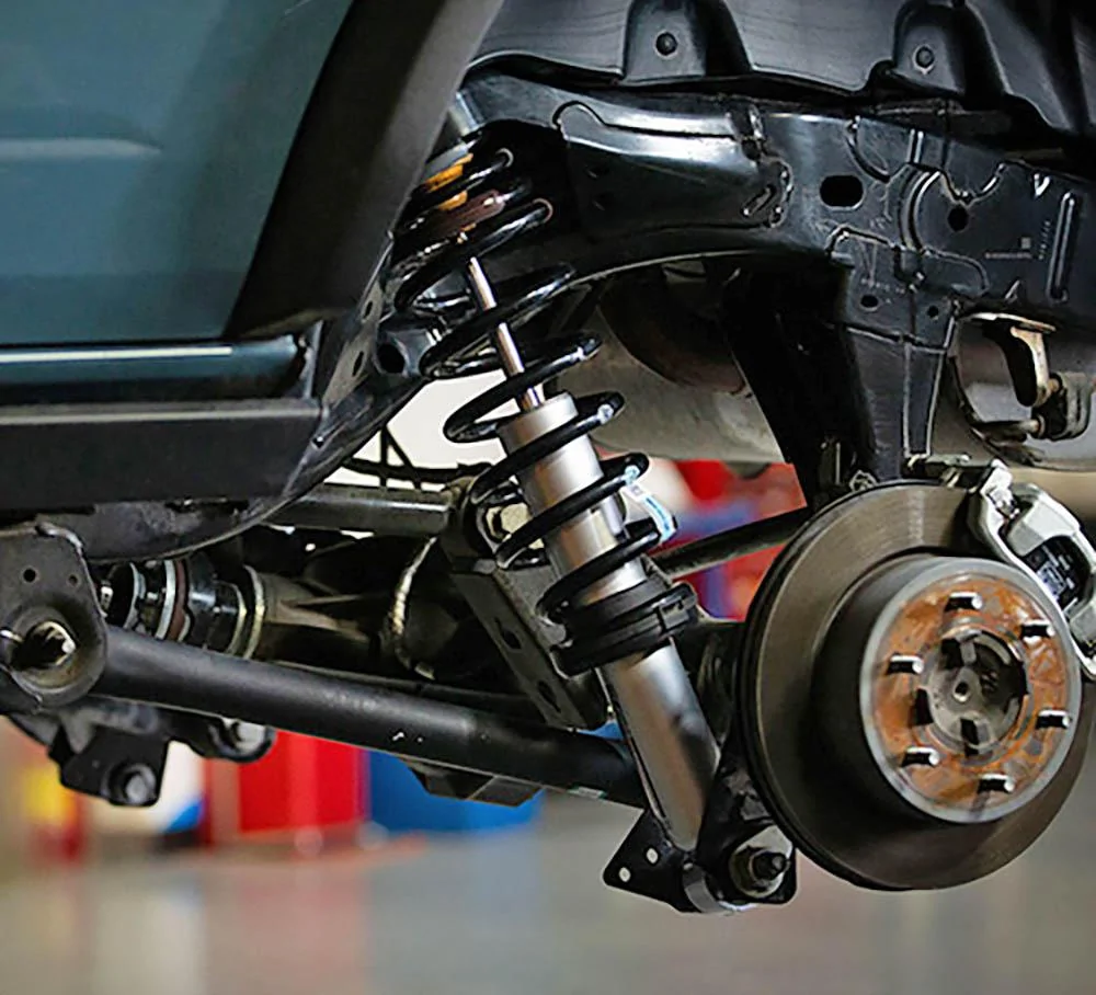

Includes bolt-in front and rear coil-over packages with Bilstein and Ford OE components, such as front and rear 60-millimeter pistons in a 2.65-inch mono-tube Ford Performance shock package, in addition to the top mount front and rear spring from the Sasquatch Package. Kits contain the largest shock diameter of any production Bronco, Raptor excluded. Comes with Ford Peformance three year/36,000-mile warranty when installed by a Ford dealer or ASE/Red Seal certified technician.

FYI all these are 6112 6100 Bilsteins with SAS springs and Ford Performance Bronco tax-Edited
In case anyone was wondering:
  • Does not fit Sasquatch Package, Badlands, Everglades, and Raptor
Has to fit SAS, otherwise they wouldn't fit Non-SAS.

FYI all these are 6100 Bilsteins with Ford Performance Bronco tax
From what I understand the 6100 Bilsteins don't fit non-Sasquatch builds as the diameter of the shock body doesn't fit the springs.
So either the Ford Performance option has a different diameter of the 6100 shock body allowing the reuse of the spring or it is a rebranded 6100 shock body and includes new springs. If the latter, then it should fit Sasquatch builds.
EDIT: So I just went back to the old thread where the announcement was made that the kit would be available (but of course was delayed for 11 months), and in the announcement it mentions that the kit comes with new springs.
Additionally, the kit comes with front and rear coilover springs that are identical, direct bolt-in, one-for-one replacements with those included in the Sasquatch Package.
So with that in mind, it looks like the shock body is exactly the 6100 (just rebranded). Of course, these will be tuned specifically for the Bronco and includes the 3yr/36K warranty.
With the inclusion of the Sasquatch spring to accommodate the larger shock body, I don't know why it wouldn't fit Sasquatch builds. I'm sure it was discussed in the 16 pages of the prior announcement thread. I'll have to reread through the thread.
