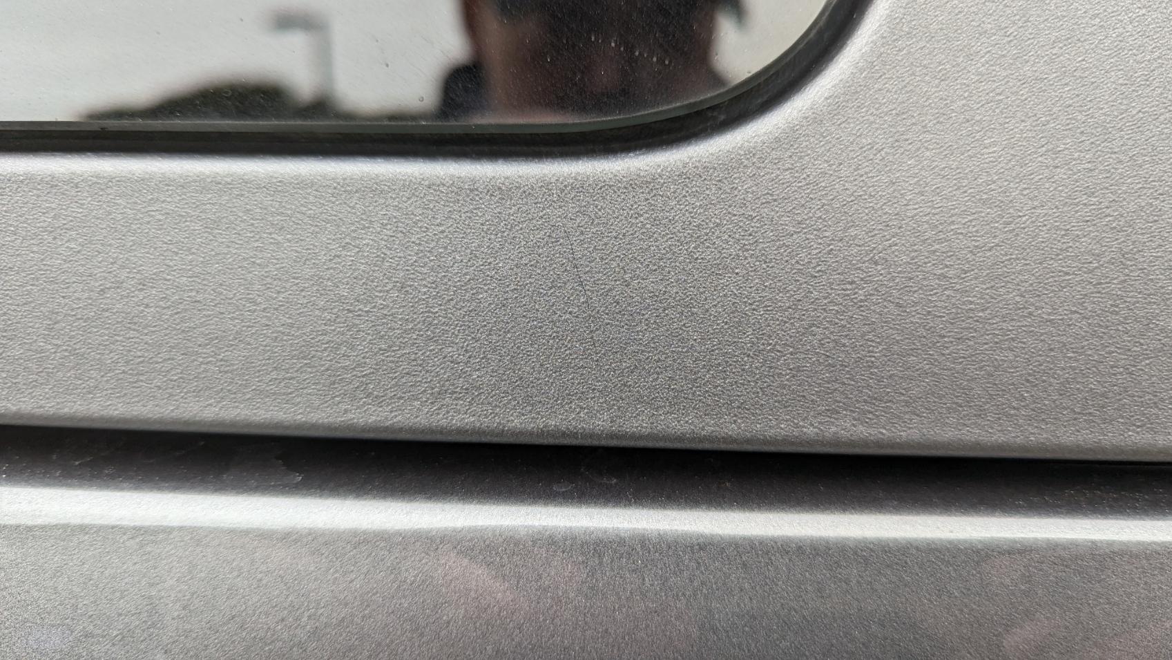

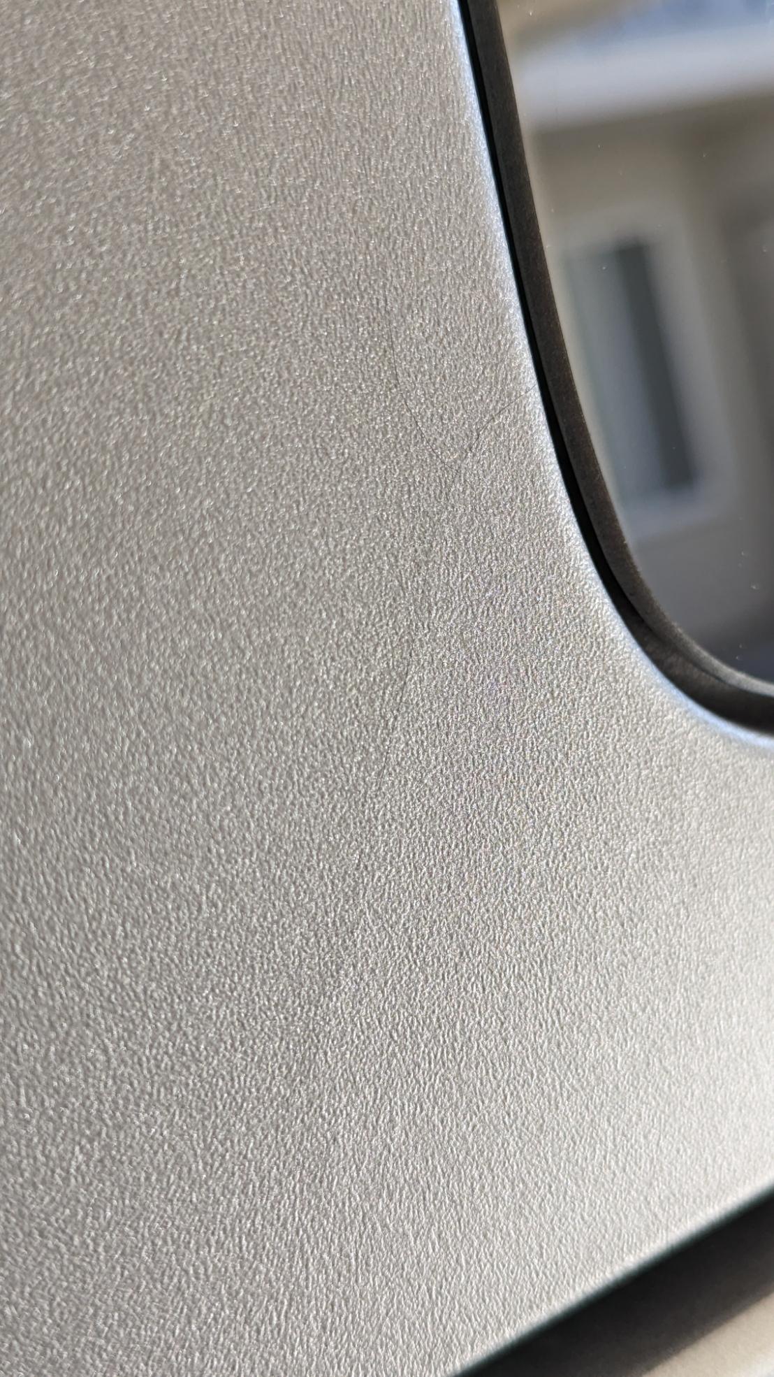

In addition to the paint flaws, I wanted the dealer to address the cracks in the MIC hardtop while they have the truck. And here's the reply I received:
Ford is stating these concerns with hardtop at the time are considered normal.. please monitor and reach back out if it worsens or more appear and I will reach back out to Ford with updated photos
Ford Bronco Ford Says These MIC Hardtop Cracks Are Considered Normal PXL_20230127_194355596

I'm going to be putting my rear clamshell MIC hardtop in for a warranty claim very soon. Will see what they say / argue. I have one small crack on the passenger side rear clamshell below the window. it's "opening up" more and more. And I'm sure it's certainly getting water/moisture in now. In fact, I did see a water droplet coming out of the crack shortly after one of my recent car washes.

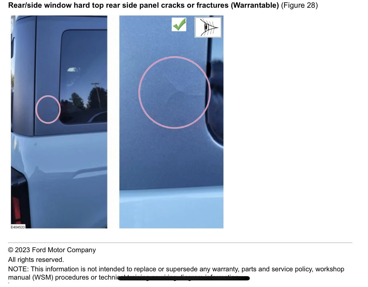

Looks to be around the windows in the rear clam shell. Based on link below it should in fact be covered under warranty.
https://www.bronco6g.com/forum/thre...ing-in-mic-2-0-roof.35198/page-5#post-1795216

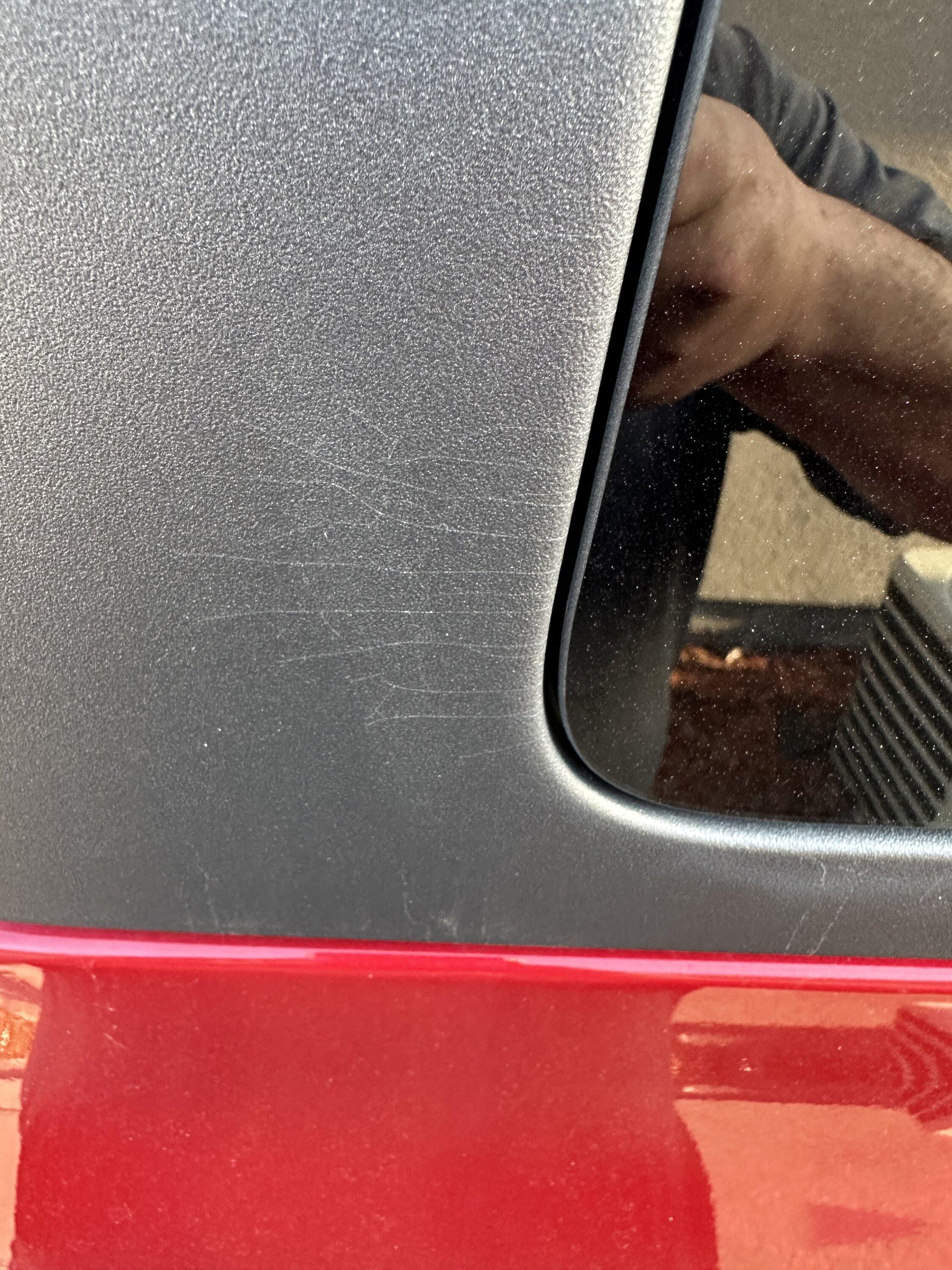

Shine the beam of a flashlight parallel to /along the surface. This will make even very minor and otherwise invisible cracks or imperfections appear obvious. Use that technique and try again. I guarantee there are more cracks.

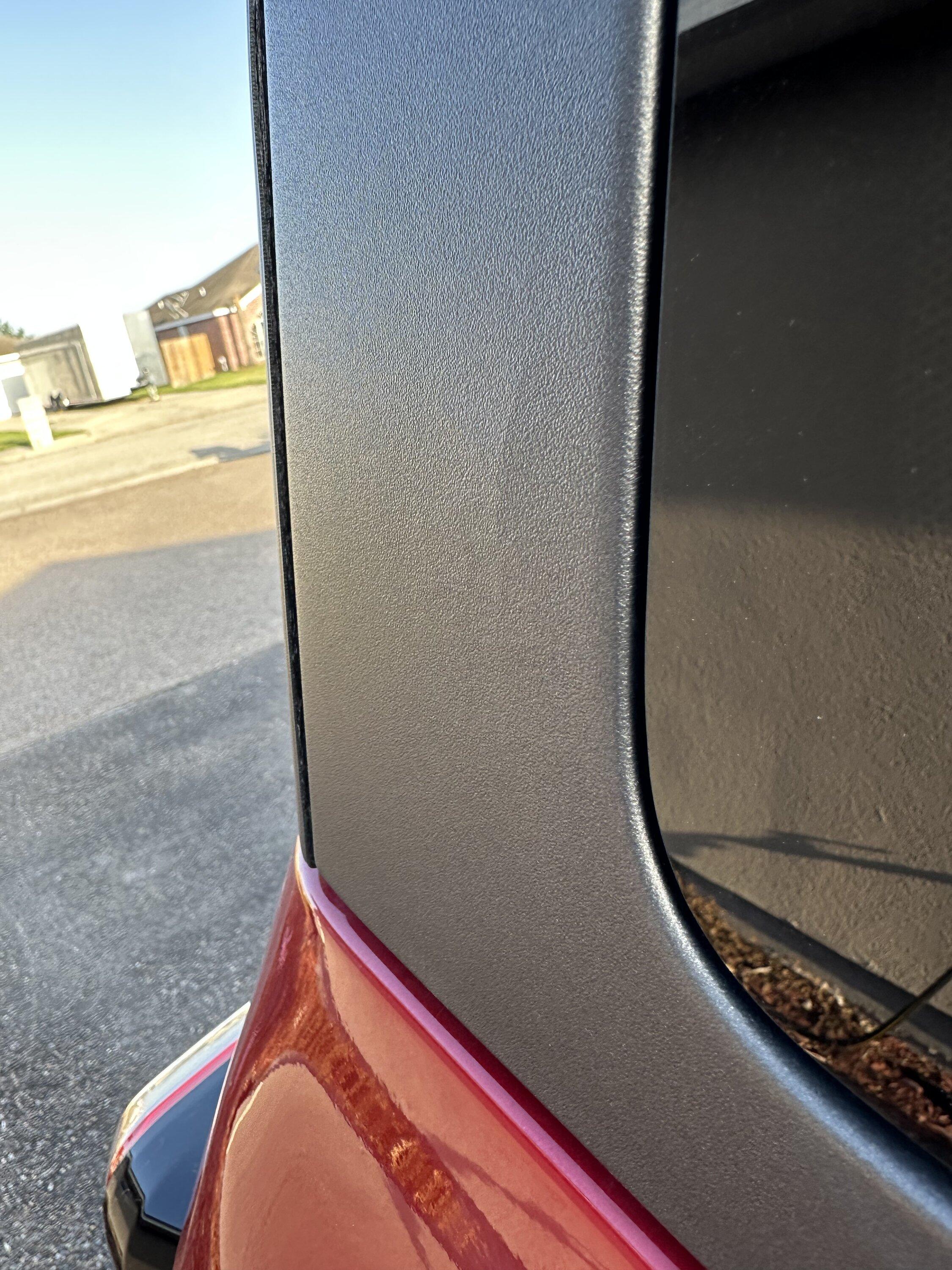

I tried twice and Ford denied to cover the cracking both times. Took it back last month after I saw reports on this site that Ford was now covering them. Dealer refused to submit a third time stating Ford has denied every hardtop claim they have submitted. I will have to travel to the next town over and try another dealer. Maybe it will be easier now with my latest crack that developed this week.
Ford Bronco Ford Says These MIC Hardtop Cracks Are Considered Normal 115B1180-8FEE-42A8-B1F4-13B8D7C813D9

I would have the dealer submit both of these pics. The first captures the horizontal vein cracking, but misses the very obvious vertical crack that is raised and seems to be delaminating. The second pic doesn’t capture the vein cracking but kinda capture the raised vertical area. Both of these are obvious and can’t be missed in person from any angle.
