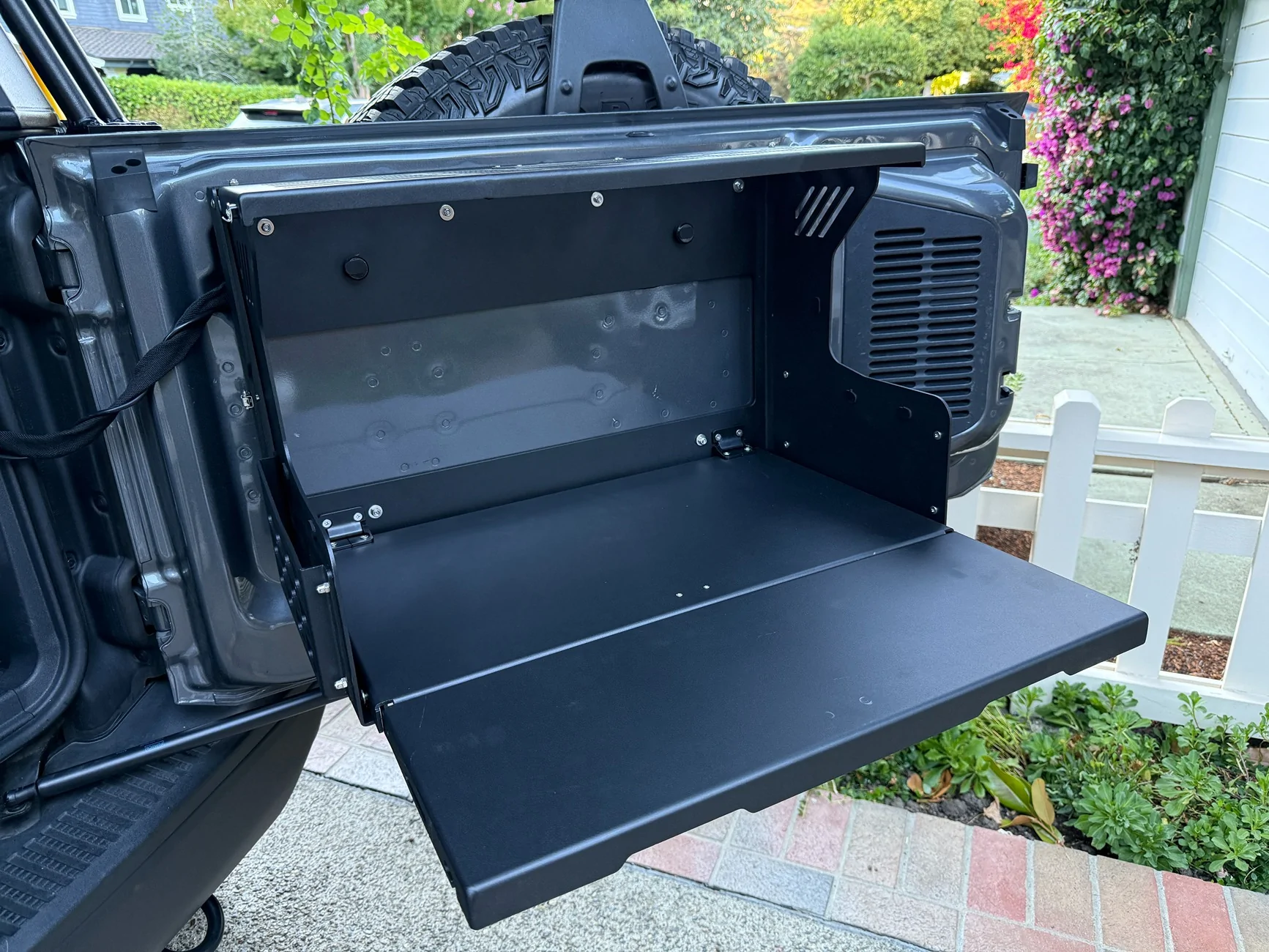

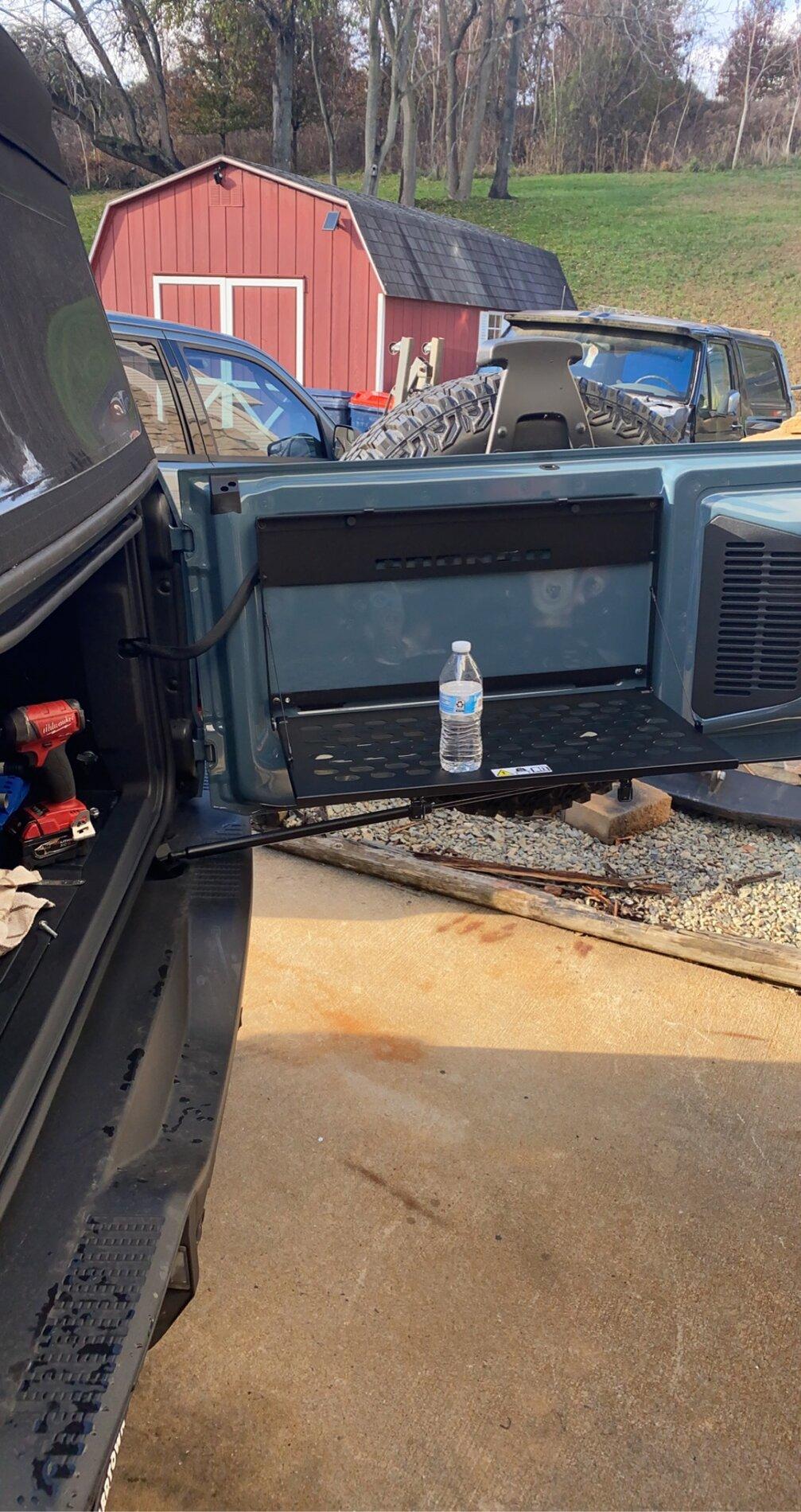

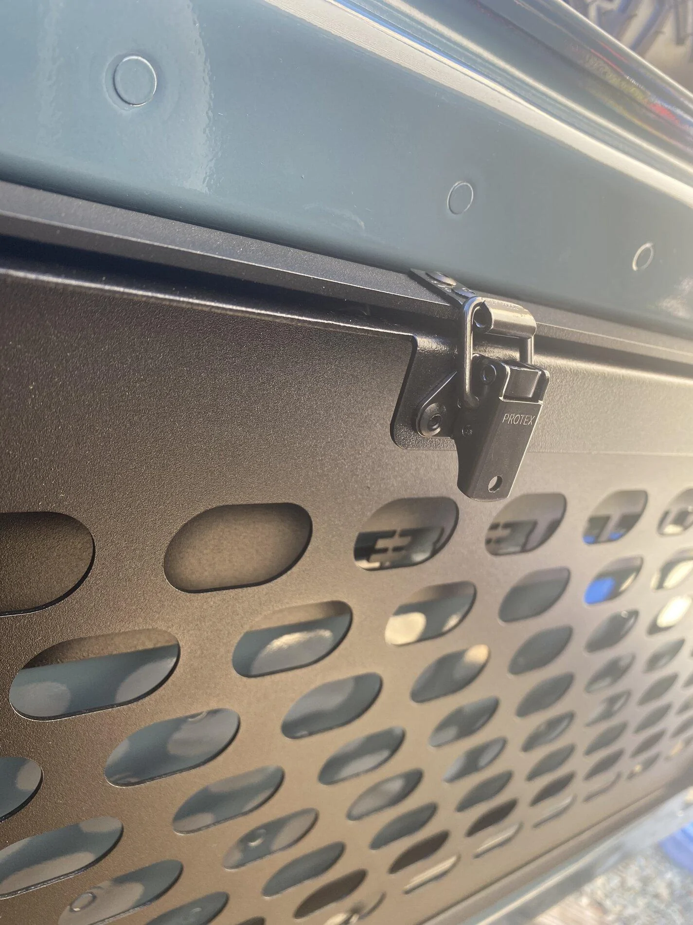

Anyone else install the deluxe raised lid enclosure and tailgate table together yet? I didn’t see anything saying they won’t work together. The Ford accessories fit and finish overall has been subpar so this wasn’t surprising but the latches at the top of the table hit the back of the enclosure lid when closing the tailgate. Looks like I’ll bend up the lip of the back of the enclosure slightly to make room, but that’s also with the rubber edge removed so be careful not to catch the edge.

I just found that thread, saw nothing when I searched earlier. But mine is closer, it’s metal on metal contact even if you remove all of the rubber. That’s why I’m thinking I’ll bend up the rear of the cargo enclosure lid just very slightly.

Came up with a simple fix. Smashed down the hooks for the clamps with vice grips. Also bent the rear of the cargo enclosure up very slightly. Now they don’t touch even with the weatherstripping fully back in place.

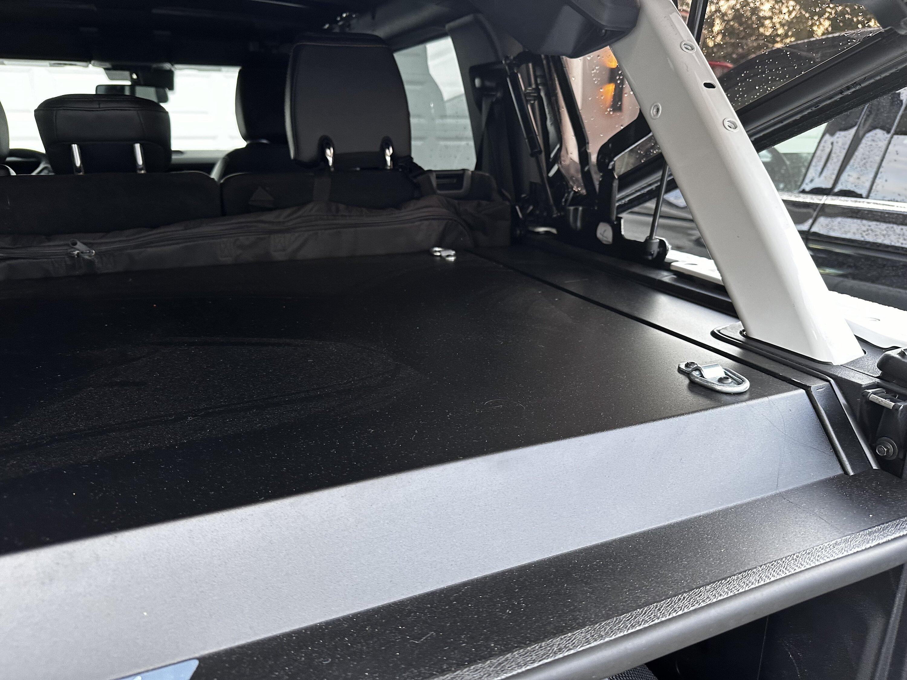

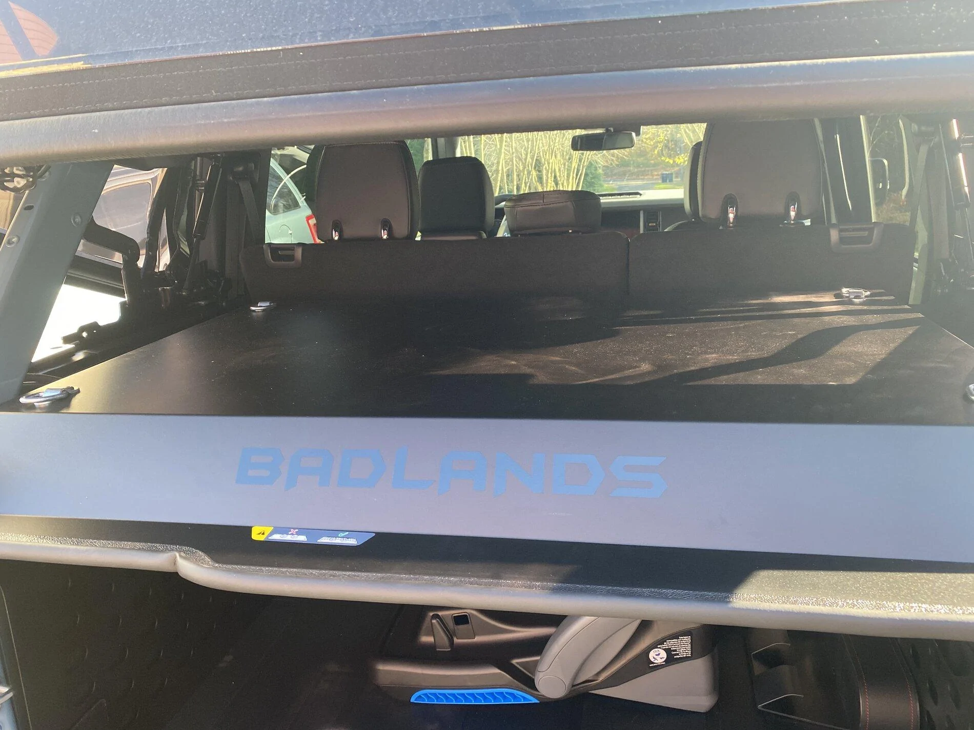

SO….the Ford Cargo enclosure…….how secure will it be when the top is off and doors locked? Is it made of something that cannot be cut through? Need SOMETHING to secure gear and the more space, the better. (I’m in a 2-door). THANKS all!

It’s secure, can’t get in with the tailgate locked. It’s made out of metal, but sure you can cut though it. Very unlikely unless you live somewhere that they cut out catalytic converters and stuff.

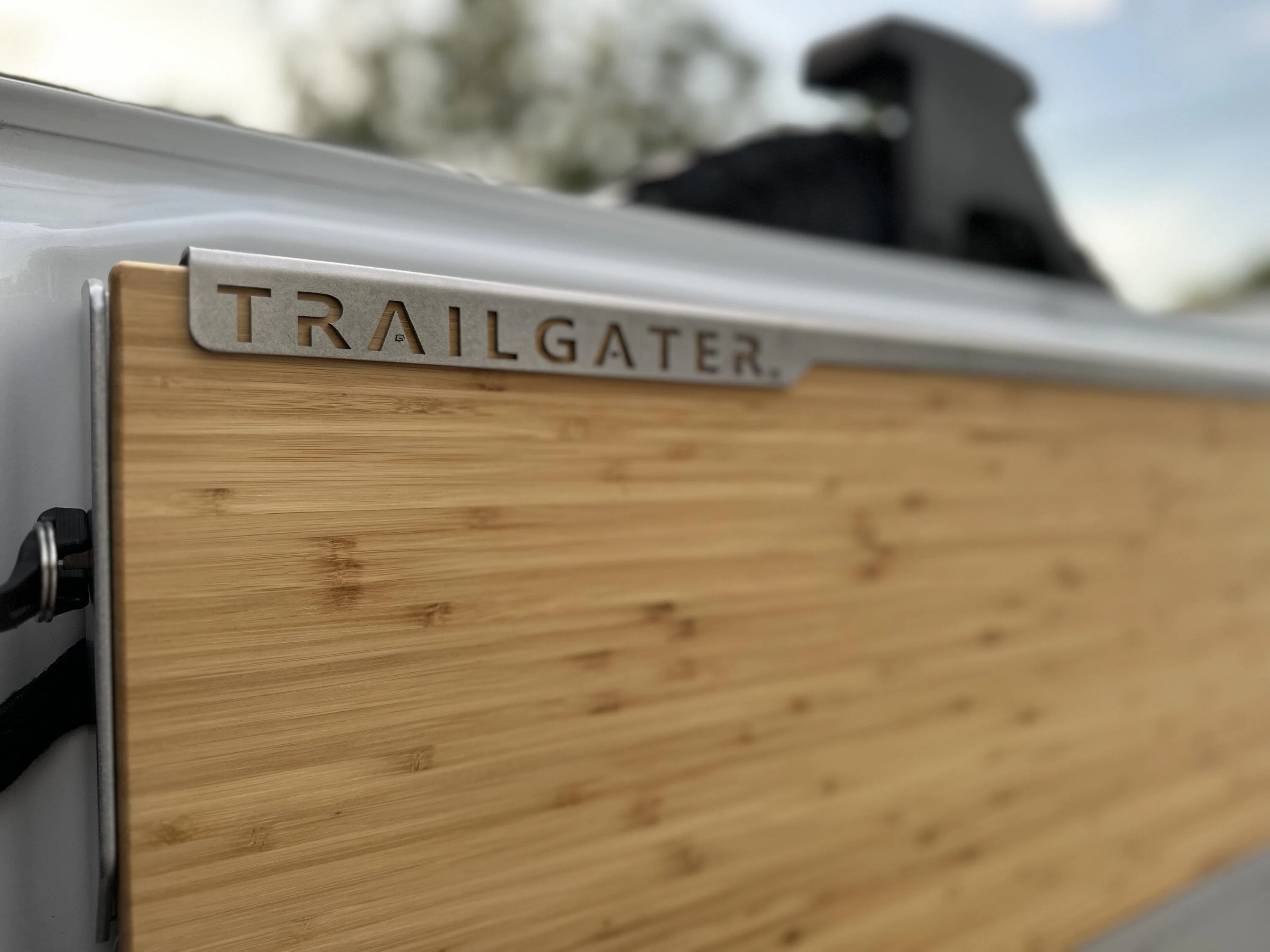

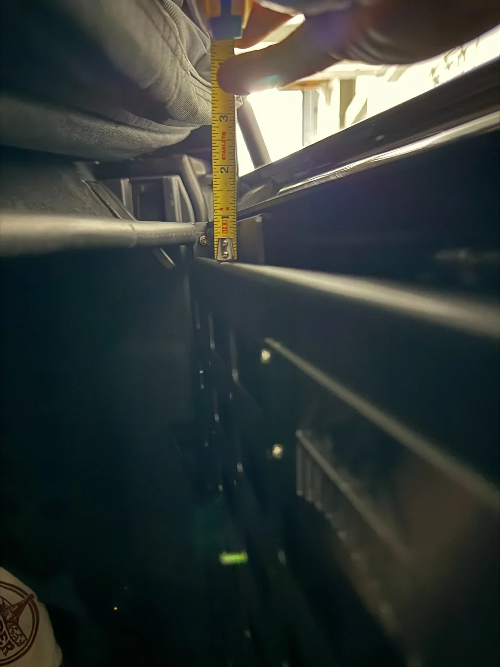

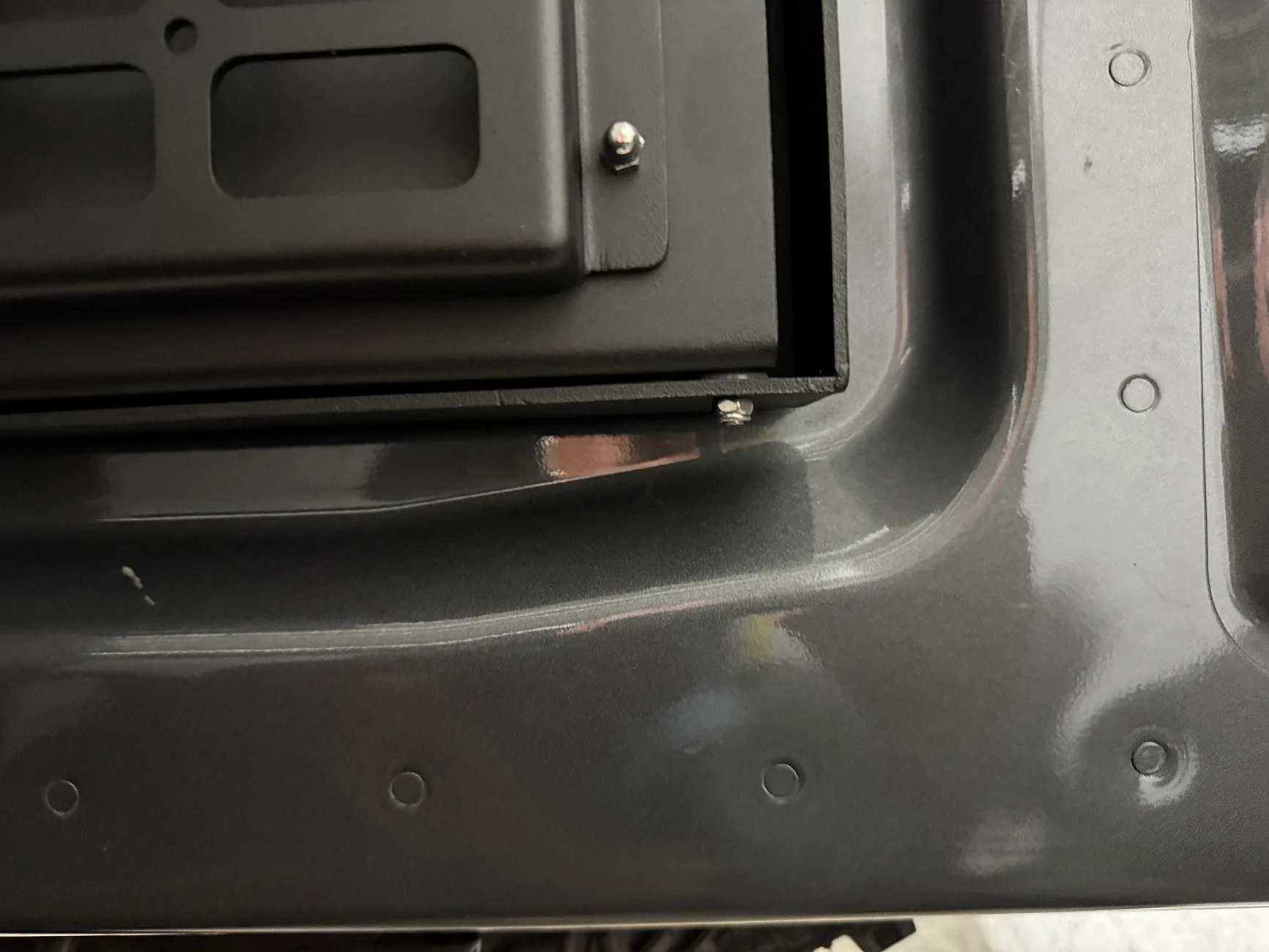

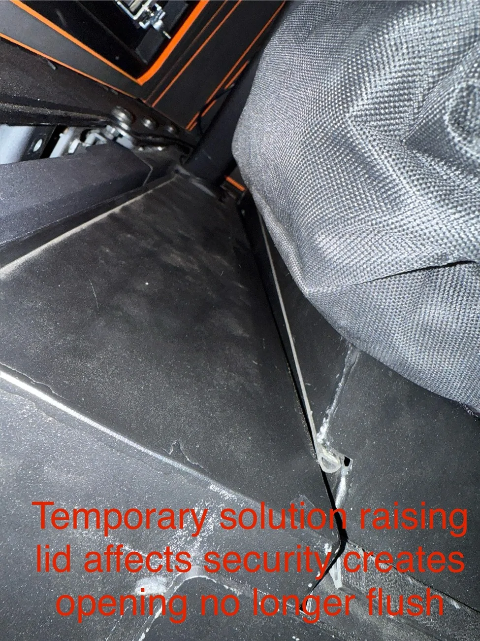

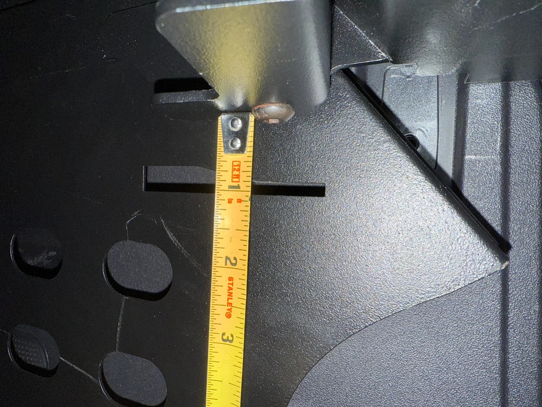

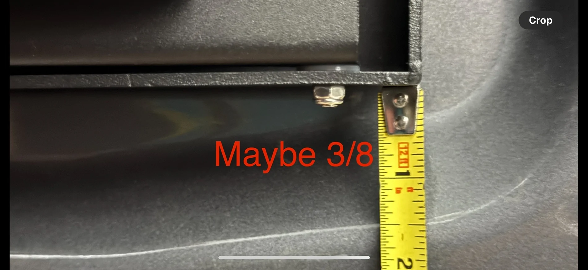

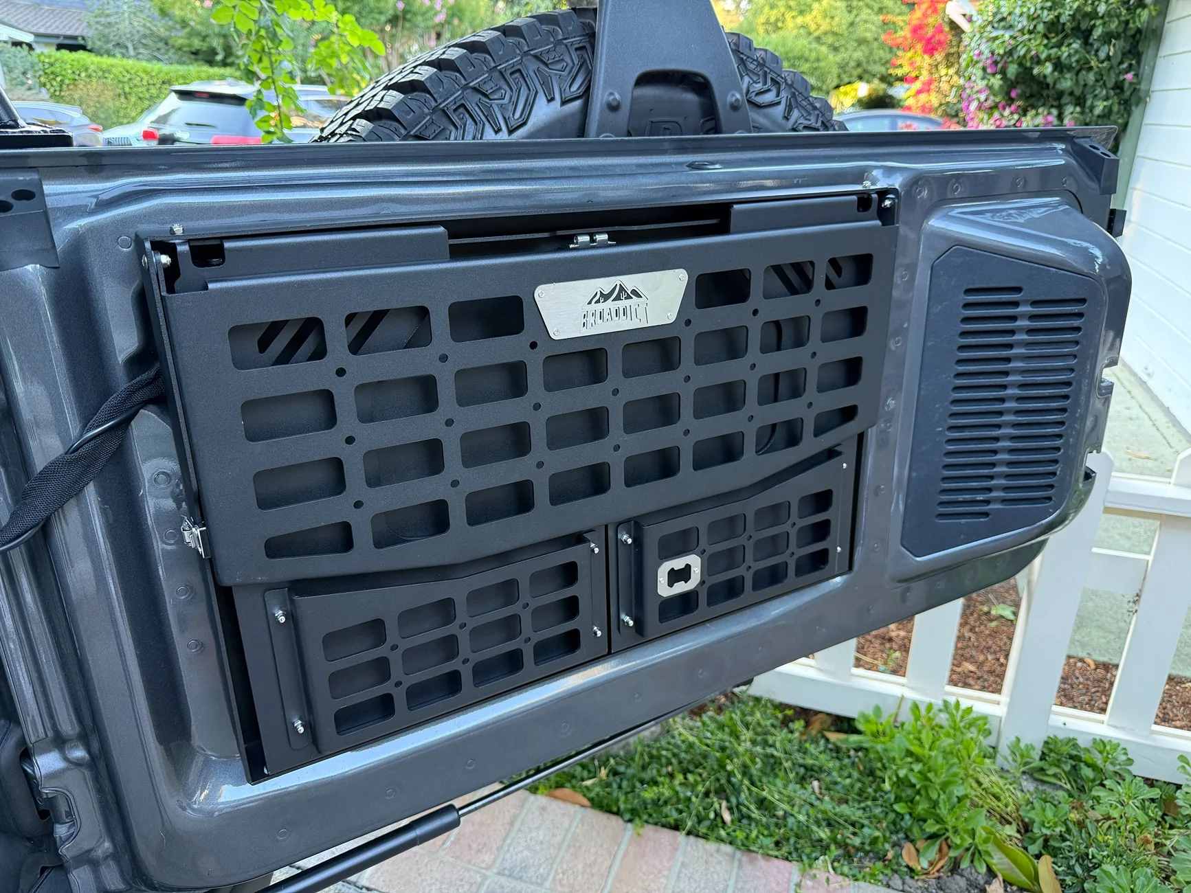

Man, sorry to resurrect such an old thread, but do you mind me asking if anyone else has run into this issue and
Ford Bronco Ford tailgate table interferes with cargo area enclosure IMG_9958
Ford Bronco Ford tailgate table interferes with cargo area enclosure IMG_9966
Ford Bronco Ford tailgate table interferes with cargo area enclosure IMG_9964
if bending the cargo lid is the only fix?

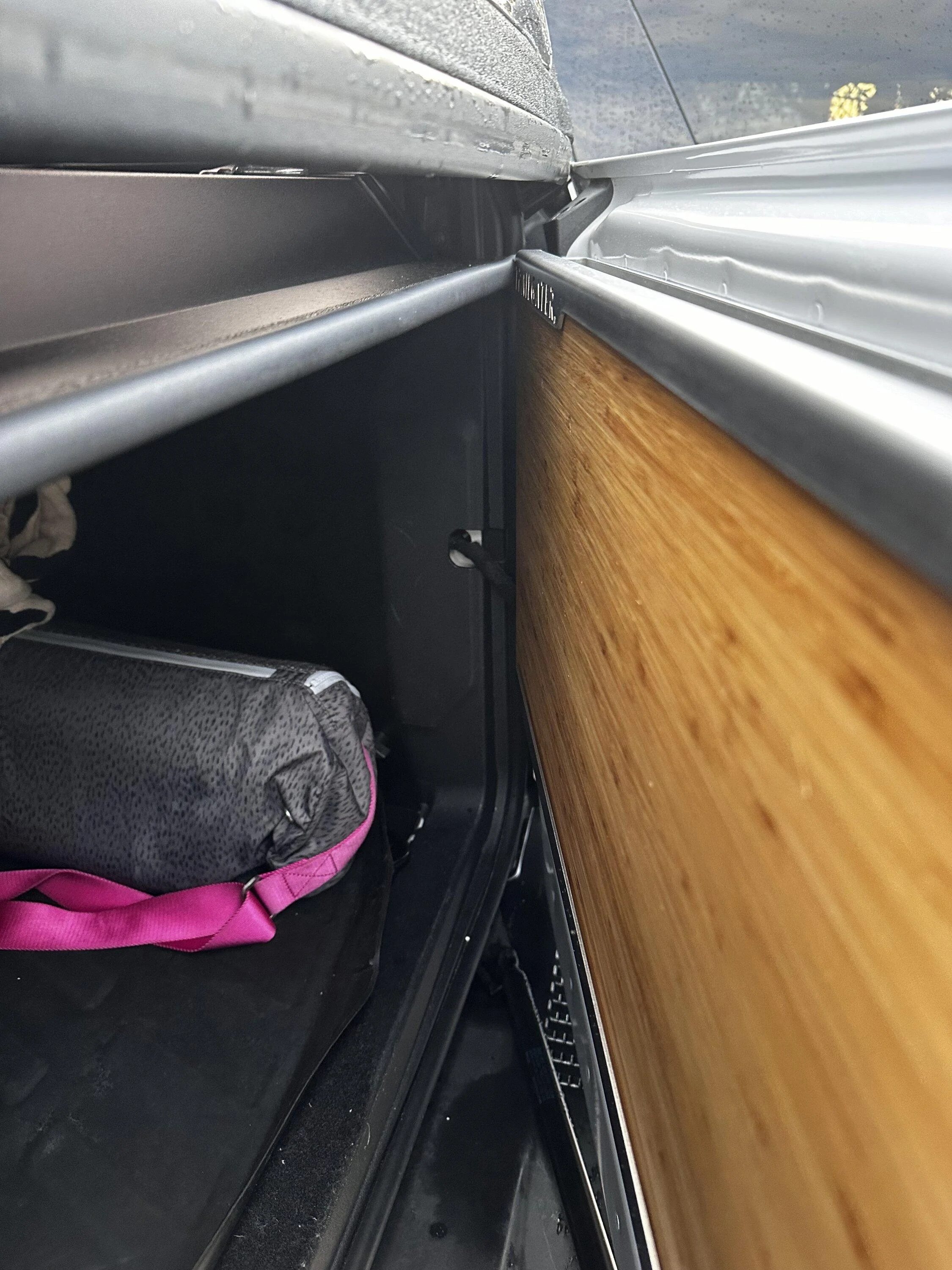

I have a similar issue, but it’s the fixed cargo area, 21 bronco and the Trailgator interfering w each other in the same way.
How did you bend the lid and how much? It fits so perfectly. Ugh
