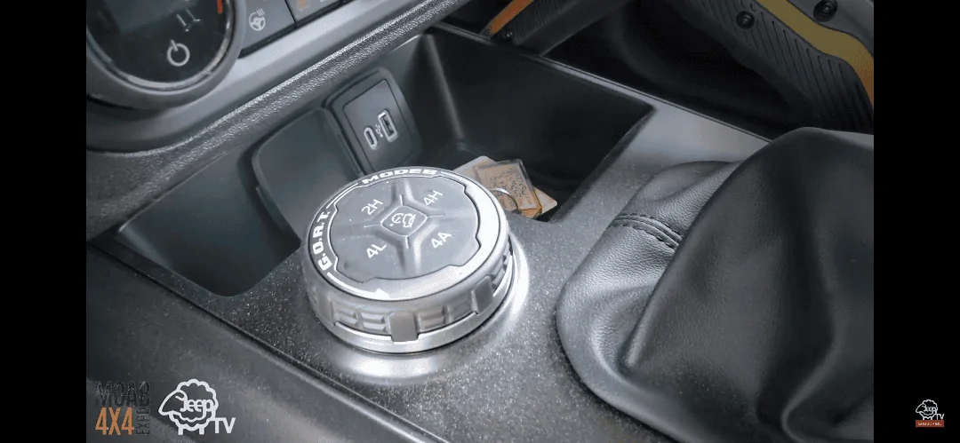

Where was that deduced? As for other locations for that switch it could be the center of the range selector, though I still think it is one of the Hero buttons.
The on/off for trail control is located at the center of the GOAT modes dial.

I should clarify in that the video demo had the 2.7L. BN had to correct some info on the video as they originally stated the TTA was linked to the 2.7, but the next day corrected the info that it was a function of the 10sp Auto. In the demo video, the Trail Control was on the center dial of the GOAT dial. On the 2.3L, the TC button is missing on the center dial.

The Trail Control button is in the center of the GOAT mode dial.
Push once for Trail Control (like cruise control but between 0.5mph and higher), and push twice for One Pedal mode (automatic brake engagement when gas pedal isn't pressed).
Trail Turn assist is the far right (left of hazards) of the HERO buttons.
Please don't use this on pavement, as it may damage your differentials/lockers.
Speeds for both are controlled by the up and down buttons on the left side of the steering wheel.
