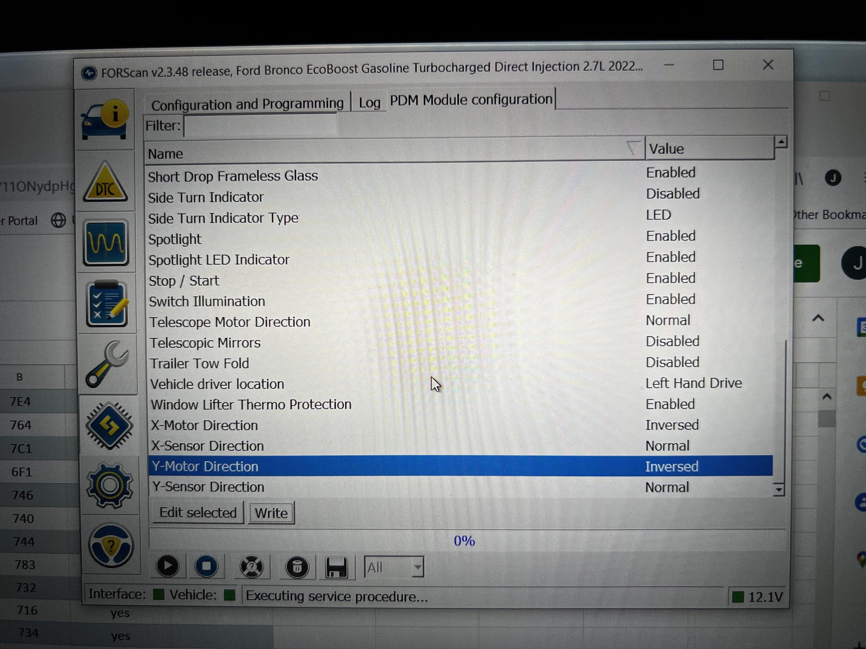

I've looked through all of the Forscan screens for a quick fix but can't find one. Does anyone know how to reprogram the mirror button so the mirrors go down when you press down and up when you press up? I want them to match the window buttons.
For those who said it couldn't be done... persistence pays off. The mirror can be programmed in the DDM and PDM modules. In my case I wanted my mirrors to work the same as the windows: push Up and the mirrors go up, Down and they go down (I just wanted that cluster of buttons to work the same way). In both of those modules, if you go down to "Y-Motor Direction" and change it from Normal to Inversed, the mirrors will flip Up and Down. You have to do both modules since DDM handles the drivers side and PDM handles the Passenger side
Ford Bronco FORScan Bronco Working Spreadsheet (double honk, sport mode, chimes, seatbelts, and more!) IMG_1183.JPG
Nice find, I stand corrected. I’m really surprised that it’s programmable.
This is awesome.
Now, if only there were a way to have them pan down when shifting into reverse...

This is awesome.
I will dig into that one. I agree that would be a nice feature.

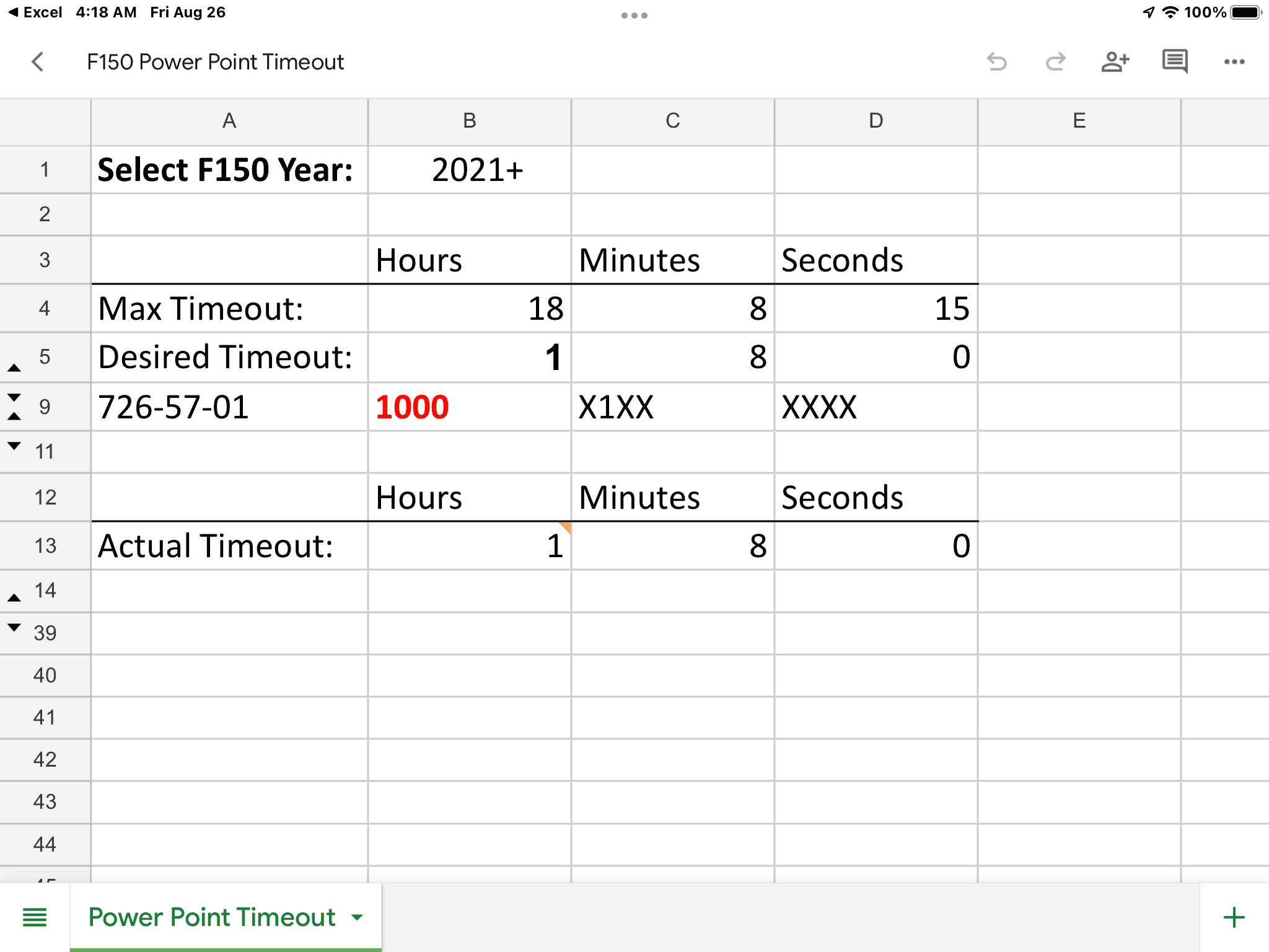

Has anyone used FORscan to make the power points hot all the time, or for long periods?
I went to the DeltaNu…power point timeout calculator link in the spreadsheet to calculate the hex code for the longest period available. The link didn’t have any way to input values, and didn’t give a way to determine the correct values..
This is what the link in the spreadsheet looks like
Ford Bronco FORScan Bronco Working Spreadsheet (double honk, sport mode, chimes, seatbelts, and more!) E9C76091-1852-4621-9523-0C370B254EA8
