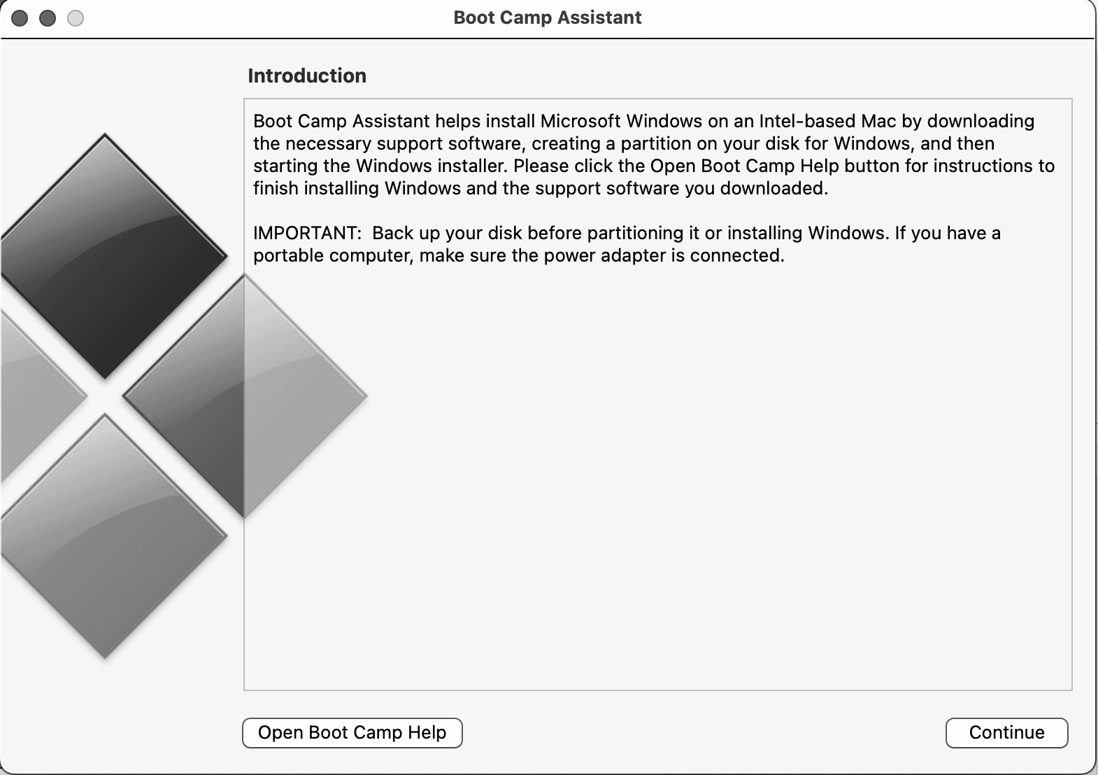

If you have an intel based mac, you could always use Boot Camp.
I run HP Tuners this way.
Ford Bronco Forscan for iOS 1665965272955
