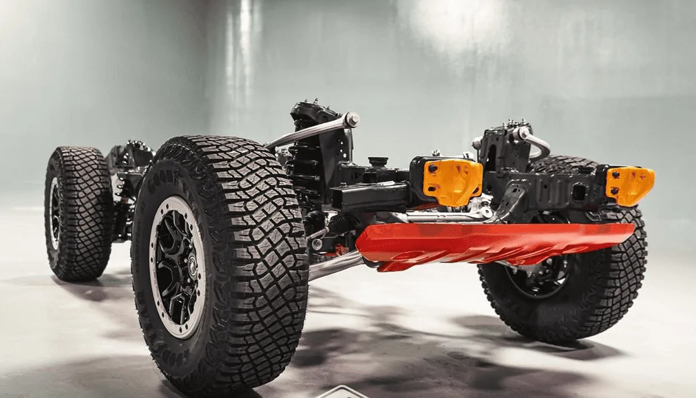

Like every truck Ford builds, there are 2 frame horns (in cyber orange below) and your bumper is bolted to that frame horn. Just loosen the bolts on the driver side and raise your bumper to the desired height and tightened the bolts.

Like every truck Ford builds, there are 2 frame horns (in cyber orange below) and your bumper is bolted to that frame horn. Just lossen the bolts on the driver side and raise your bumper to the desired height and tightened the bolts.
You're magical! I will gladly find someone to pay to do this for me!

It could be both body and bumper. I once had an explorer that the body was set on the frame crooked and one rear wheel stuck out 5/8" farther than the other side, it wasn't apparent until I put bigger tires on.
Bumper mounts are almost always slotted for some fine tuning.
