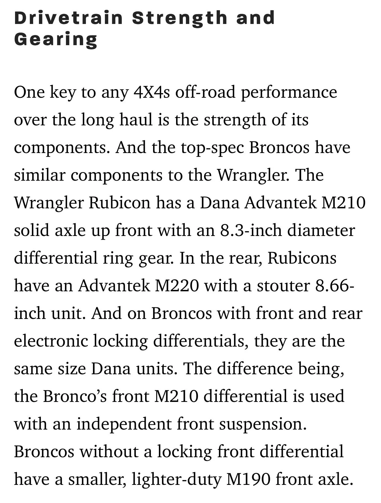

It appears to be the axle option for if you go with a front locker axle, which may be available separately from Squatch and is standard on higher trims. See below.
Ford Bronco Front Axle - M190 vs. M210 D1D68883-4DE0-44CB-B039-B1A3C38B6714

The way I read it, the M190 is used when the truck has an open front diff, and the M210 is for the locking version. So, open=190, locker=210. So, the locker gives a size upgrade. Which is nice, since they didn't have to. Colorado ZR2 has a locking front in the M190, so Ford could've gone that way. I'm curious how closely the M210 is related to the M220 (Dana 44) in the rear. Some info seems to point to it being more or less the same diff size, but adapted for IFS, so it has a different name. But it also could be a smaller diff - 10mm on the ring gear size is a lot...
