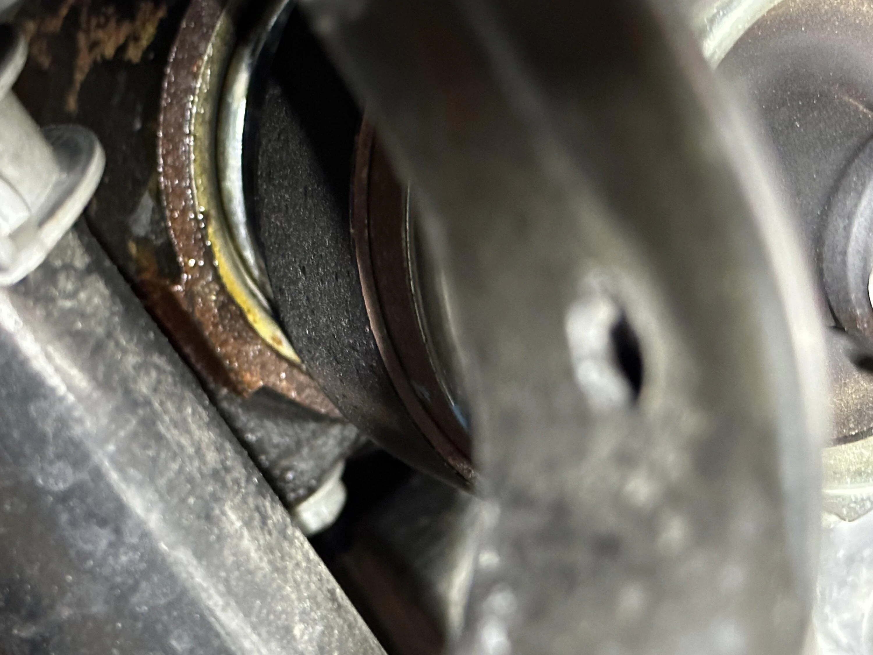

I am assuming I am having the same issue, just noticed it today. Time for a trip to the dealer.
Ford Bronco Front differential pinion seal leaking 20220807_093246
Hello, Michael! Send us a private message with your VIN and the name and location of your local Ford dealer. I’d be happy to see what I can do to assist with this leak concern. Thanks!

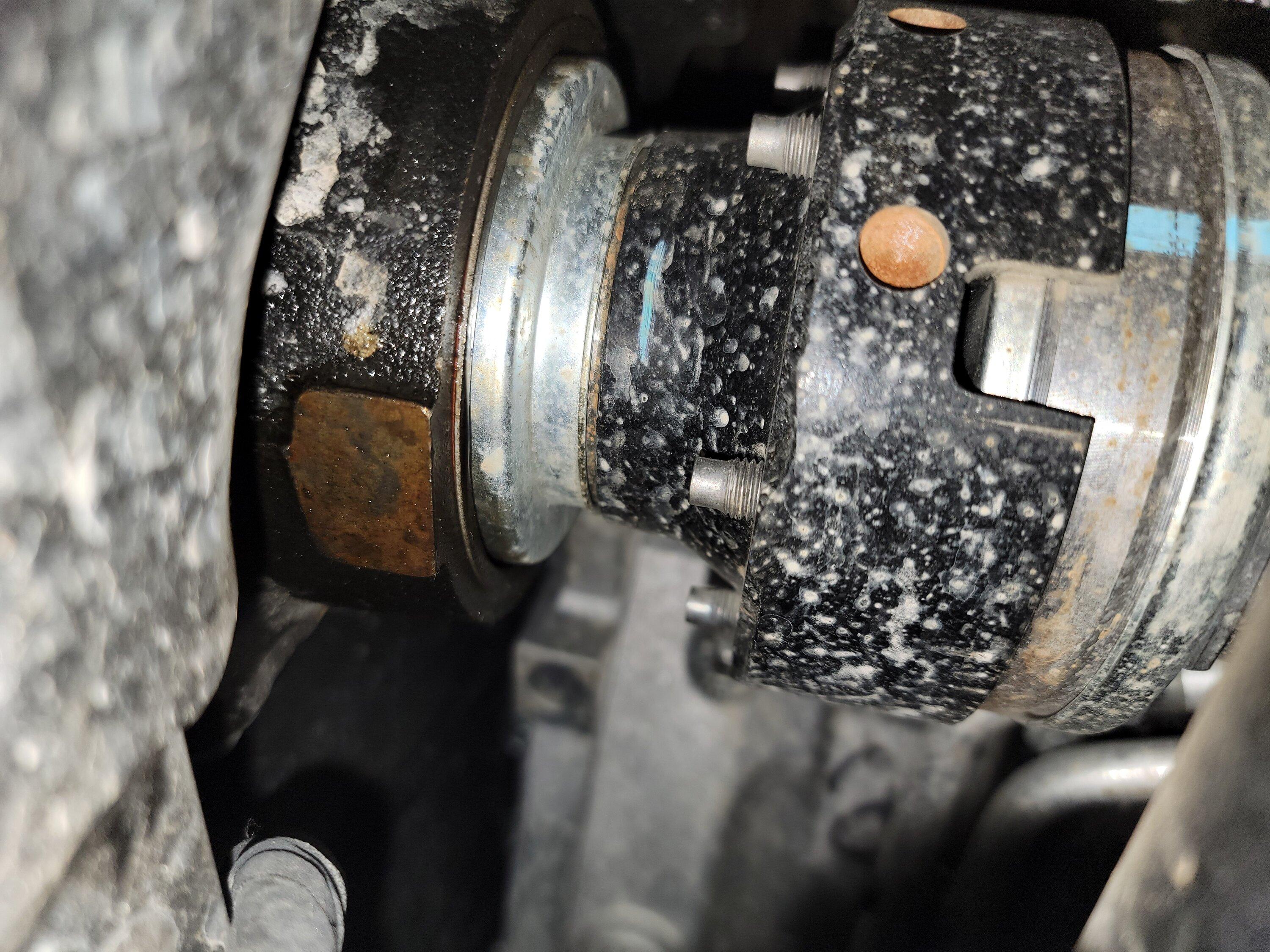

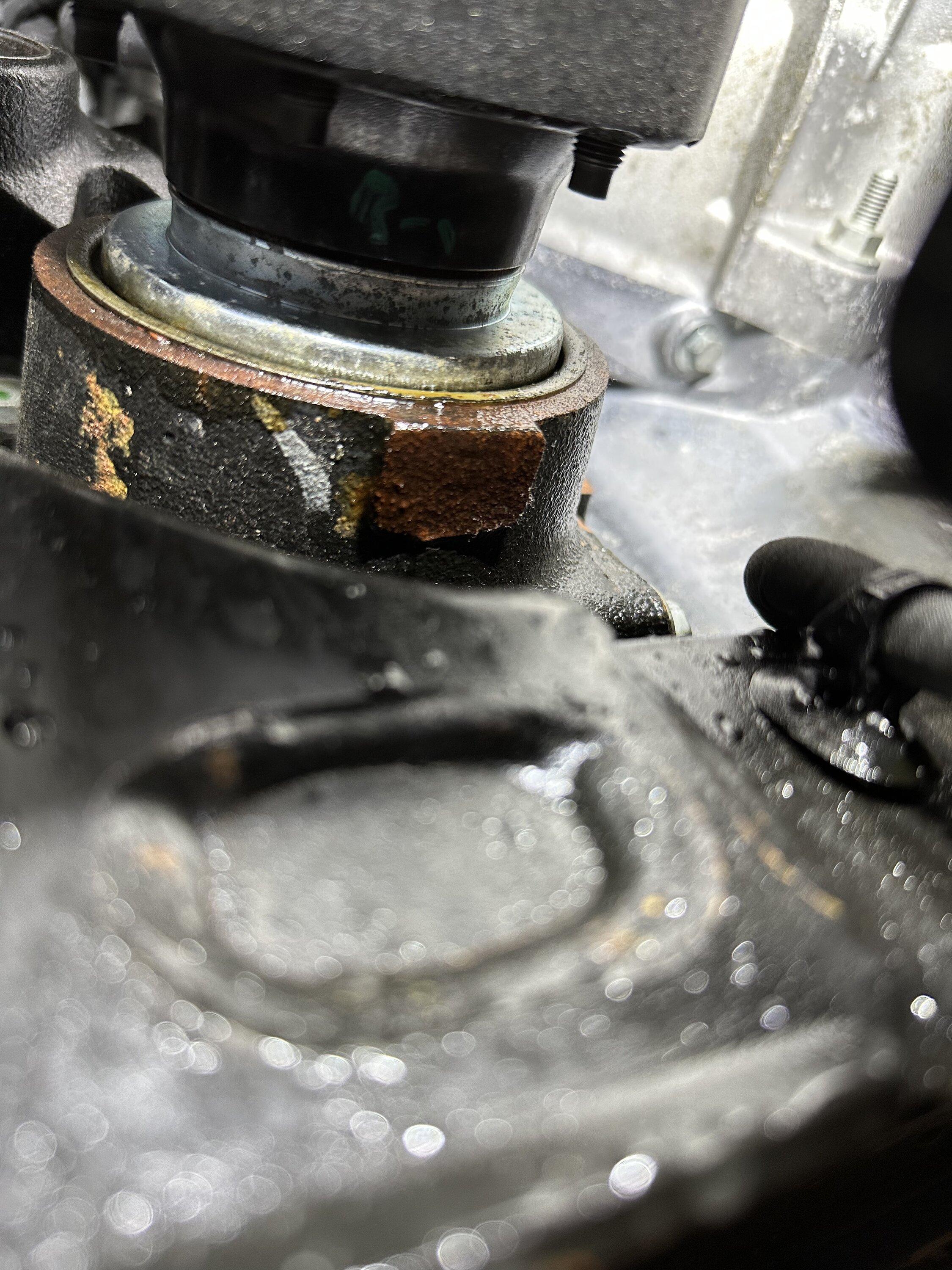

I’m seeing this on my 2021 7MT just under 10k miles. Would love to hear from you other folks how it got resolved. Excuse the general wetness everywhere in the photos below — I did my oil change on a rainy day.

Dropped my Bronco off this morning for this front diff leak, as well as the 7MT TSB inspection. Fingers crossed they diagnose it as only the pinion seal and get parts ordered quickly.
