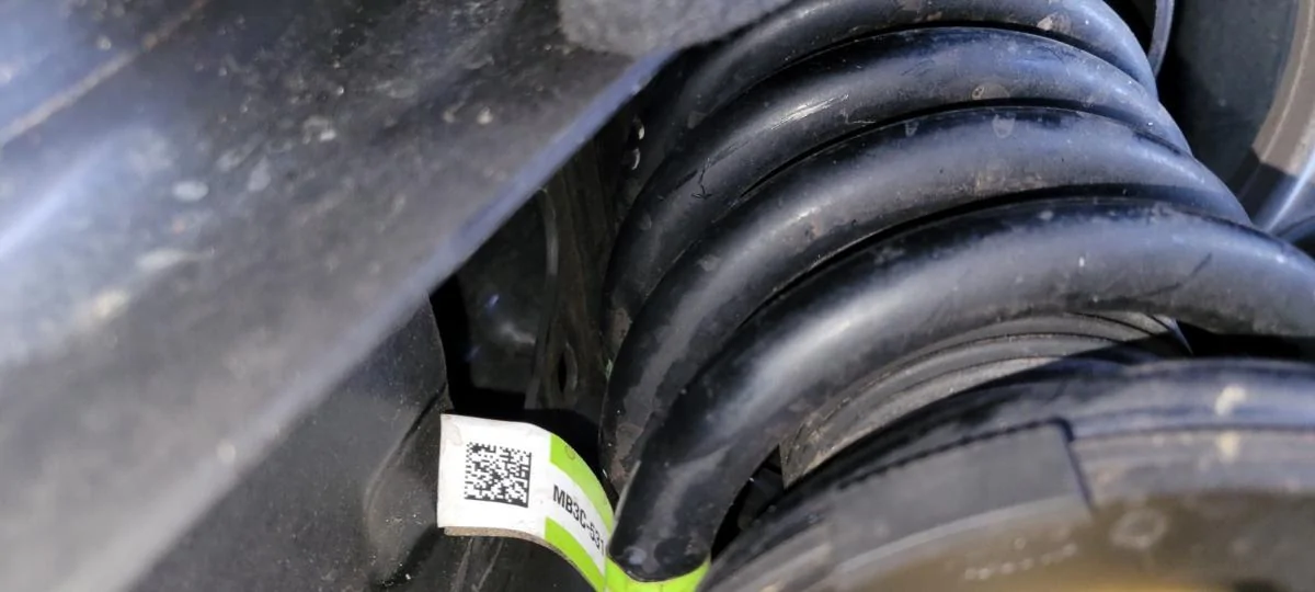

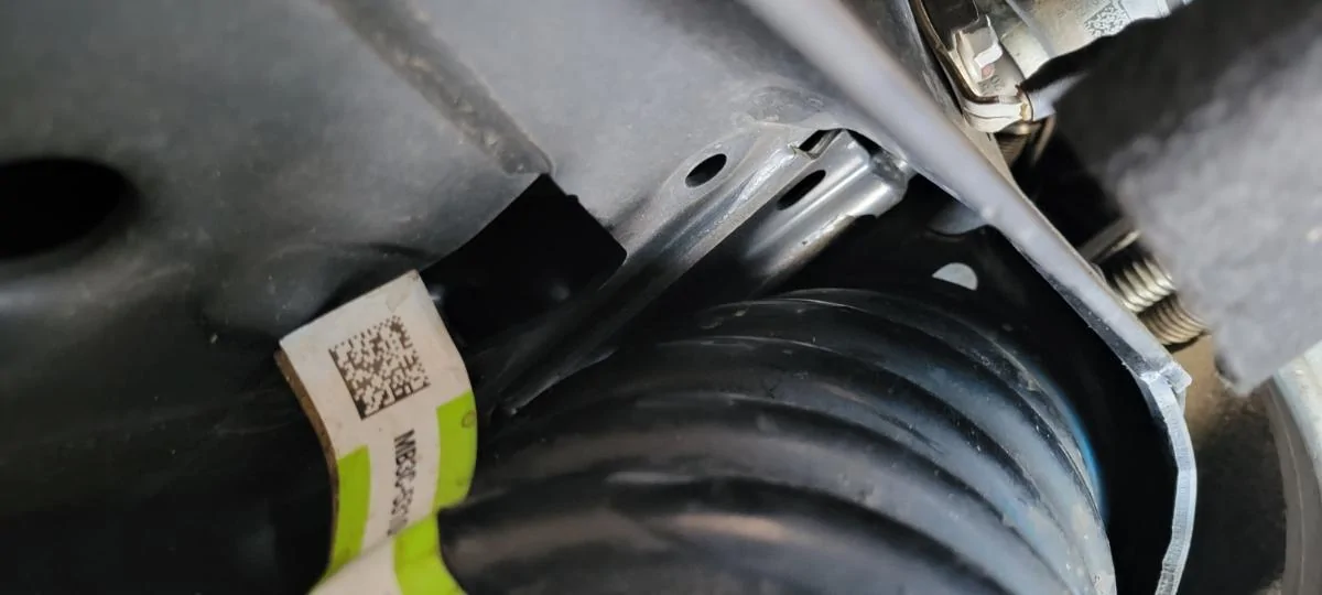

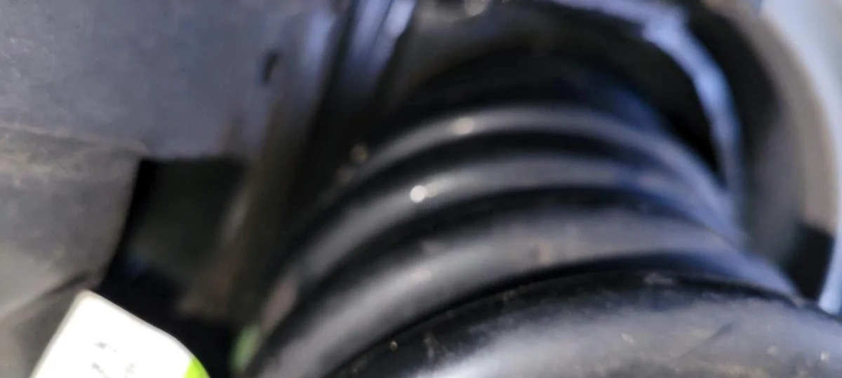

Well they think they found the cause. Left front shock/spring is rubbing on the inboard side of the vehicle. Looking at it with the Service Manager, it looks as though the shock is bent. Spring bows inward. They have ordered a new one. We will see if that resolves it.

you can see the bow in the spring. Sorry for the blurry one but it shows the bow.
