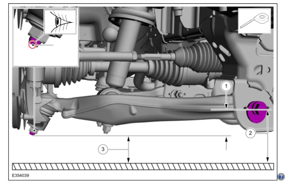

I have a Sasquatch bronco with the 2.7 v6. I’m wondering if anyone have measured both front fender height on their Bronco? I was looking at doing a leveling kit as the next mod and noticed that my driver side front is 1/2 inch lower than the passenger side? The rears matches though…which is odd.

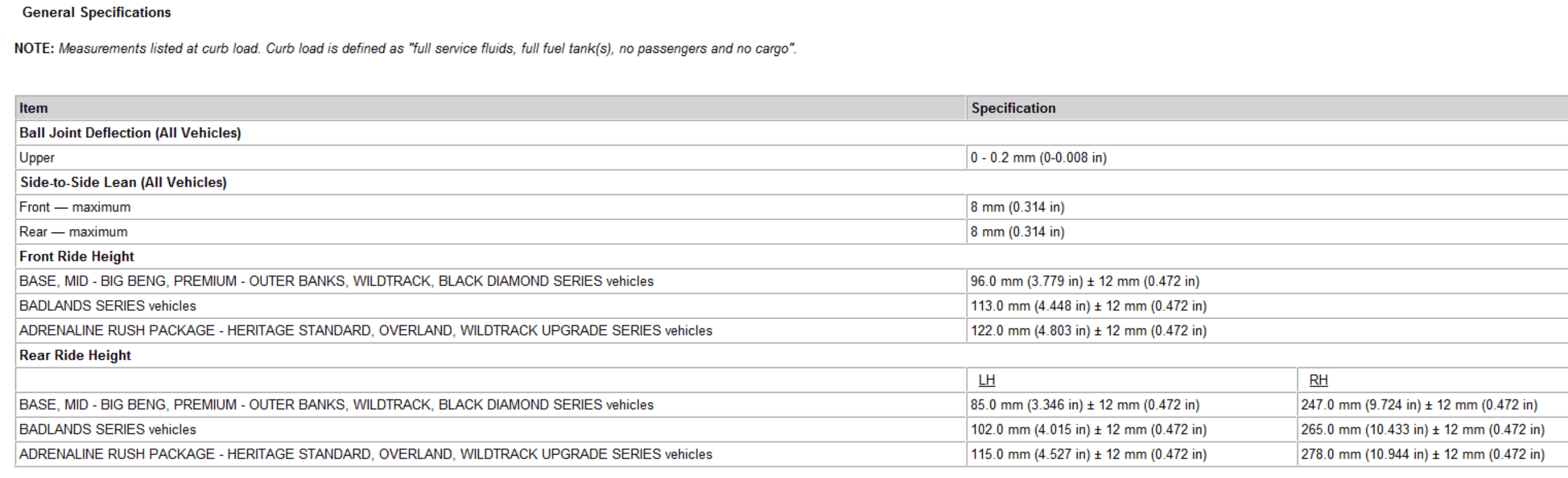

Some lean is within spec (0.3"). Not measured at fender. Note full gas tank. Also, be sure you are in 2H and pulled straight into level area before measuring.
Ford Bronco Front leaning to the driver side 1658812204401
Measured here (#2 - #3 on each side).
Thanks! Did the measurements from there. I’m within spec. Though I’m nearly empty. I’ll check again when I get a tank of gas.
