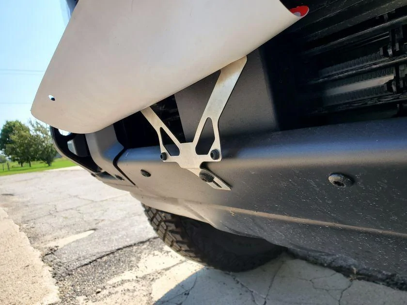

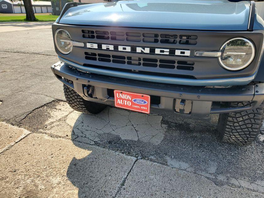

Here's what I did on our Mannequin. Bracket from Craig's Mustang brackets, they come with a stick on stud, but I just used one of the Bronco bolts. I had to bend the bracket to get the angle right. Also this is for the modular bumper, and if you have adaptive cruise control I think the metal plate would block the sensor.

Looks great, and great spot for the plate to be out of the way for off reading but a much better spot than the factory bracket. But like you said, likely an issue for anyone with ACC on their build.

Looks great. Any cooling concerns? I think those are active shutters behind the plate.

Which bracket did you buy? The universal or one specific for a year? I like this plan.

+1, this looks like the cleanest I've seen so far and I don't have ACC.
