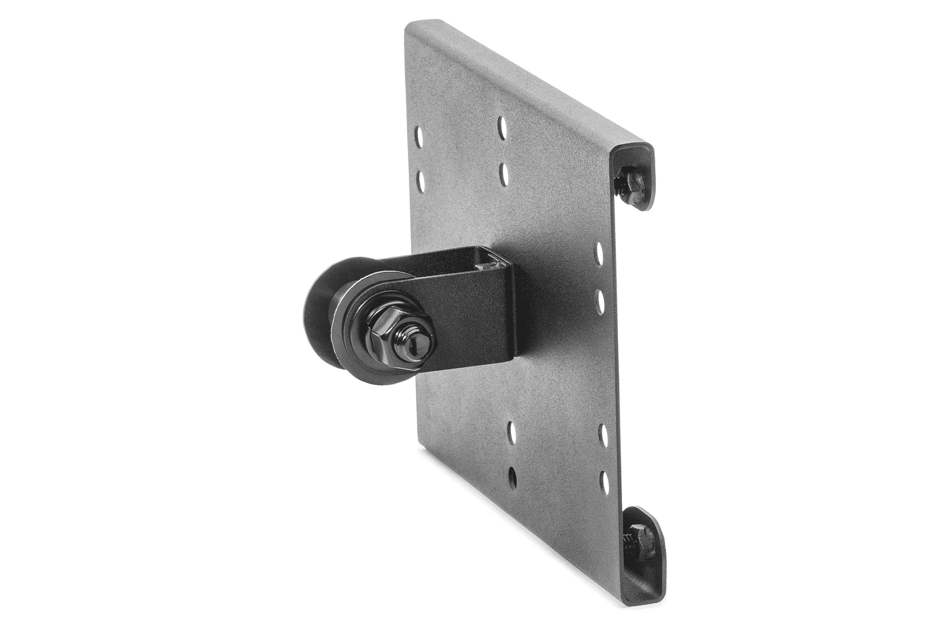

I have one of these ready for delivery of my truck in the next few days hopefully.
you can relocate where the shackle mount is mounted to the plate mount. There are 5-7 different locations (see all the holes in the plate)
im thinking moving the shackle mount to the top center holes will keep it low and out of the way of the sensors
Did you actually do this?

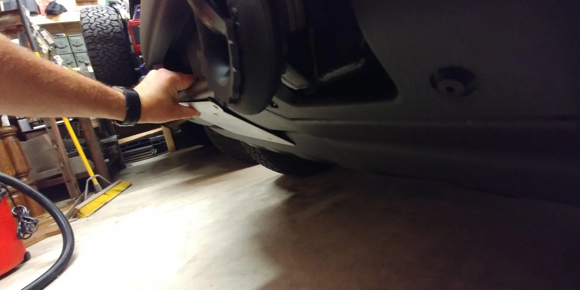

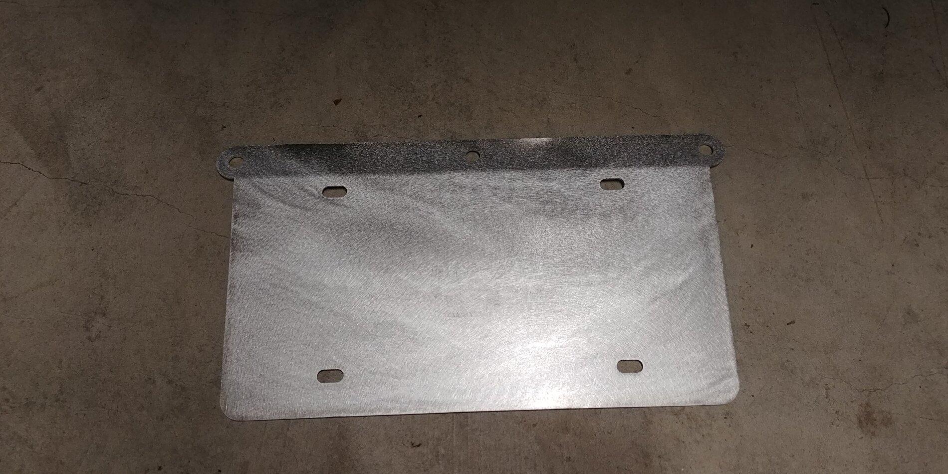

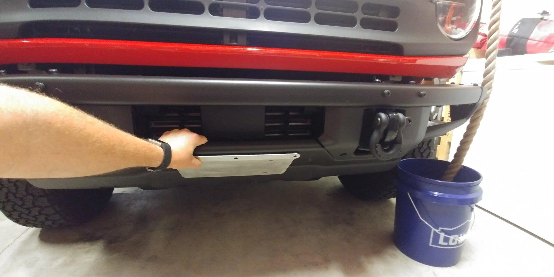

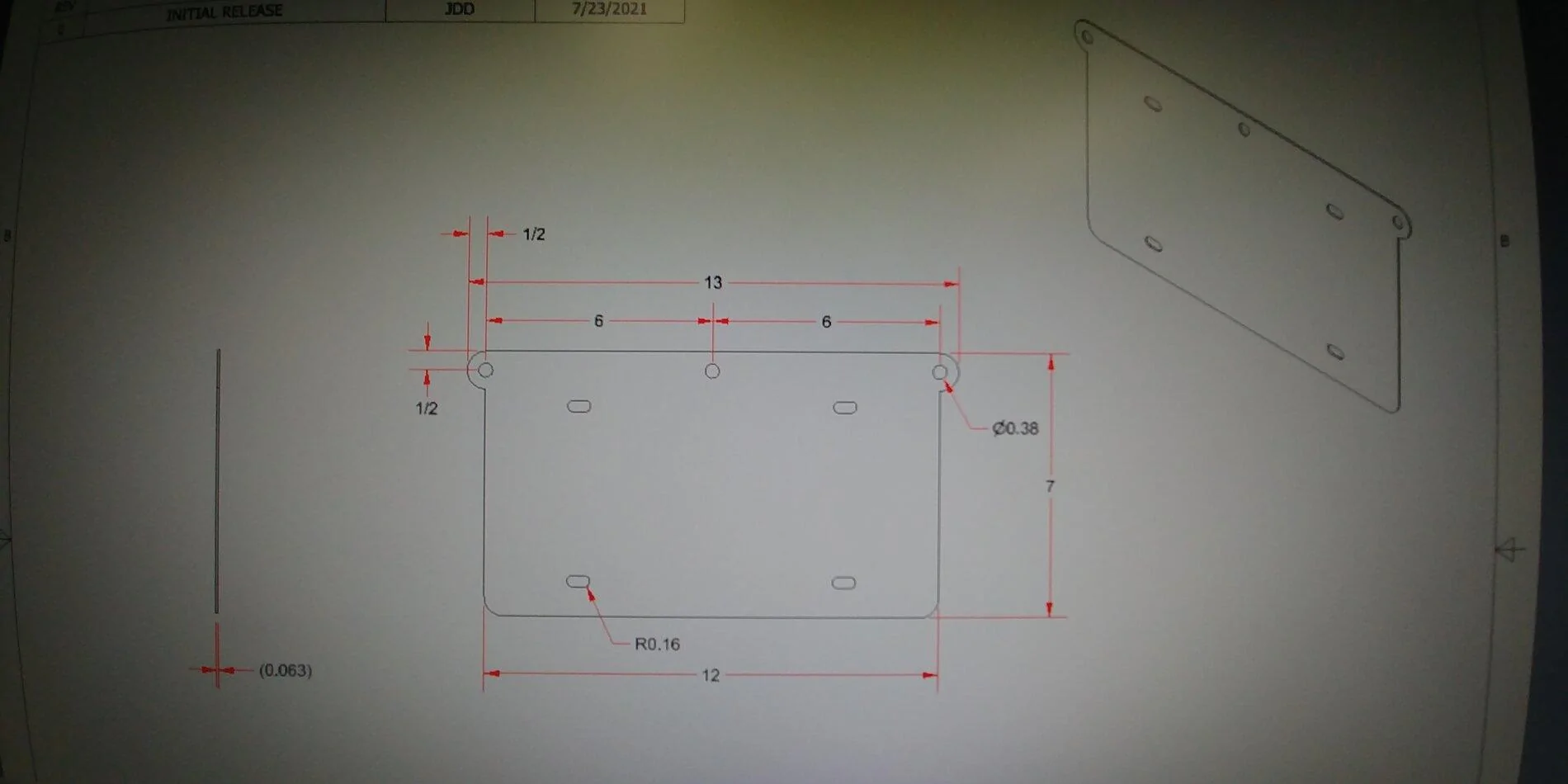

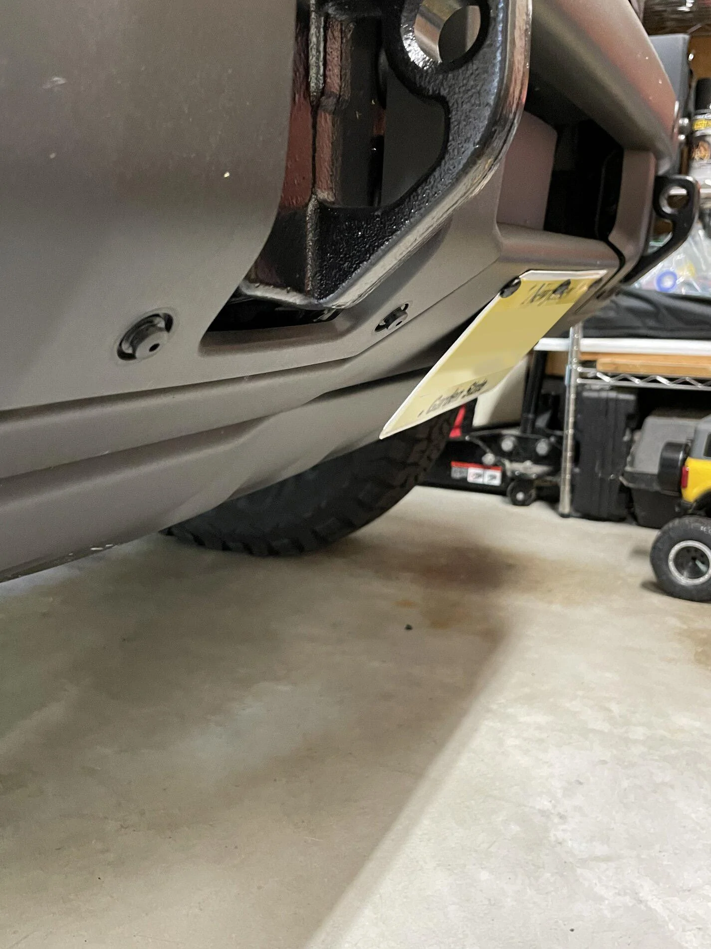

This is kind of my plan. Except I'm going to make it follow the skid plate underneath. Will be pointed down, but meh. At least it is there.
Having it laser/formed/powder coated this week.

Not sure if it's marketable. It points down quite a bit. My wife said she would rather just run without a plate until she gets a ticket.
I could make them and sell if people want them. Can powder coat also.
Ford Bronco Front license plate mount options? 20210921_163758
Ford Bronco Front license plate mount options? 20210921_163812
Ford Bronco Front license plate mount options? 20210921_163907

My design bends back over sharply to keep the height up. Some states have height from the ground requirements so this design elevates the tag higher.

I do not. I only verified 12” off the ground.

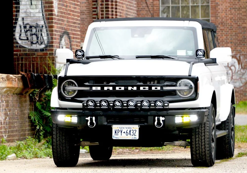

For all the unfortunate souls like me that are required by law to mount the front license plate: Has anyone seen any interesting options or alternatives to the stock mount?
If you have the steel bumper, we've got a solution for you expected to be back from production in a few weeks.
It mounts to 2 of the 3 lower accessory bolts on the bottom of your bumper. It's less of an eye sore here and doesn't block any sensors, light openings, etc... completely out of the way.
If you decide to take your truck off-road we've designed it for quick and easy removal. Just remove the 2 bolts from the tabs on the bracket and you can remove the entire assembly and you won't risk snagging the plate on anything on the trail. When you are done, re-attach the plat to stay legal in your state.
Made from .080" aluminum and powder coated (here in the United States) with a lifetime warranty.
The kit includes the license plate bracket along with hardware to mount your plate to it.

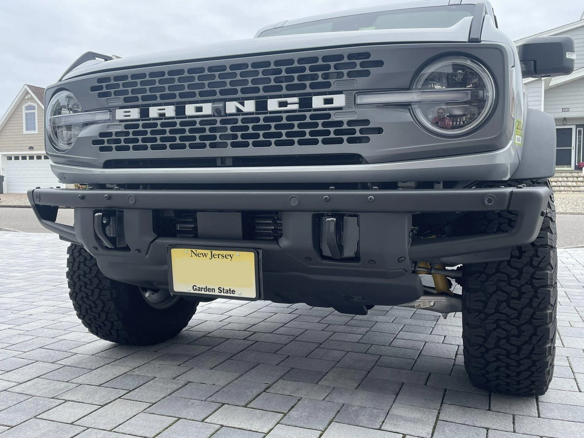

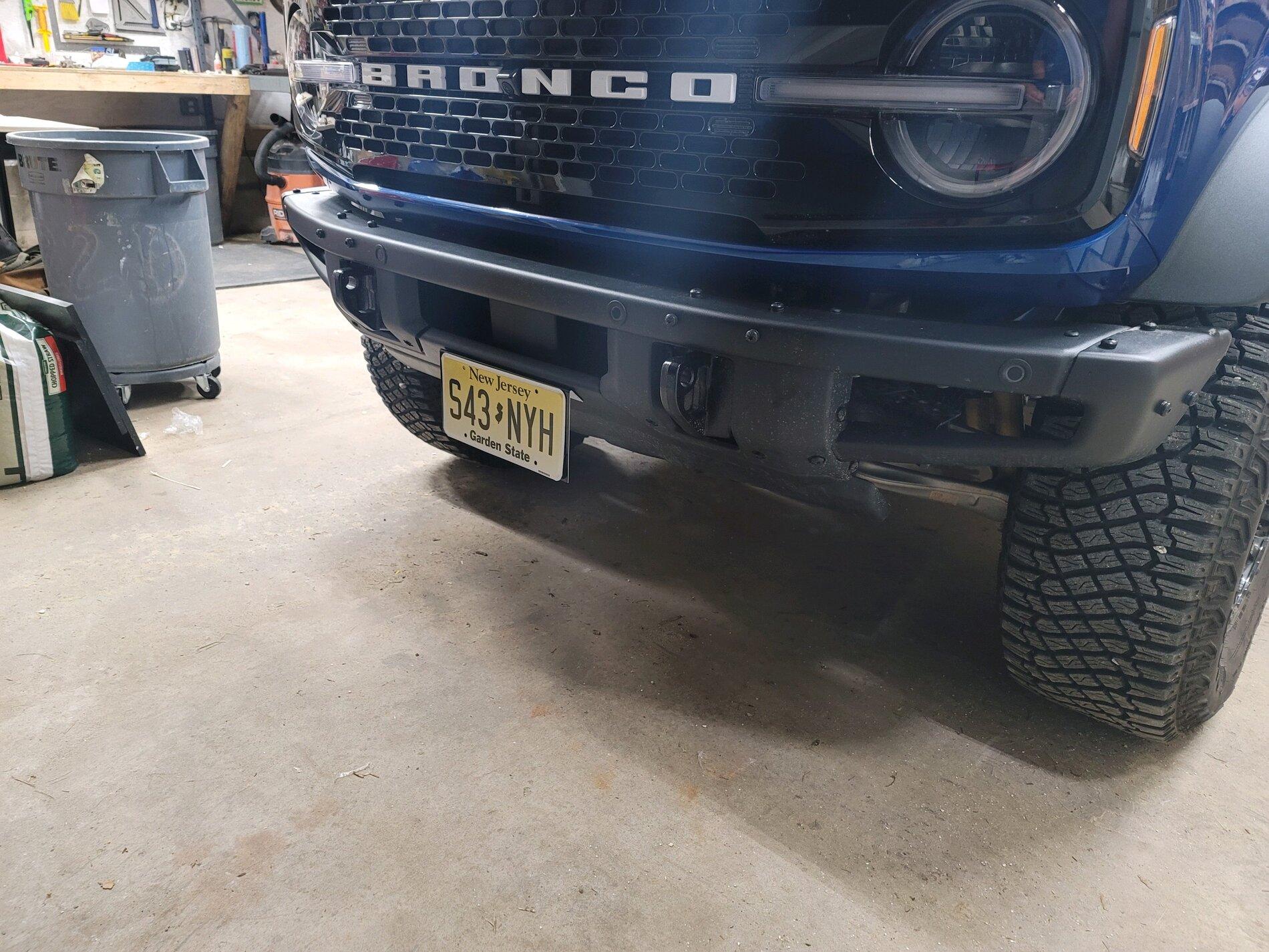

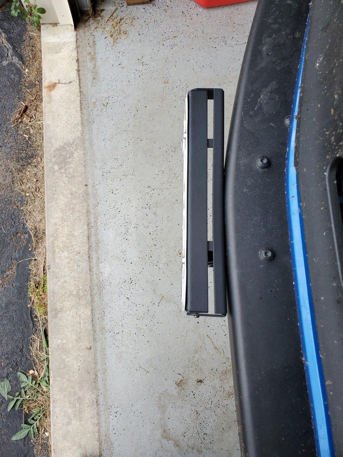

If you go a Mod bumper and 3/8" drill bit, you've got a free mount. I mounted mine like this. Also, just gave it a slight bend for more "visibility"? First time I've run a front plate in more then a decade so my thought is better then nothing haha
Ford Bronco Front license plate mount options? 499A763F-D0B0-4FFA-836C-06F245149517
Ford Bronco Front license plate mount options? BC1B4EC0-A000-4BB5-8C14-FCFD17730689

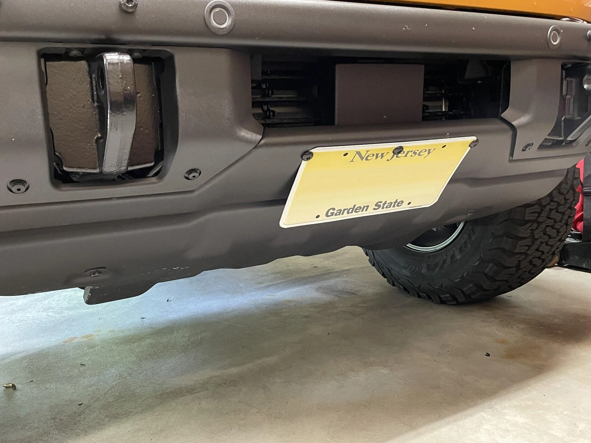

Honestly the best option for the money is this from @HBTFD for just $30 delivered. The only thing I added was a rubber license plate border to look more finished.
Ford Bronco Front license plate mount options? 95C56252-1FD1-435E-8A7D-5054C7F7B502
send a link to the border? i just ordered my bracket. She's coming in december and I feel like i'm getting a nursery ready for my child, ha
