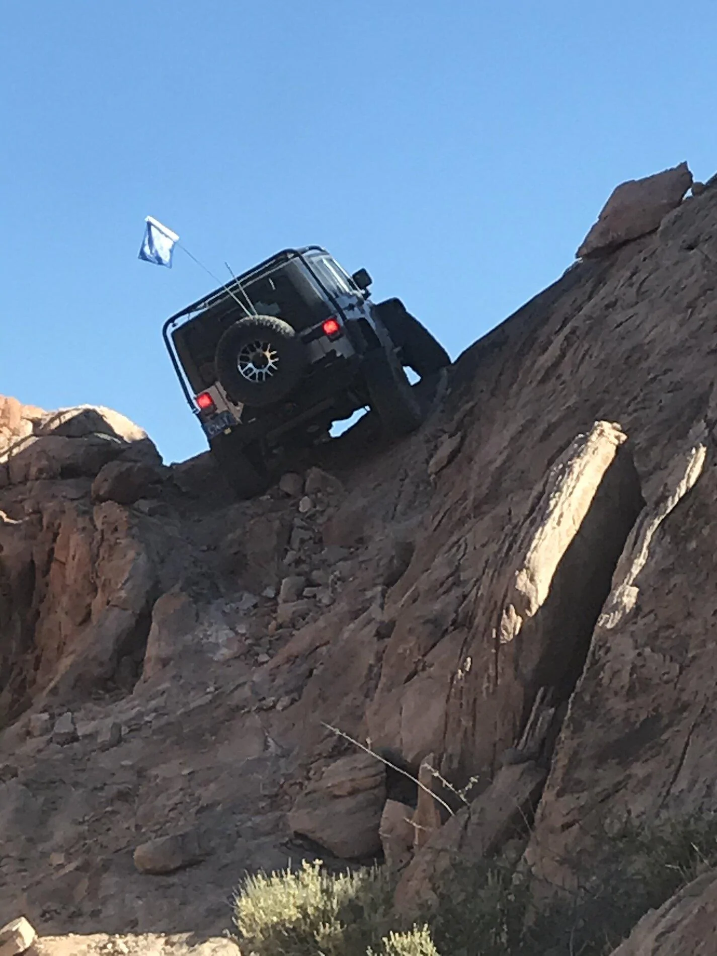

Here is a pic I took on trail. Open diffs (no lockers). You can do a lot with these new machines. BD is even more capable. You will enjoy being able to get off the paved roads in your truck and explore the sights many car owners never see.
Ford Bronco Front lockers, aftermarket?  Disco bar? A9EDF655-D587-4BA3-BB08-B13A38F7CEE1
If you look at that and say you would never do anything like that then you could easily save $$ and not consider front lockers. But they are sweet to have.
in 7 years of ownership I have had my locker activated less than 30 minutes total. But it gets me everywhere I want to go because I can use it. It’s not something you drive around with activated. Just use it when you need it.
And I've done climbs like this with my lifted f150 towing my 3400lb offroad camper and never once engaged my rear locker, just left it in 4L and crawled up it. Again, why I say I can count on 1 hand how many times Ive engaged my lockers in both my truck and jeep in the last year.
