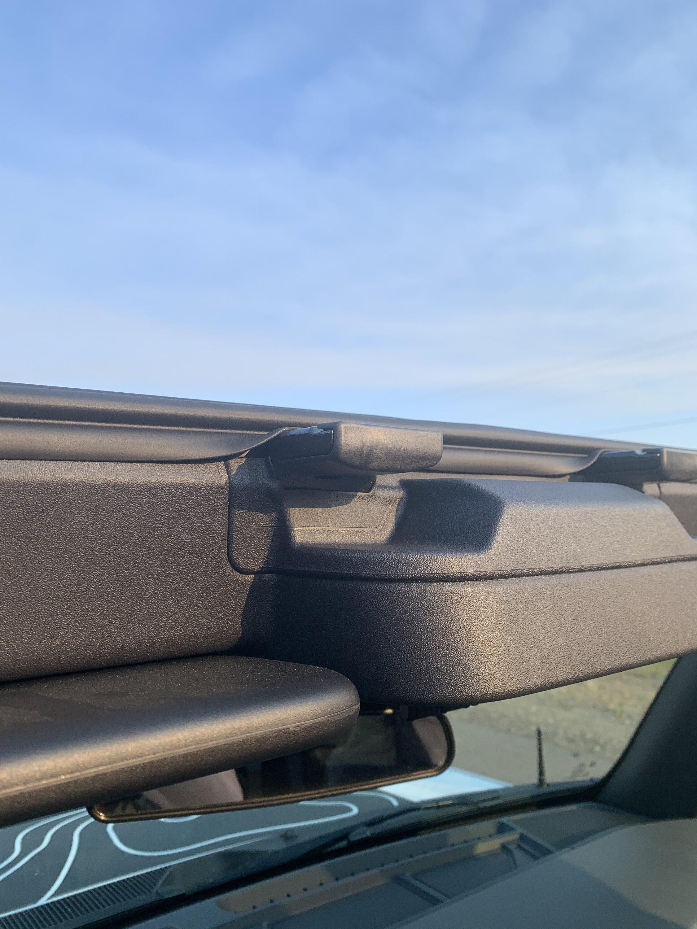

Got my Bronco about a week ago. Hasn’t really rained much except last night. This morning on the way to work a few drops of water hit the back of my hand pulling out of the driveway. I pulled the panels off after work and noticed this seal looked odd. The way it was positioned seemed to prevent the seal from actually sealing. Fingers crossed this was the issue next time it rains.

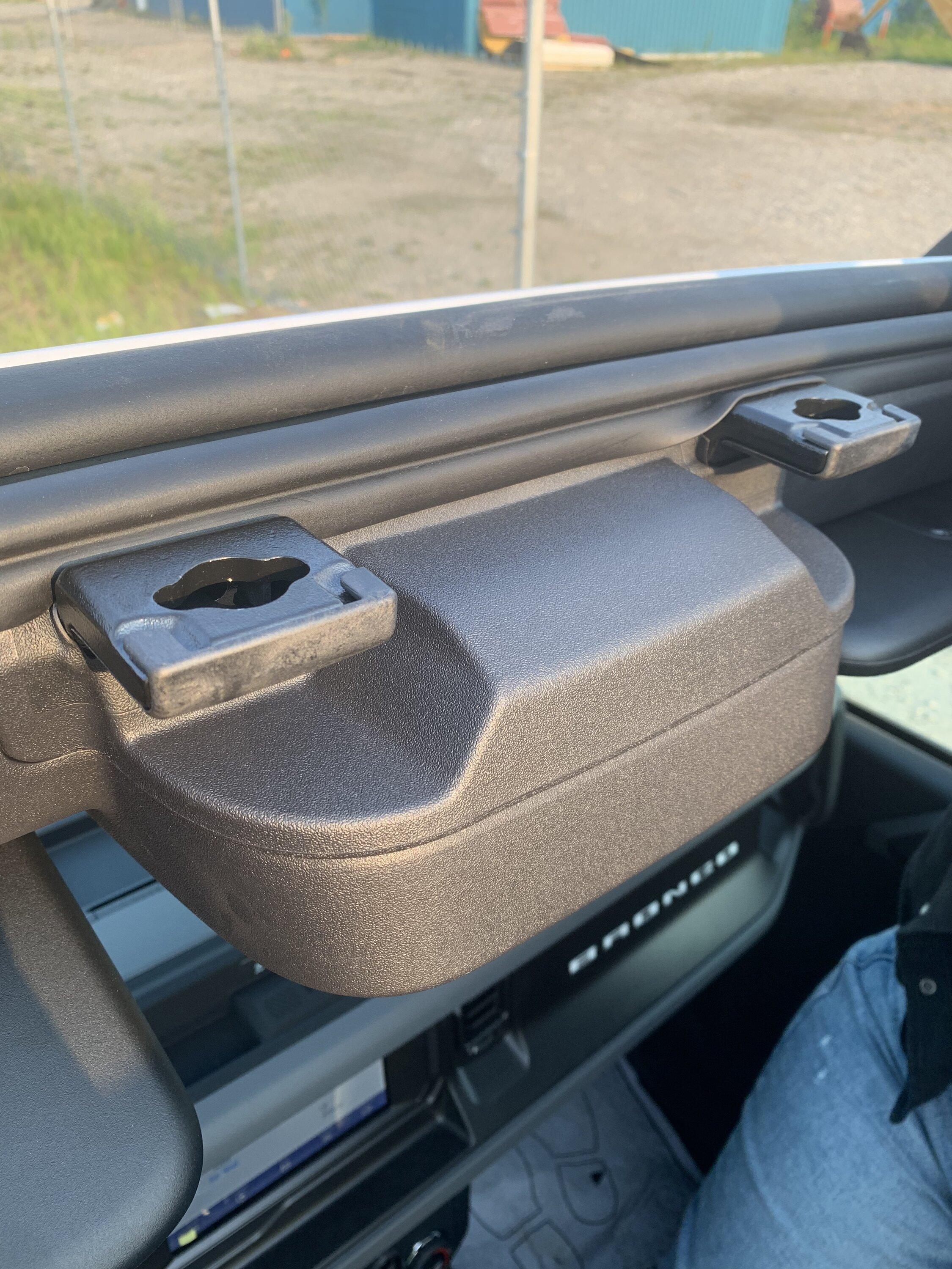

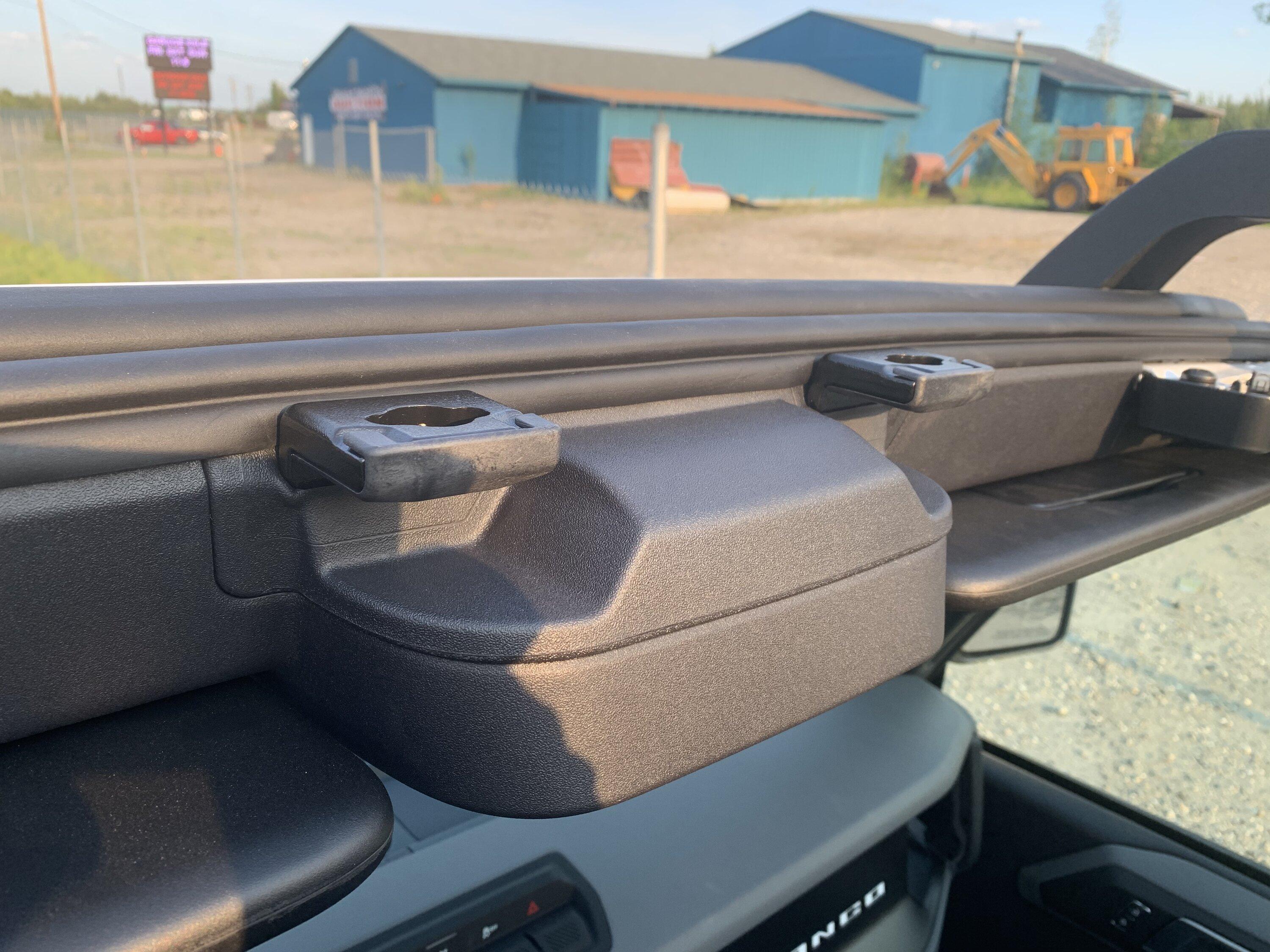

I'm not sure how severe your issue was but I'm hoping mine is fixed by me tucking the seal back into where it appeared to belong. I tucked it behind 1/2 roof brackets in the 2nd pic and both in the 3rd. Time will tell if the adjustment keeps me from getting wet.

Sorry but it was fine the first time. That flap is not a seal, just cosmetic trim. The actual seal is above it where the panel touches.
This windshield leak is a known defect your dealer will have to address. Although a couple drops of water might not be a real issue, sometimes adjusting the panels can fix a minor leak.

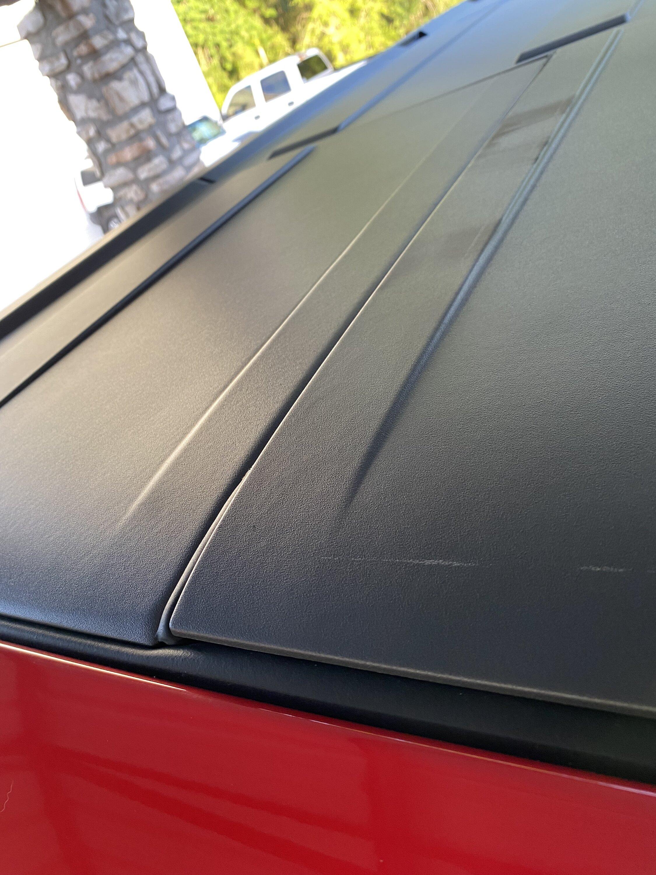

I've been scouring the forum to see if anyone has the same problem I'm having with my hardtop. Did you ever have yours looked at or fixed. I took delivery of my Bronco 2 weeks ago and the day after delivery I noticed that my driver's side panel wasn't sitting flat against my roof. I contacted the dealership and Ford about it. They looked at it, we agreed that it appeared the panels were out of alignment, then proceeded to order new roof panels. Took it in today for the warranty work, picked it up, and it still looks wrong and is still noisey. The tech was insistant that that was how it was supposed to sit. Also, my passenger side is hard to remove and reseat. Again the tech insists it's designed that way. Soooo.... I drove to another dealership 30 miles away that had 3 on hand. Their hardtops look perfectly seated. I'm so aggravated right now. I know Ford will be contacting tomorrow because I have an open case, but how do I get them to understand that it is not right?

It looks like you have a different issue, my panels were not that out of alignment. I haven’t had an issue since I removed and reattached them. You may want to ensure your panels are attached to the mounting locatings properly.
Pictures of the panels in the correct position and the seal not being compressed should be proof enough.

That’s pretty bad. Looks like the latch isn’t pulling the panel in tight enough. I would look at the latch and bracket in that corner and verify everything looks ok. There is a little alignment disc that might not be seating correctly too.
And damn, nice to see the quality of the mic panels is still garbage. Those looks like crap. As do mine from last year.

My front panels look exactly like yours and my front passenger panel is exactly as you describe. I forgot to mention this concern when I brought the Bronco to my dealer for servicing and other warranty issues, a couple weeks ago. I'll need to bring it up when I go back.

Did you notice the nice scuff marks? I got 2 new panels today, so no more scuffs. The panels latch down pretty tight. My thought is that maybe the bracket is misaligned? Seems if the bracket could be moved down just a tad, then it would pull the panel on down to the roof. I don't know if that's possible or not, but they won't even acknowldge that idea. It's just frustrating to wait so long for it and now have to deal with this problem.

Scuffs and snakeskin. Glad the new ones are better.
Yes it looks like maybe the bracket needs to be adjusted. It’s just a couple bolts. I would loosen it and see if it can be moved a bit to see if that lets the alignment pins settle in better.
