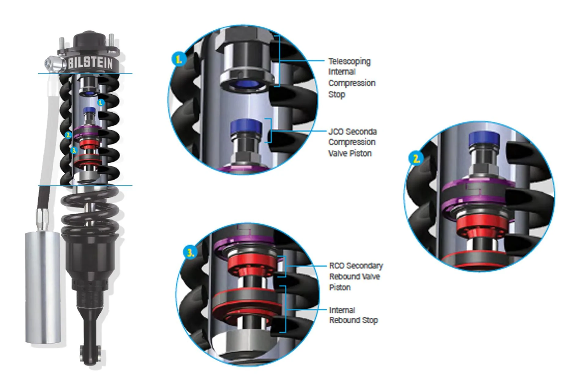

Sure you can change the springs, HOWEVER, now you have messed with the valving due to the spring rate change. So then you see IF, Bilstein will offer a valve kit and now you can try endless combinations to get the ride correct. All doable, but do you want to?
Ford designed the Bronco to have a factory winch, so the spring rate, especially on a Squatch, should be fine. Worse case, not ideal, add some leveling pucks, but again, they have their own set of issues, everything is a tradeoff.
BILSTEIN B3: Coil springs in a class of their own.
BILSTEIN ESCV Bronco suspension / shocks explained - "End Stop Control Valve" Dampers (Bronco HOSS Suspension w/ Position Sensitive Dampers)
Bilstein B8 8112 Zone Control Coilover For Toyota Tacomas
