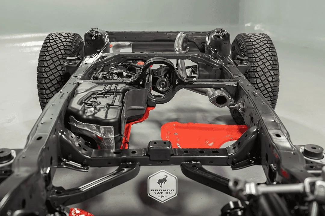

I assume they're shooting for a specific range rather than some maximum volume of fuel capacity. The 4cyl Explorer gets a 17.9 gallon tank, while the V6 gets 20.2 gallons. There's nothing about the V6 that gives more room for a bigger fuel tank, but they probably want to minimize loaded weight on the smaller engine if it still hits their range targets. Combined mpg for the I4 is 23, times a 17.9 gal tank is 412 miles range. Combined for the V6 is 20mpg, times 20.2 gallons is 404 miles. That seems to track.
The Bronco will absolutely get worse mileage than the Explorer, so they need a bigger tank to get the range. From the marketing photos of the bare chassis, it looks like the tank size is constrained by the front crossmember, transfer case, and rear axle:
Ford Bronco fuel tank capacity 1615820284071
So the four door can fit a physically larger tank than the 2.
