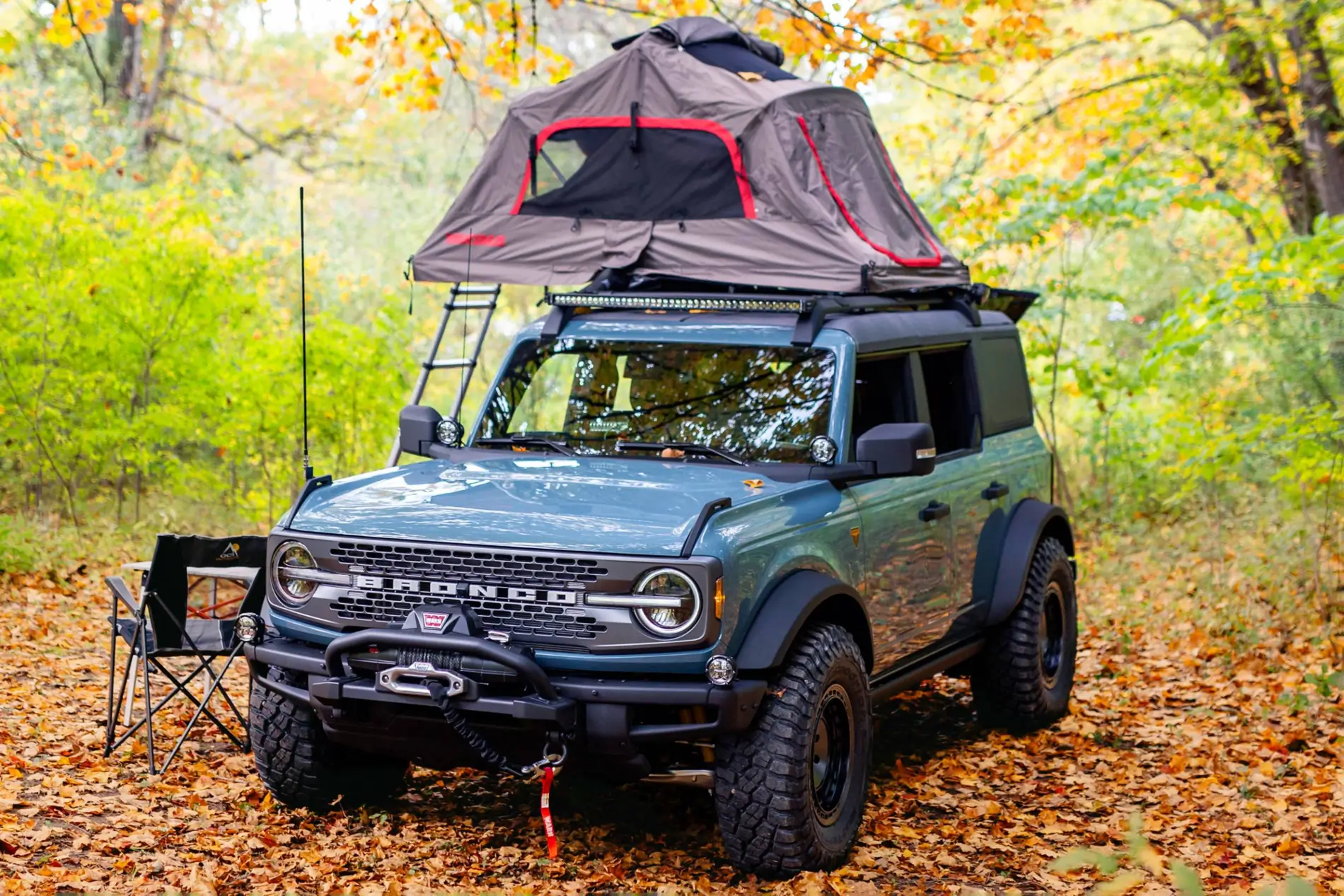

depending on width, if they are the same 8.5", they will stick out an additional 1.14 inches (approx) farther than the Squatch wheels. Or, 1/4" less than the Overland rig.
Considering how far out the Squatch wheels are and the size of the flares required to cover them....
Here's the Overland rig again:
6mm offset will be only 1/4 inch less reveal than this rig.
Ford Bronco Fuel Wheels D557 6 offset 1613182419752
Have we had confirmation that overland rig can flex/turn/articulate without hitting a tire into anything? It seems like that rig is mostly parked at events.

I did see it being driven.... verrrrry slowly.... and with wide generous turns.....
For all we know it may have been because it could flip and roll at any moment. But in any event we’re still really too early to know what fits and what doesn’t.

I have read that it isn't even a Squatched rig....it was a VERY early pre-pro model, non sqautch lift, which is why it has that STUFFED look.
As far as clearancing...I will not speculate.
But I would be very curious to know also, as I'm getting a base Base and fully intend to put at least 33's on it asap.
I'm looking at no less than 20 or 25mm offset wheels, personally.

For sure. I saw the overland rig in Seattle. I should have watched when they drove it up onto the sidewalk. I am looking for 20-30mm offset wheels myself. I think I have settled on the Trail Ready Flow form or USA forged wheels with simulated bead locks.

Maybe this thread won't get deleted/lost:
per tiresize.com wheel calculator.
Using what I can gather from the Stig shots of the wheels and assuming the Base wheel is the same Ranger wheel, which has been stated elswhere.
16 x 7 = 55mm offset = 6.17" Backspace (Base)
17&18 x 7.5 = 55mm = 6.42" backspace (BB, BD & OBX)
17 x 8 = 55mm offset = 6.67" backspace (Badlands)
17 x 8.5 = 30mm off = 5.93" backspace (Squatch)
D557 _ 17 x 8.5 _ 6mm offset = 4.99 bs
D557 _ 17 X 8.5 _ -6mm offset = 4.5 bs
