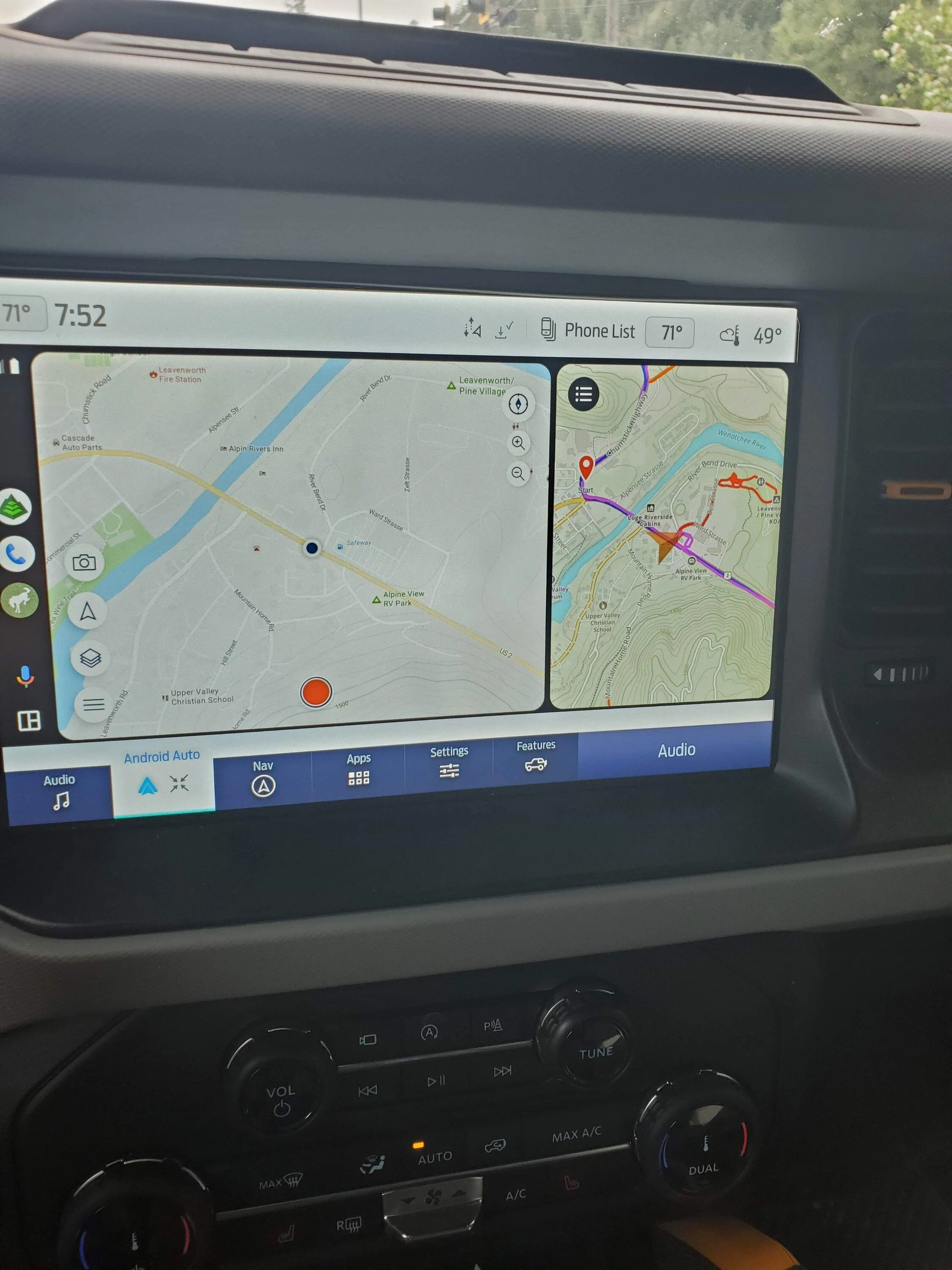

I've used Gaia as a road map on a couple of long road trips recently, not for navigation per say, just to have a decent map up on the screen to watch routes and the general area. I have found that it's possible to get the location marker back if it disappears by going back and forth with full screen, jumping over to the Ford Nav (which I think really sucks), eventually it comes back - maybe. I set up wireless charging pad and it can't quite keep up with it, phone will get hot and start shutting down apps, although Gaia could still be running on the screen. I need to try it plugged in via USB and see if that will keep up with the charging and maybe not be so flakey.
Speaking of flakey, have been trying the Bronco app as a general map, needs internet of course, but how about this. Somehow I had that up on the main portion of the screen and then Gaia running on the far right portion of the screen at the same time. Both showing location and tracking. No idea what I did to get that
