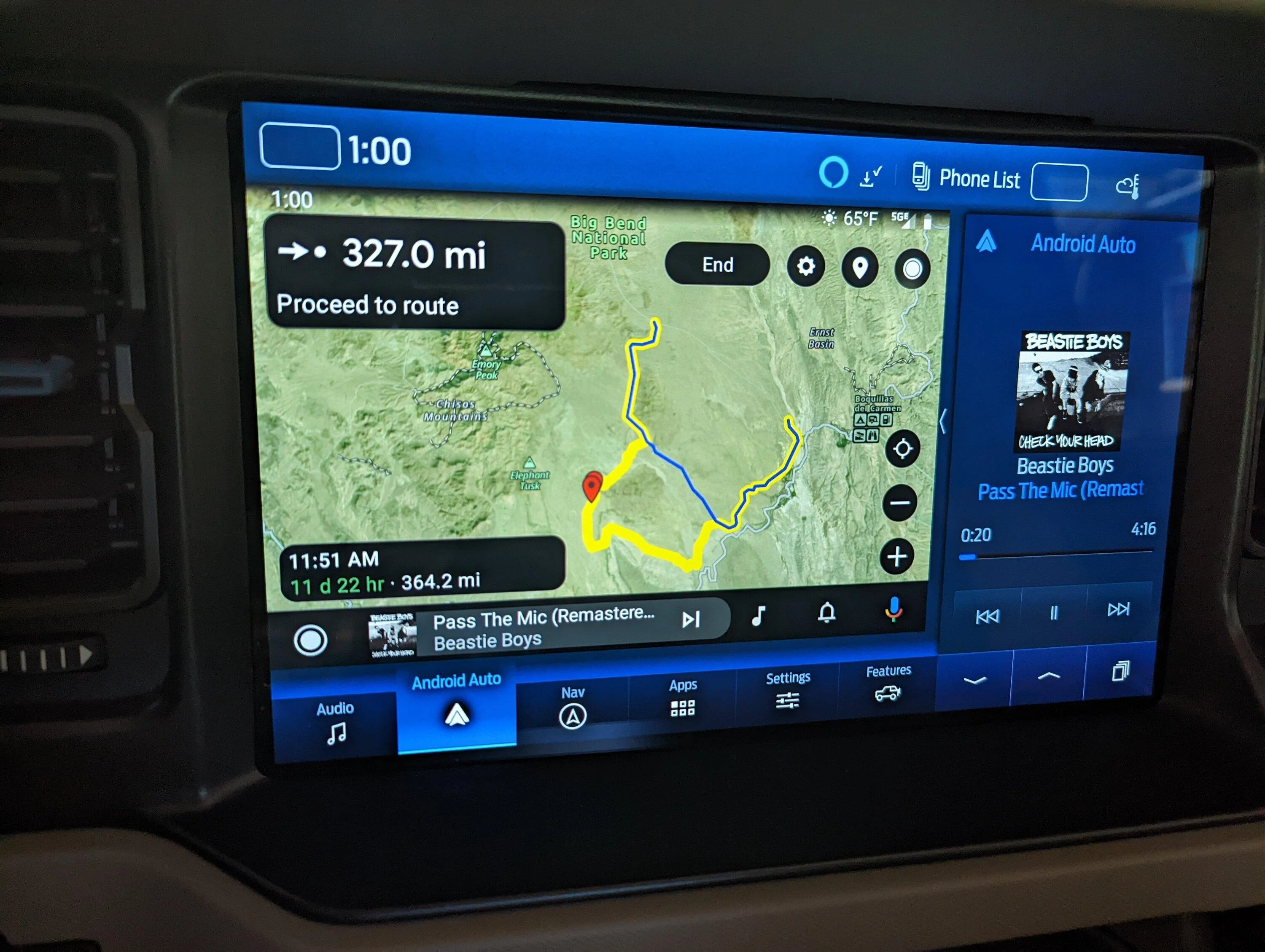

I submitted a bug report / support request and separately a feature request to Gaia to see if there's something they can fix from their side. However, I really think this is an issue from Ford Sync's side where they're not recognizing Gaia (or OnX) as a Sync supported app.
Regardless, you can make it work. In the settings menus it even tells you how to do it (although cryptically) . Here are the Steps:
1) Have Gaia or OnX loaded on your phone
2) Establish BT connection between your phone and the Bronco

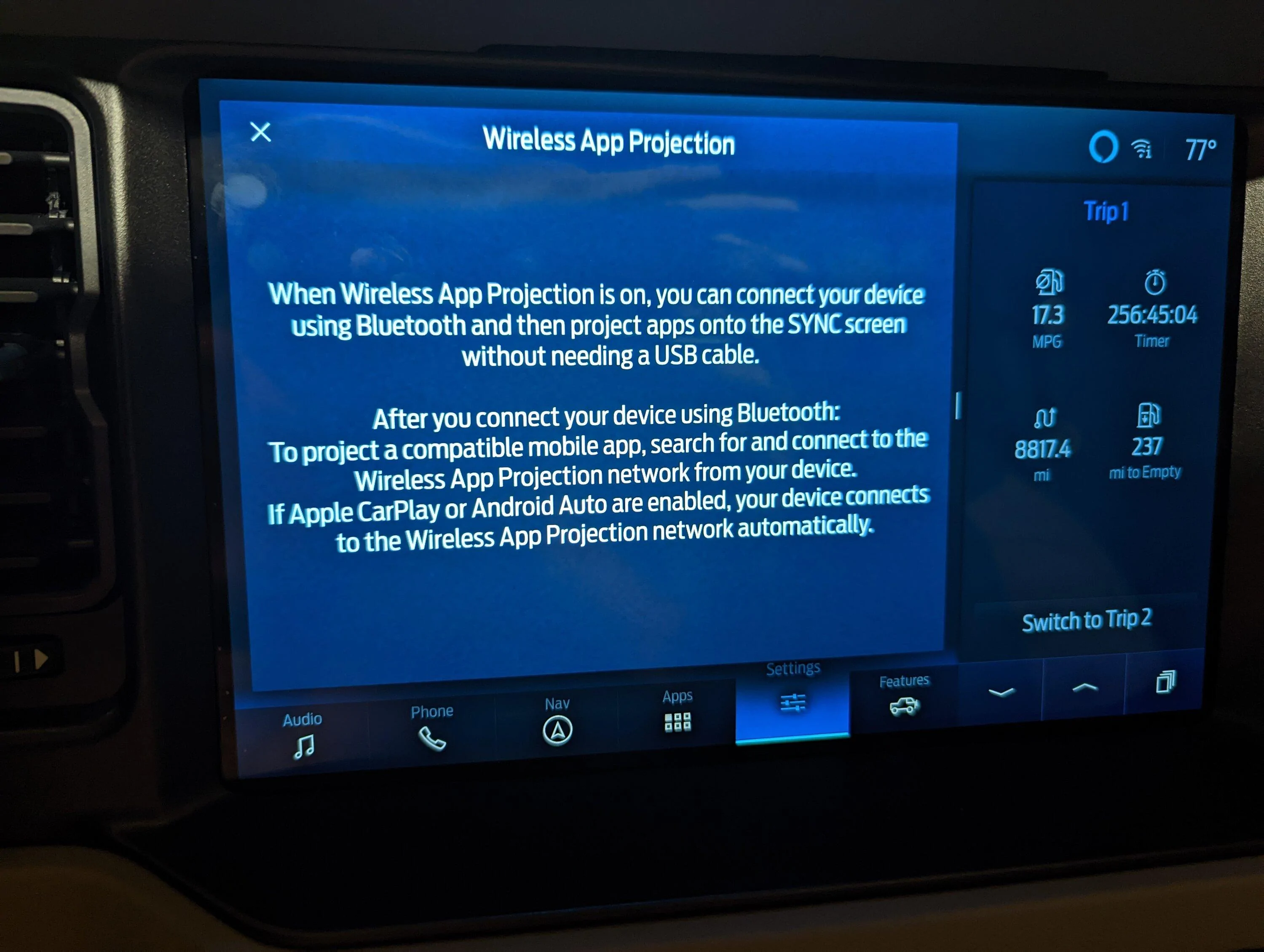

3) Go to Settings -> Connectivity -> Wireless App Projection. In that menu page, you'll see an info button ("i" in a circle) on the right which tells you what to do. See photo below. "When Wireless App Projection is on, you can connect your device using Bluetooth.... After you connect your device using BT: To project a compatible mobile app, search for and connect to the Wireless App Projection network from your device."

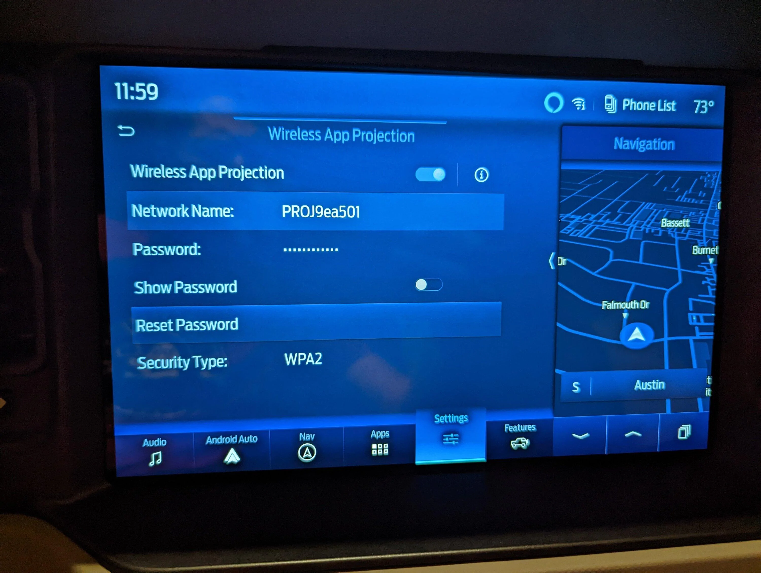

4) You'll see "Network Name" generated by your Bronco on the Wireless App Projection. This is a wifi network that you will need to join on your phone. Slide the "show password" tab on the Bronco Sync screen to see log in password.
5) From there open Android Auto on the Bronco, click the bottom left white circle to see the app drawer. You'll see Gaia (and OnX if you have it on your phone) in the app drawer and you can select them.
My phone is now automatically connecting to the projection wifi network every time I start the car after saving it as one of my known wifi networks. So Gaia and OnX are now always appearing in the Android Auto app tray. No extra steps required. (except pay the annual membership of course)

Yeah I don't have that problem.
But the bigger bug is that it doesn't take up the enter 12" screen.
Ha ha ha

No i get full screen if I minimize the second pane.

Any time you want to run Gaia, you'll have to manually reconnect to the Bronco's Wireless App Projection wifi network which will now have been saved to your phone's wifi network list.
Correction - my phone is now automatically connecting to the projection network every time I start the car. So Gaia and OnX are now always appearing in the Android Auto app tray.
