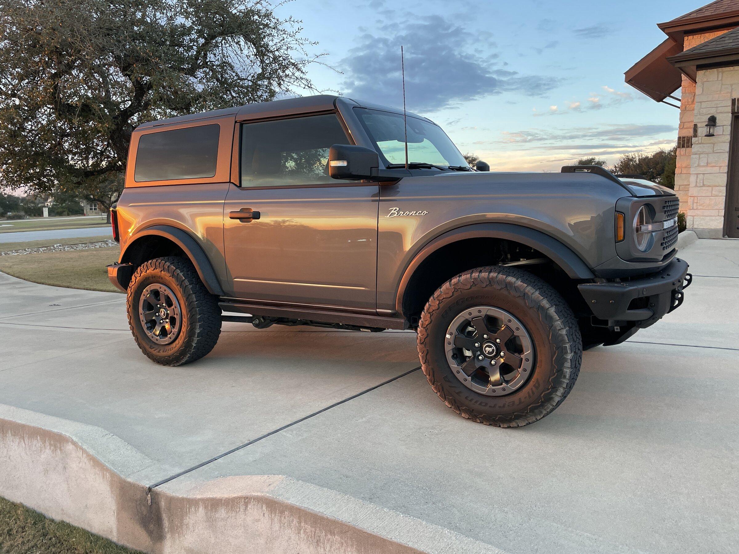

Probably one of my biggest regrets is not getting SAS on my BL.
That said, what would experts or enthusiasts here suggest for a level kit, in order to get 35s on? Besides removing the crash bars, anything else I need and will this affect the ride at all? What level kits would y’all recommend?
also I was hoping I could keep my wheels and just get bigger tires. Has anyone done that before? Here’s my rig.

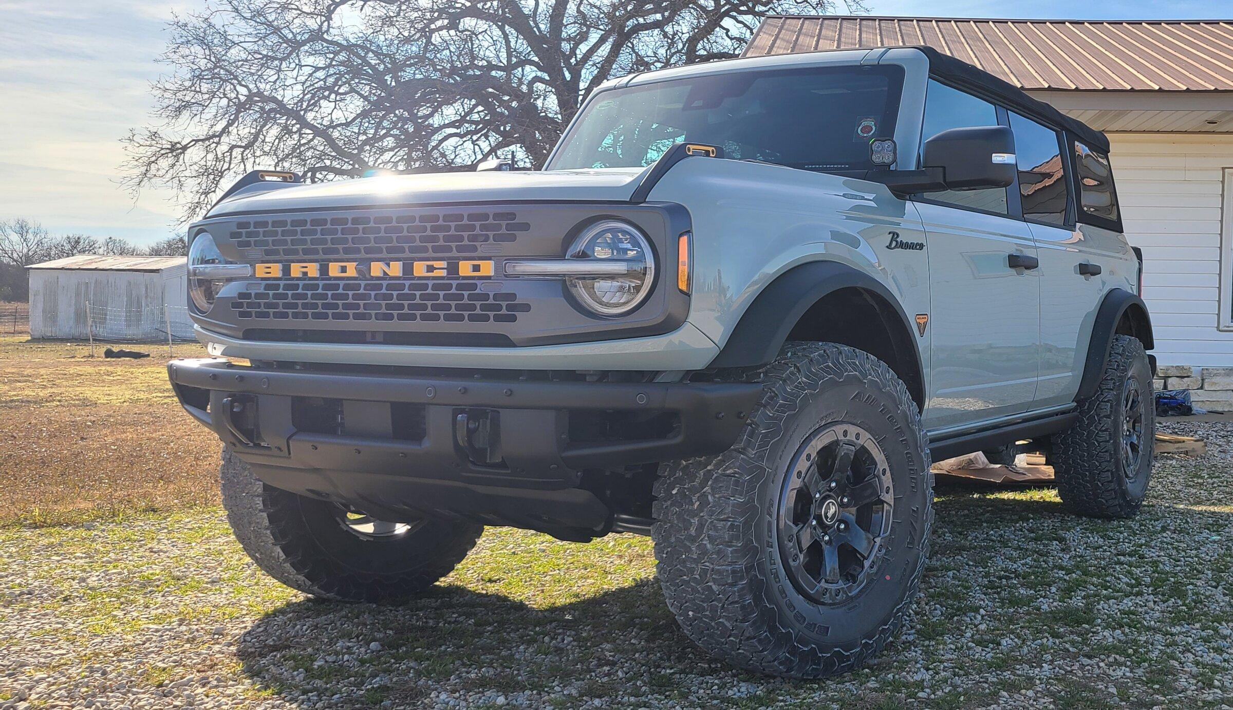

Ford Bronco Getting 35s on a Badlands 20220113_104631
I have a 1" level from Rough Country, removed crash bars and am waiting on my spacers. Without the spacers you'll have a very slight rub on the UCA at full lock on level ground, I won't take it off road until I get the tires a little farther out but it's perfectly fine around town.
And those are the optional ford rims for the badlands? Can you let me know what tires you used? I assume those are 35s
iamchewby
Chewby
Jul 22, 2020
1,475
5,116
Yes, optional Badlands wheels, they're 315/70r17 BFG KO2s, so they're just under a true 35
