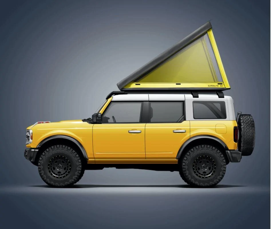

Will this work for a 2 door bronco? Do you need the roof rack for the bronco or can you use the brackets they give you mount it to the roof? First time thinking about getting a roof top tent just wont to make sure I get the right stuff on the bronco before the new order banks open up again.:)
SPECIFICATIONS
Weight: Approximately 80lbs
Length: 90”
Width: 50”
Height Closed: 4-6” (adjustable with bedding)
Height Open: 50”
Roof Storage: Surfboard compatible
Sleeping Footprint: 50” x 90”
Sleeping Capacity: 2 Adults + 🐶/👶
Jumpabillity Index: Almost too Huckable
https://gofastcampers.com/pages/superlite

Looks like you don't need the roof rack.

Looks like it would be too long for a 2 door, but wouldn't this be a question for GFC?
So how is it attached? I don't see anything in the attachment points used by the rack. Perhaps they just set one on top for the pic?
They didn't do anything, that's not a real photo...

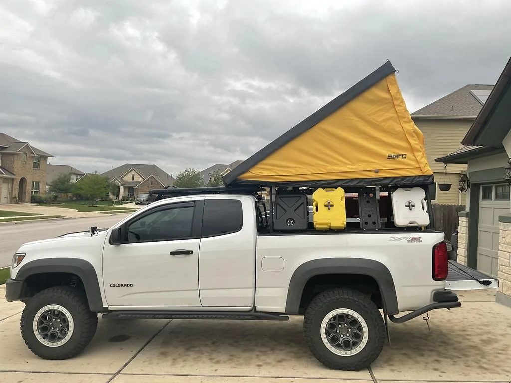

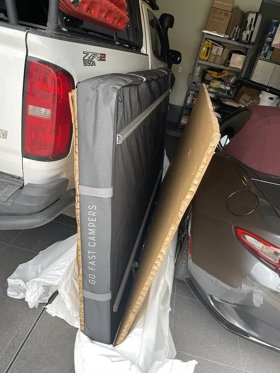

The GFC Superlite attaches like 99% off rooftop tents attach, see the rails in the picture below:

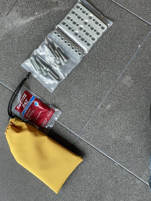

The supplied brackets, work by inserting two "turn" nuts and bolts screw into those that are placed in the long stout brackets and go around roof rack bars:

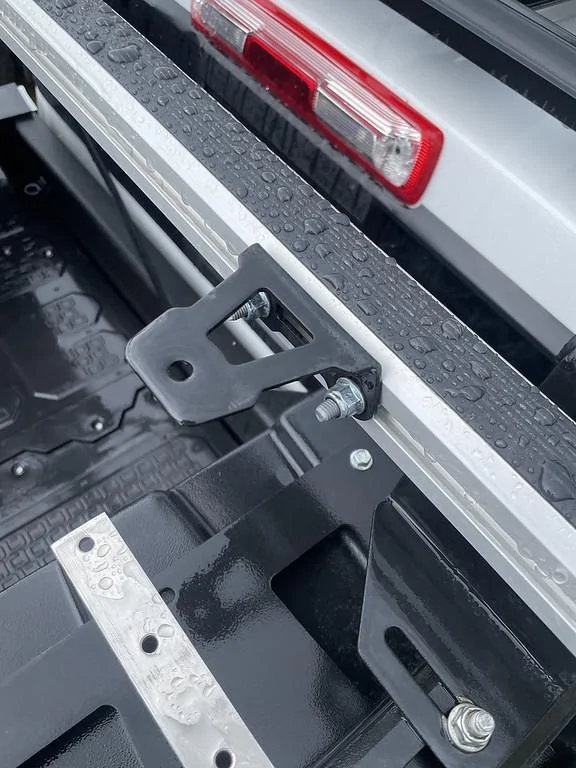

These are the tent brackets from Leitner, I simply pass a small bolt through the hole into the "turn" nut that's inside the rail:
Without a roof rack, you would need to drill through your roof to pass bolts through that align with the rails on the tent into the "turn" nuts.

@emolson65 - nice setup!

Drove two hours and went to mount it on our transit to realize GFC sent completely unusable bolts. Looks like you received the correct ones. After an hour of messing with washers and ratchet strapped in - it’s home safe.
