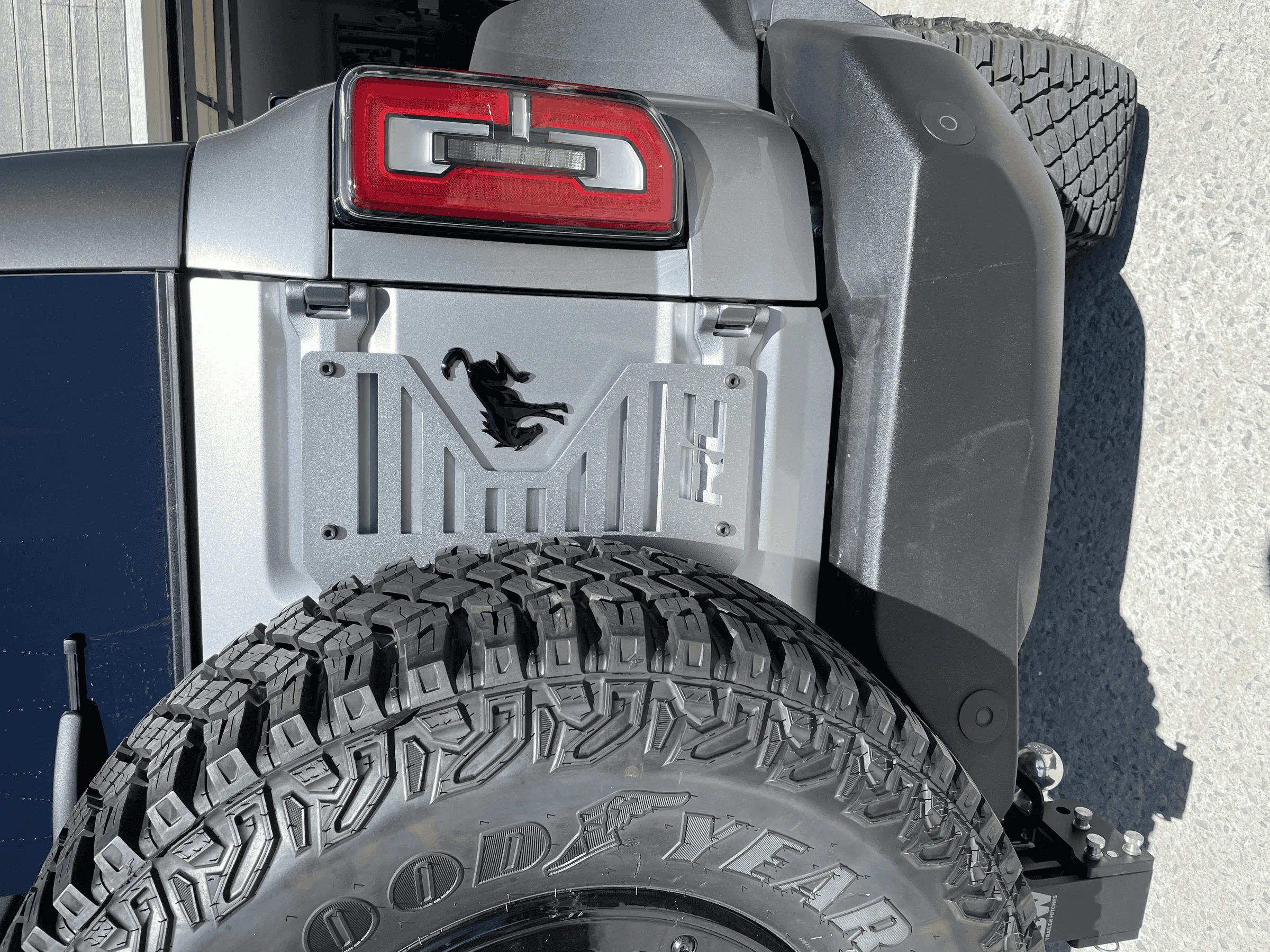

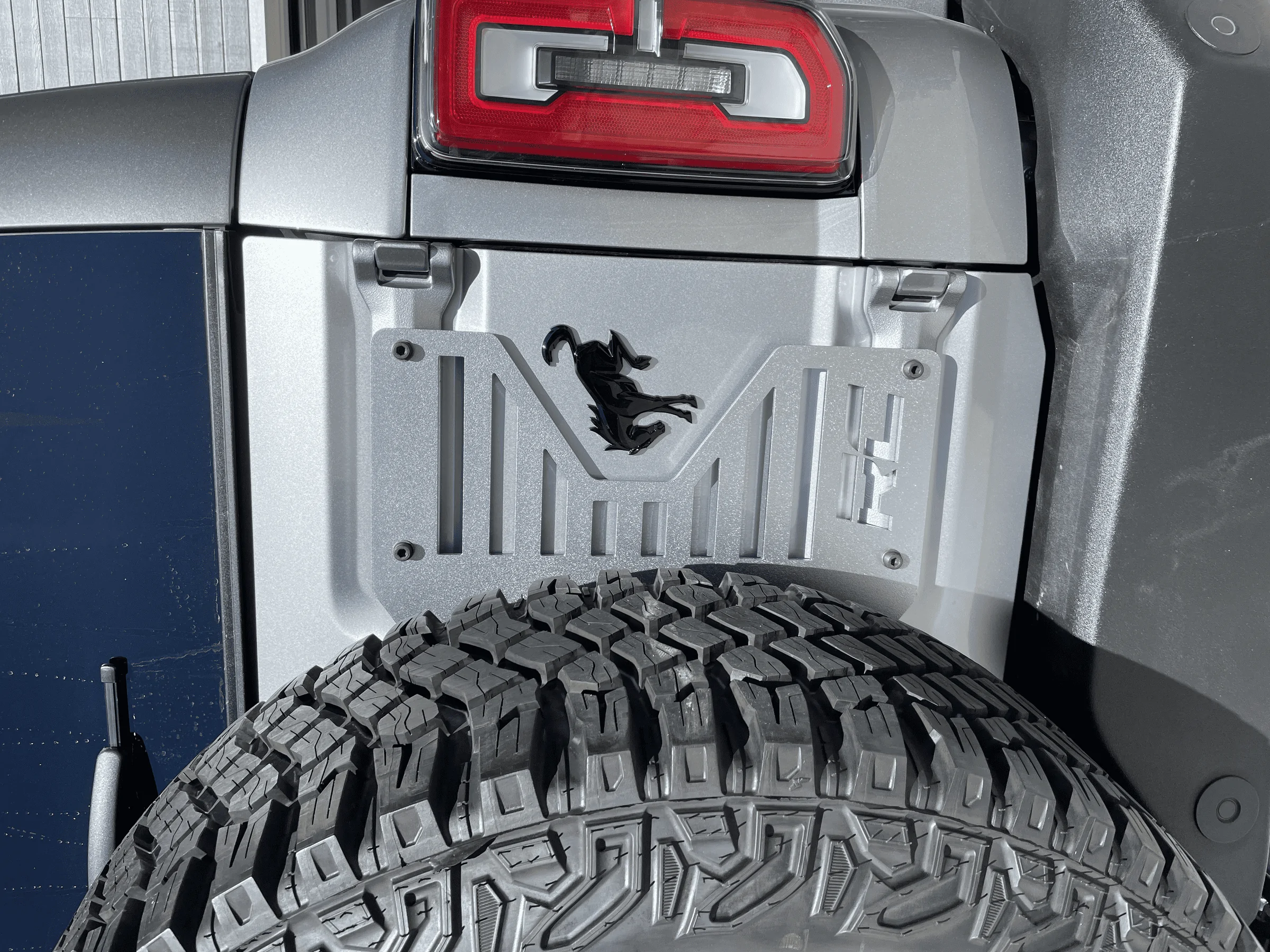

The popping ticking noise was driving me crazy, and yes it did get worse and more frequent. I isolated it to the left center inside the tailgate. Took the spare off and it went away. So I bought the Rough Country tailgate reinforcement bracket and took it to my body shop guy and had it painted to match (Iconic Silver) - $100. I just installed it this morning, and it absolutely fixed all of the tailgate ticking. Not a single tick/pop over multiple roads. A total fix, So excited. I had it painted because I did not want the black contrast against Iconic Silver. Very pleased.

I’m glad that fixed it .. I’m making ford fix mine and then I’ll add the reinforcement. Looks good painted 👍🏼

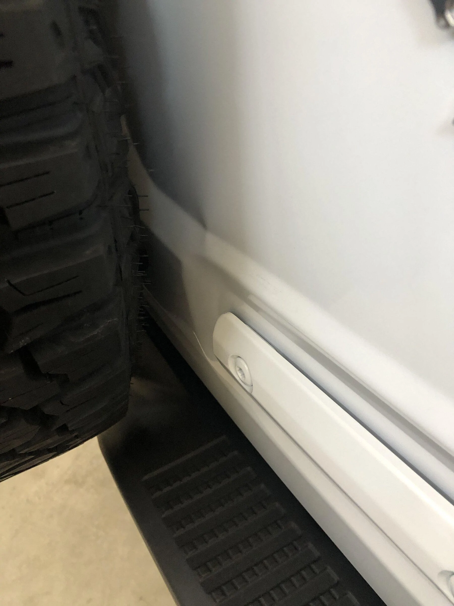

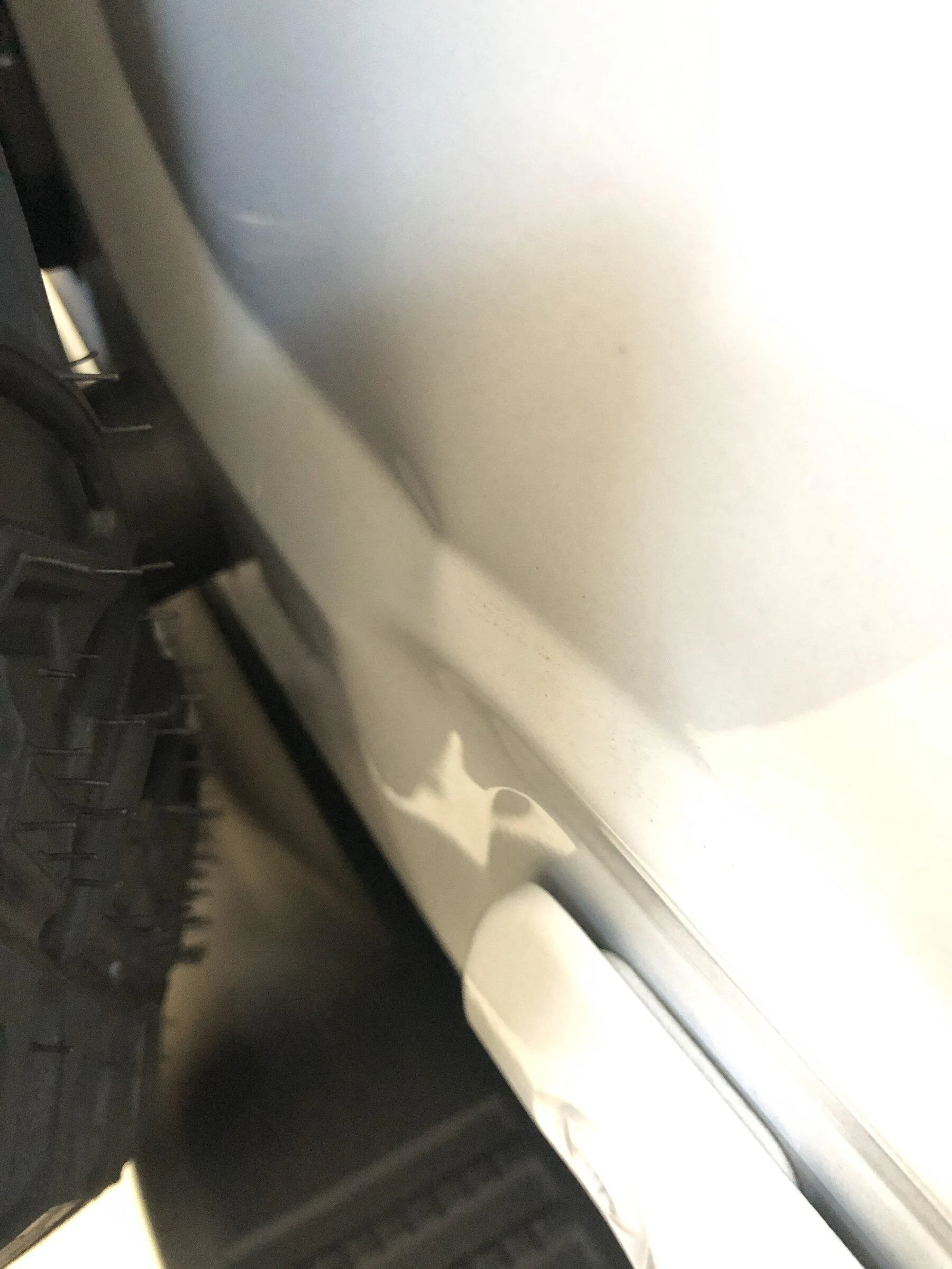

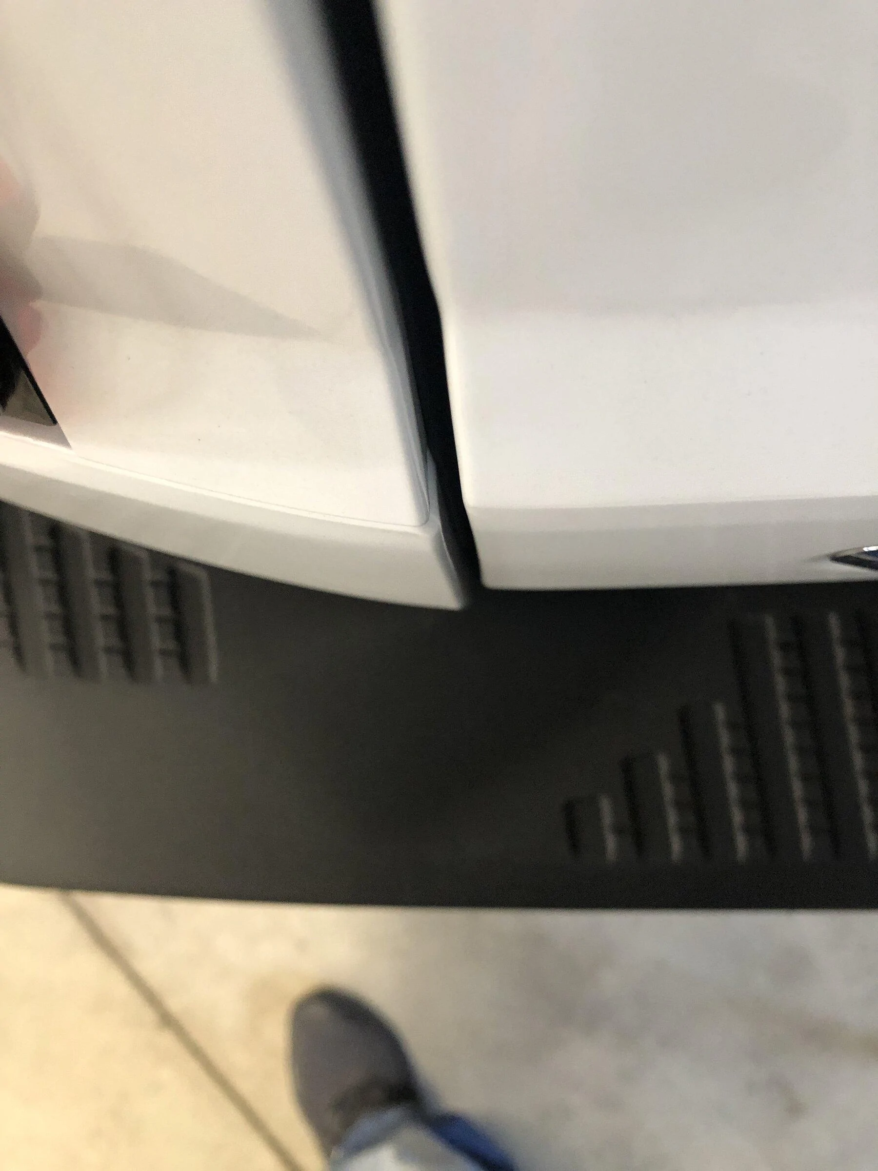

I just wanted to add to the list of issues with the tailgate. Mine started only after 100mi. of around town driving. I have the crease in the same spot as others have, also the tailgate latch side is in on the bottom. I'm also experiencing an annoying metal pop when going over bumps or Colorado cracks in the road. I suppose this is a weakness in the tailgate design supporting the spare tire.
I do have an appointment with the dealer in a couple week and will update. My service provider did not see any report from Ford for the issue but hopefully Ford will address this as more people report issues.
