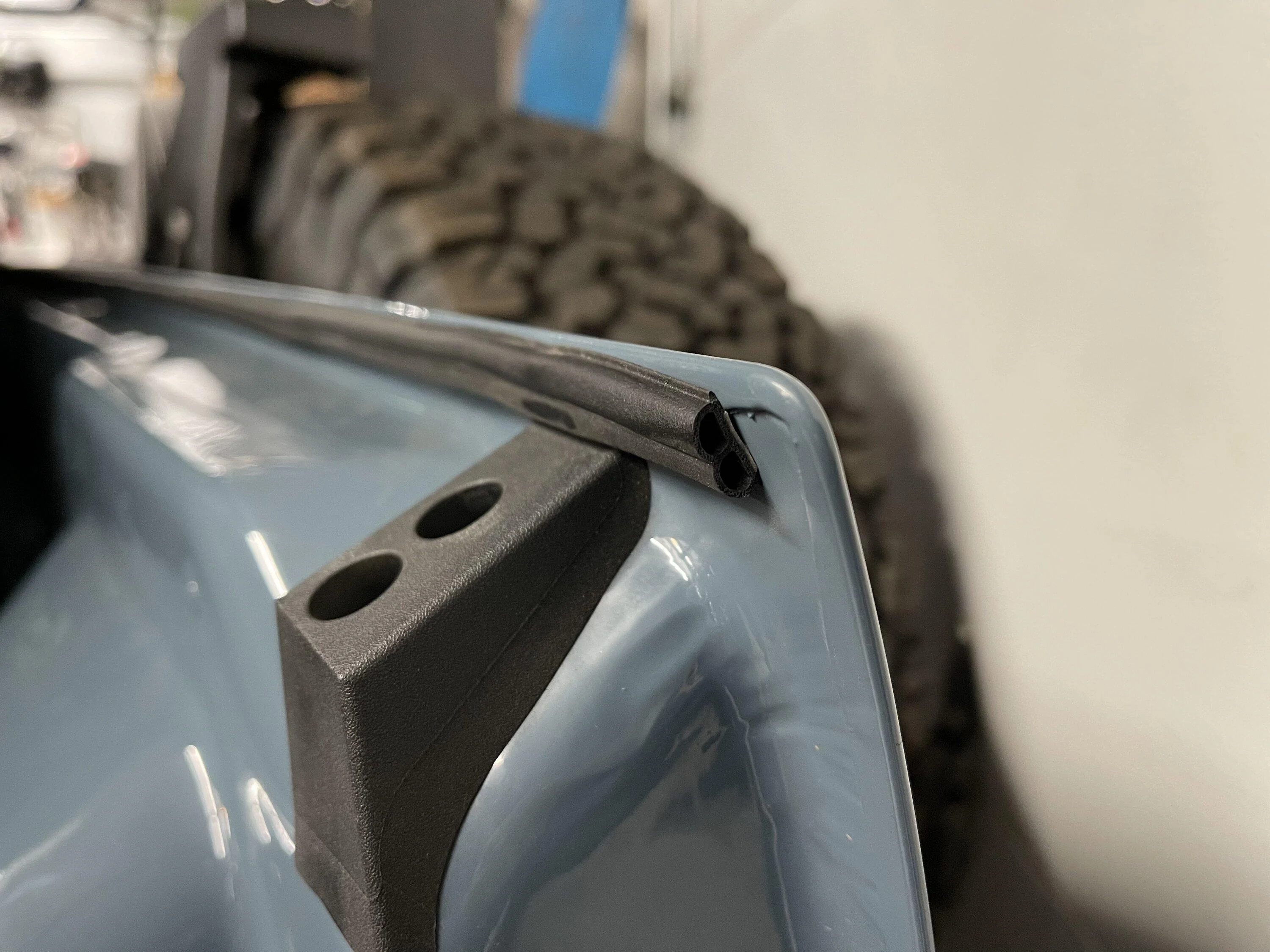

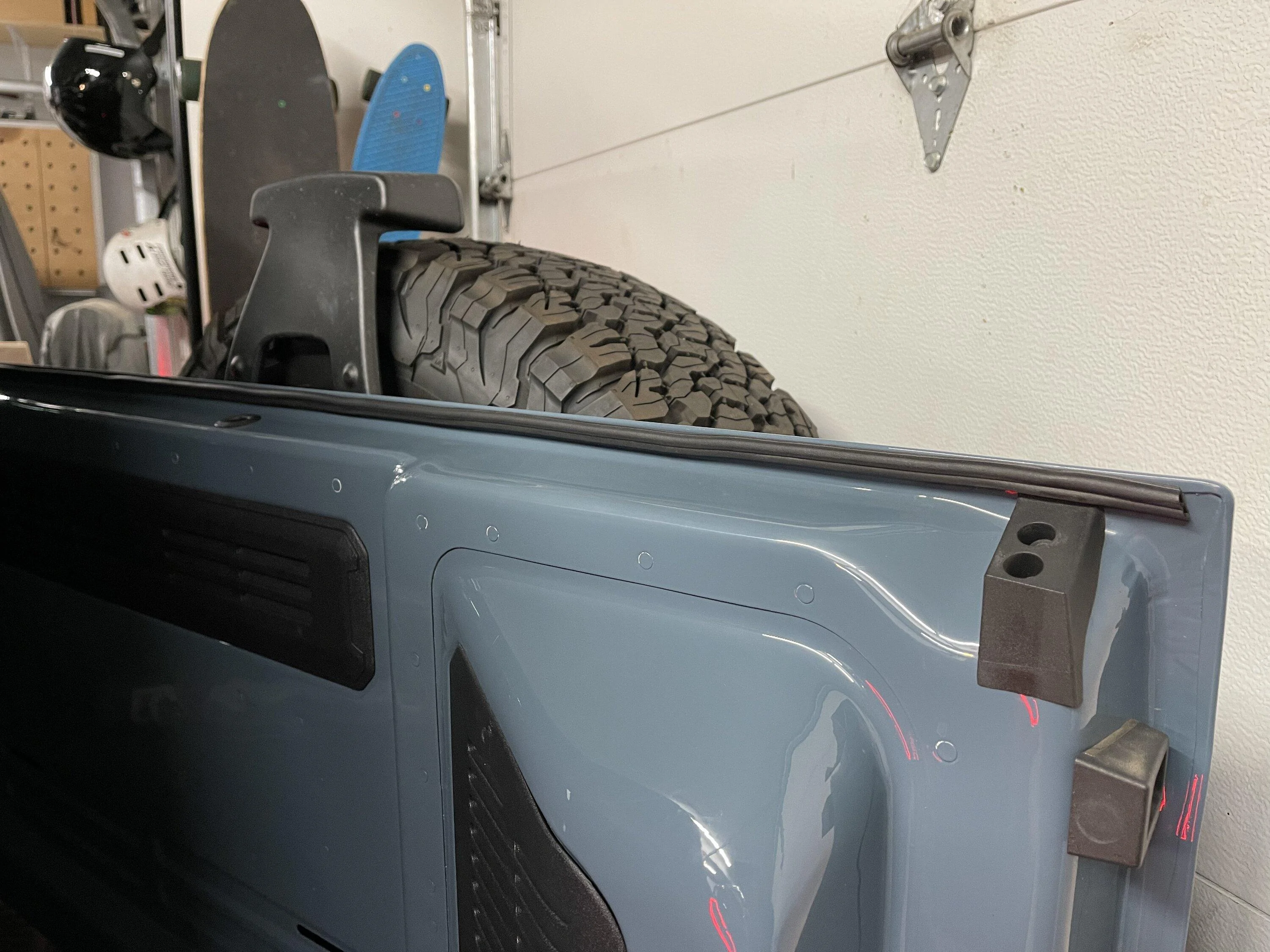

I added a thin rubber gasket to top leading edge where the tailgate meets the window frame and it’s dramatically reduced the hollow rattle sound. I may consider a different type of gasket as I don’t want impact any weather sealing….but it’s a start.

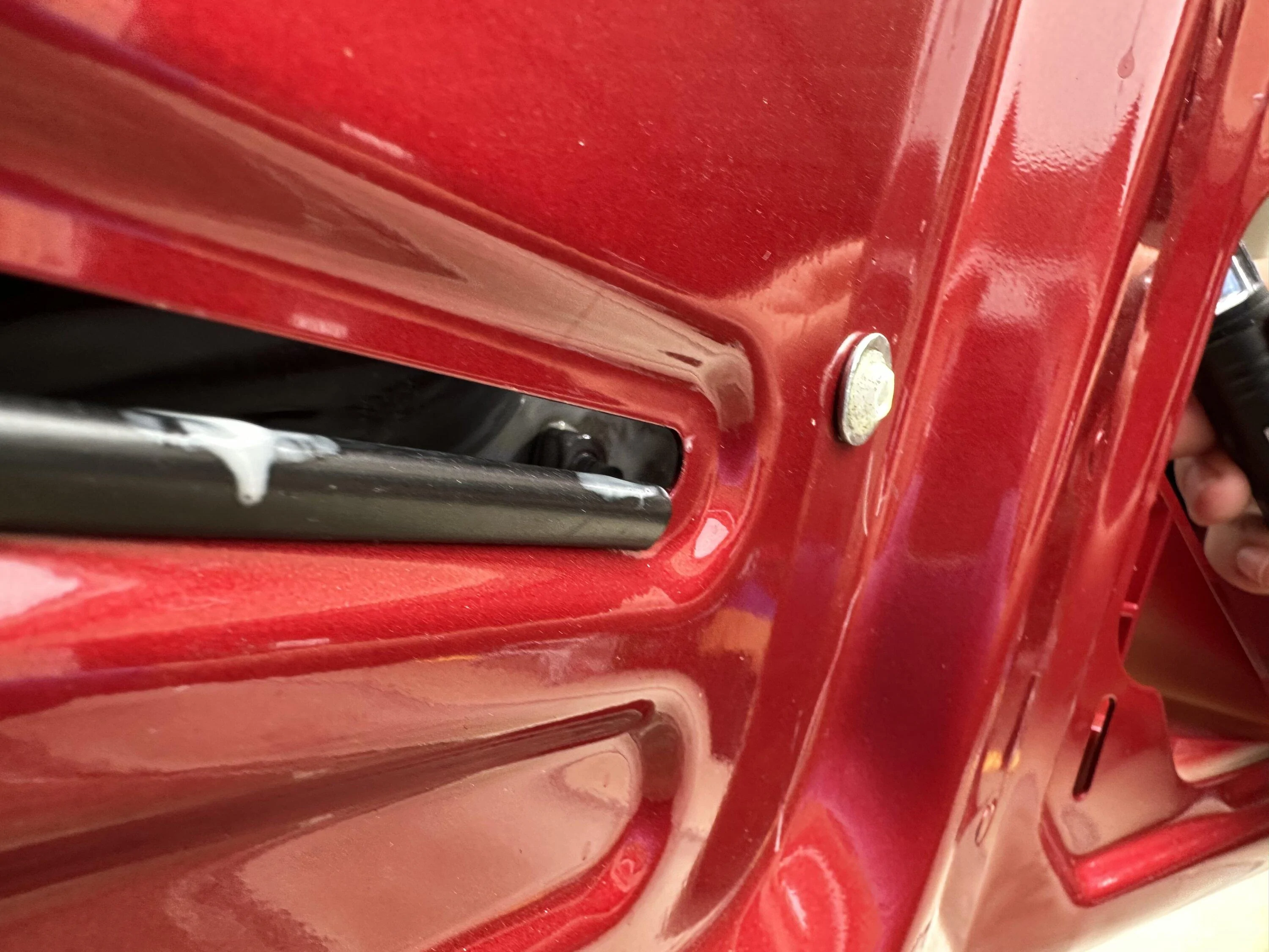

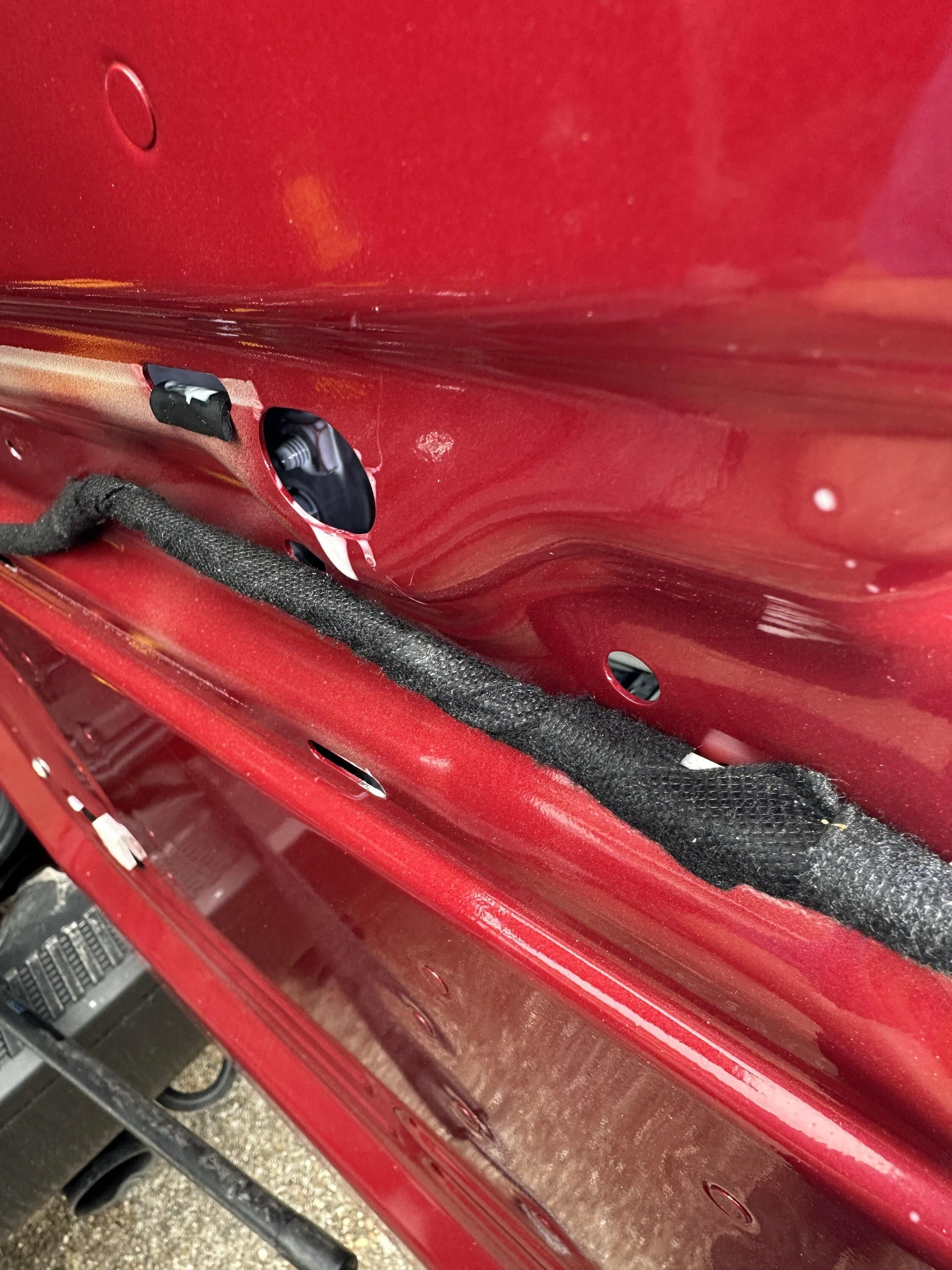

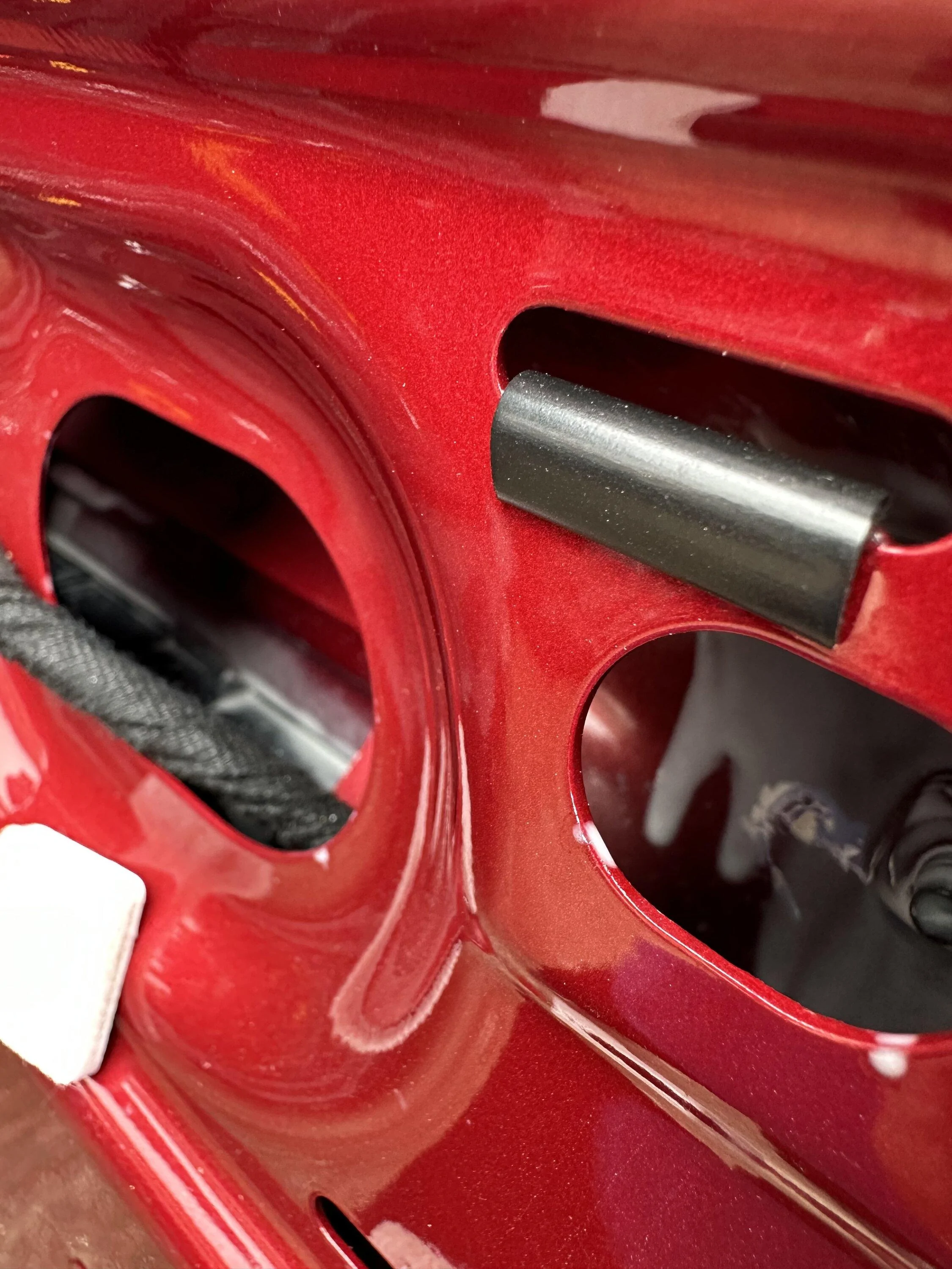

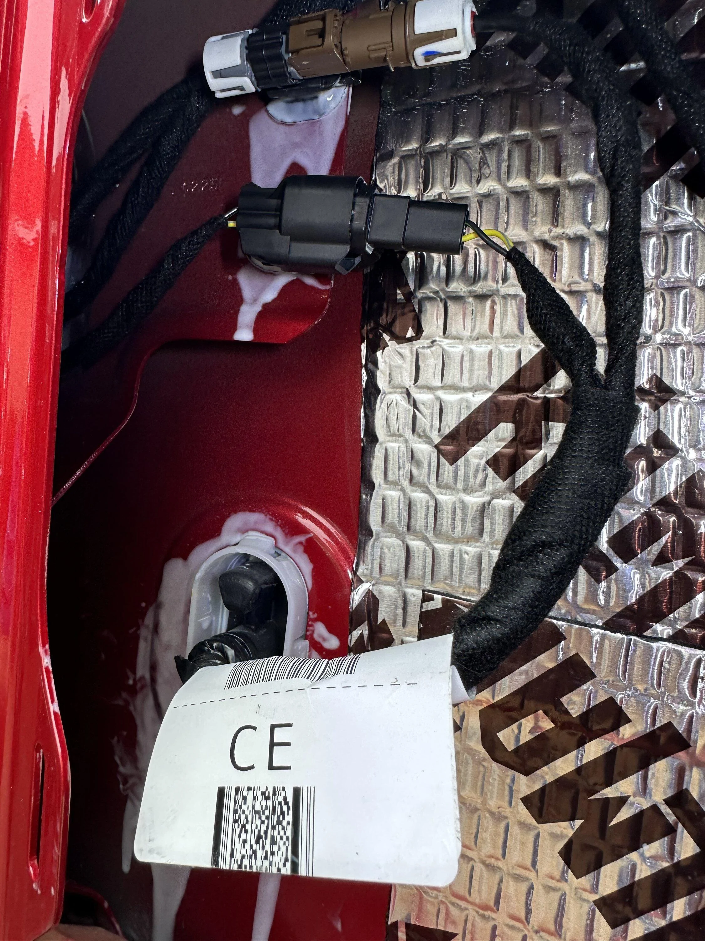

This ridiculous clicking noise was driving us absolutely crazy. It has become very relentless. I decided to give the lube another go. This time I took my tailgate table off and take the time to really investigate the interior with a flashlight, based off of @Patriotic post #185.
Take the accessory cover rectan panel off and it will expose several holes. (My case tailgate table was blocking). Then take off the large vent panel thing off the driver side. This lets you shine the flashlight in from the side and see some of the bolts better. I hit every bolt, and anything else penetrated into the tailgate with WD-40 white lithium splooge. Take your time and use a small flashlight. I think I counted 6 bolts I could see. Here are some I could get pics of.
Ford Bronco Gnarly tailgate rattle 5AC9A15E-9E0A-4D69-B523-99A3FACD4B0C
Ford Bronco Gnarly tailgate rattle 081FBFB9-AA0C-4C50-9F92-61817EB9DA8D
Ford Bronco Gnarly tailgate rattle 3103A87F-3B95-49BB-B90A-5C0FB60A5853
Ford Bronco Gnarly tailgate rattle 3157F514-7A1B-458A-8C2F-B59A26133CBB
Ford Bronco Gnarly tailgate rattle C87F9E02-FBD8-49B3-AB25-189150CDF702
After hitting all that, I decided fuck this and hit every hole on the tailgate with extra splooge for a couple seconds. No pics of that money shot, but it was a mess. Immediately took a drive, and knew before I got out of my neighborhood this is finally fixed. Holy fuck yes. Thanks to all who shared this before. The tick tick tick from hell is finally gone, for now. 🤞🏻

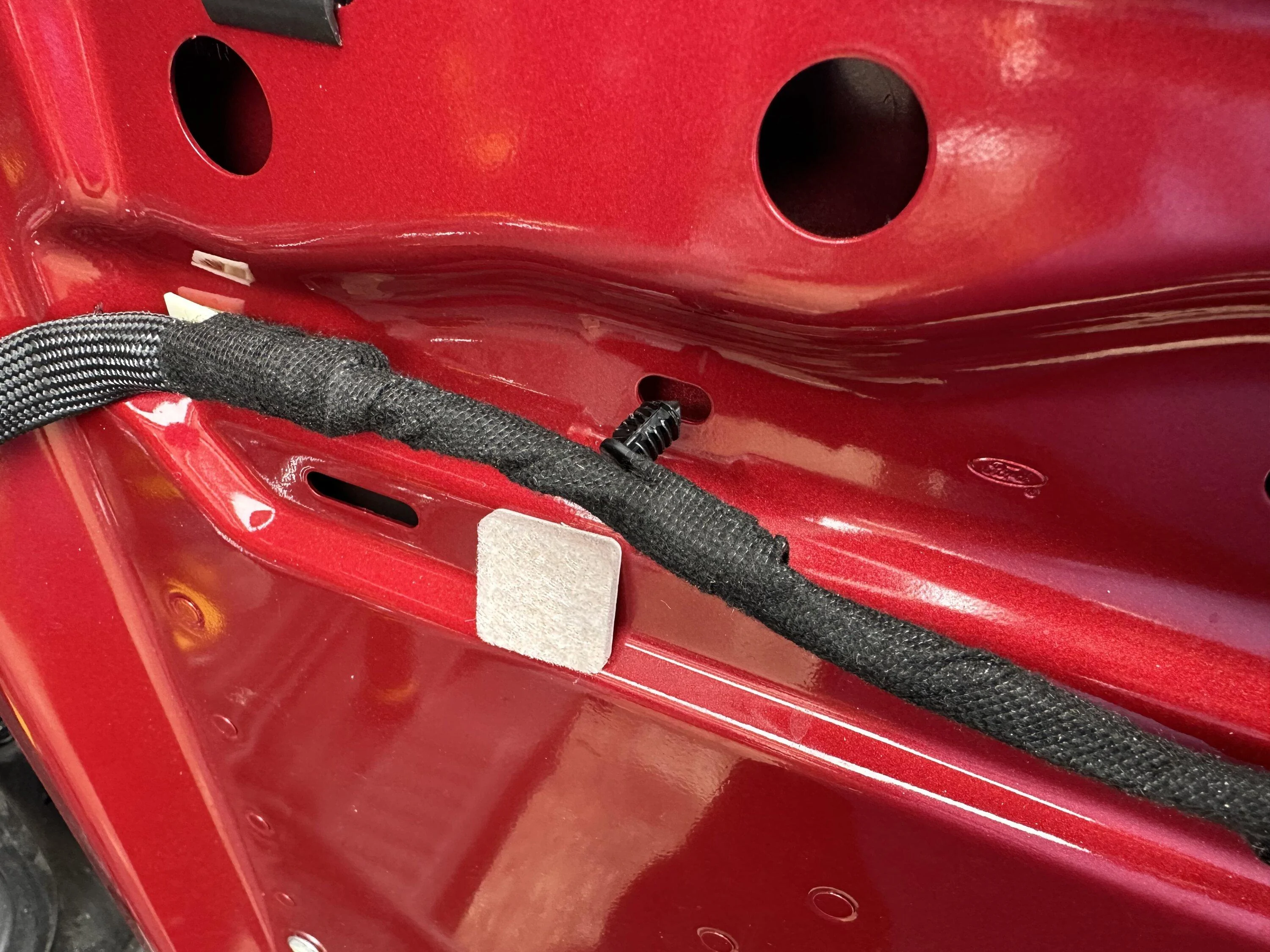

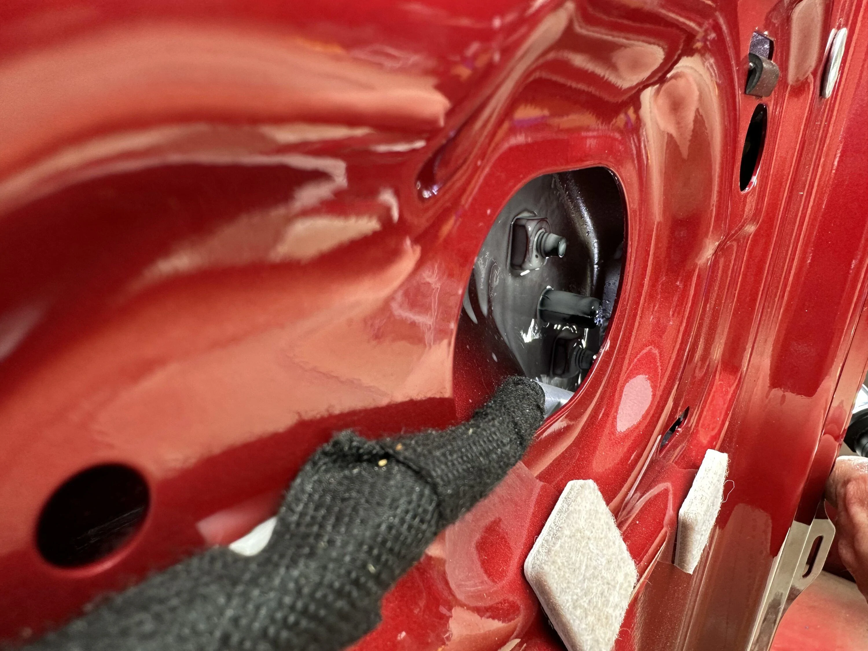

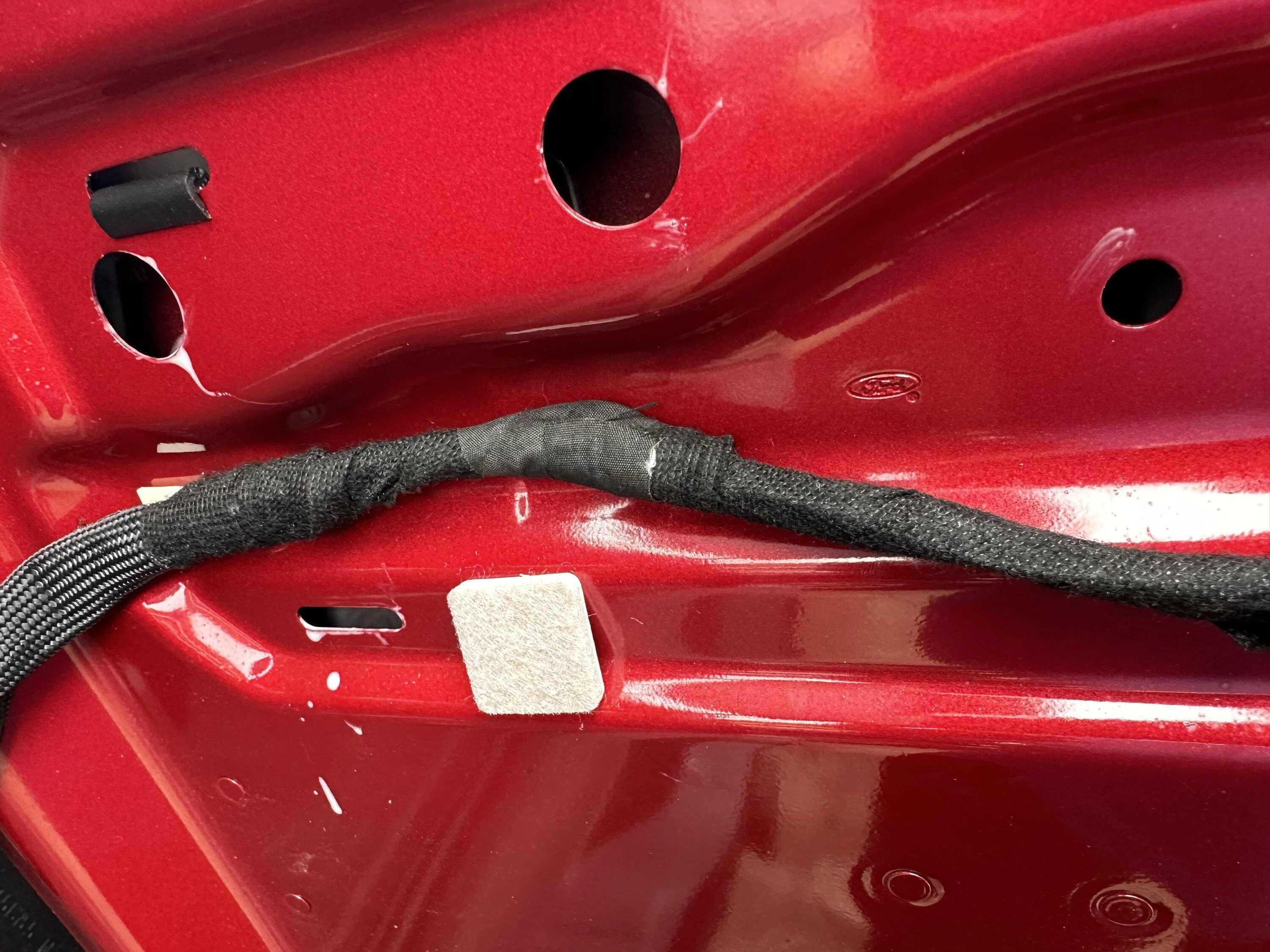

Bonus footage. I found that when I wiggled on the wire loom, one of the “tree” clips made a clicking noise that was VERY similar to the tick I’ve been dealing with. I wrapped the tree itself good in cloth tape, now it fits better and the noise went away. I don’t know if it was my issue, but thought it was worth mentioning.
