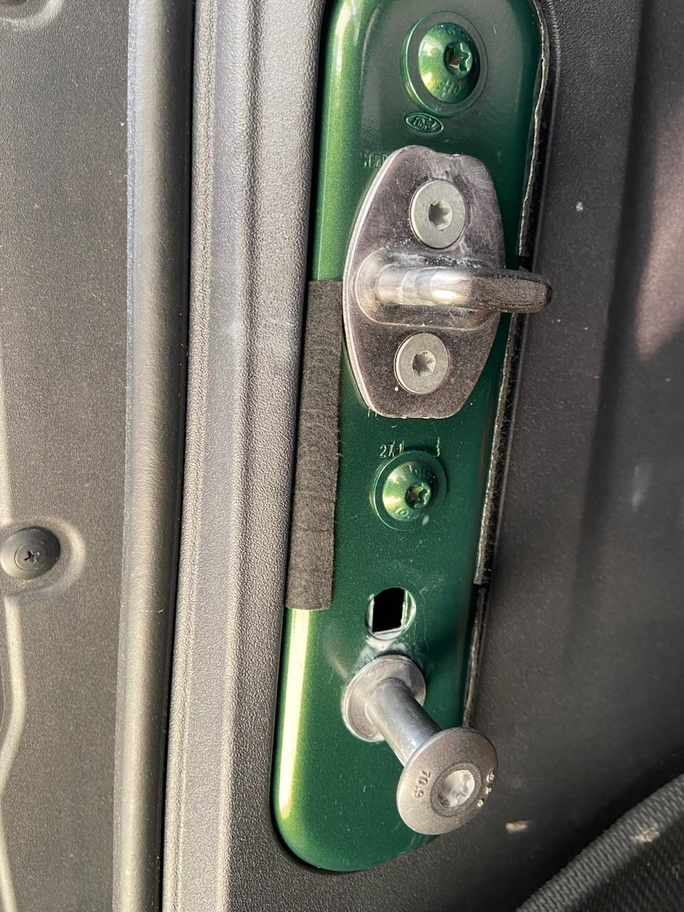

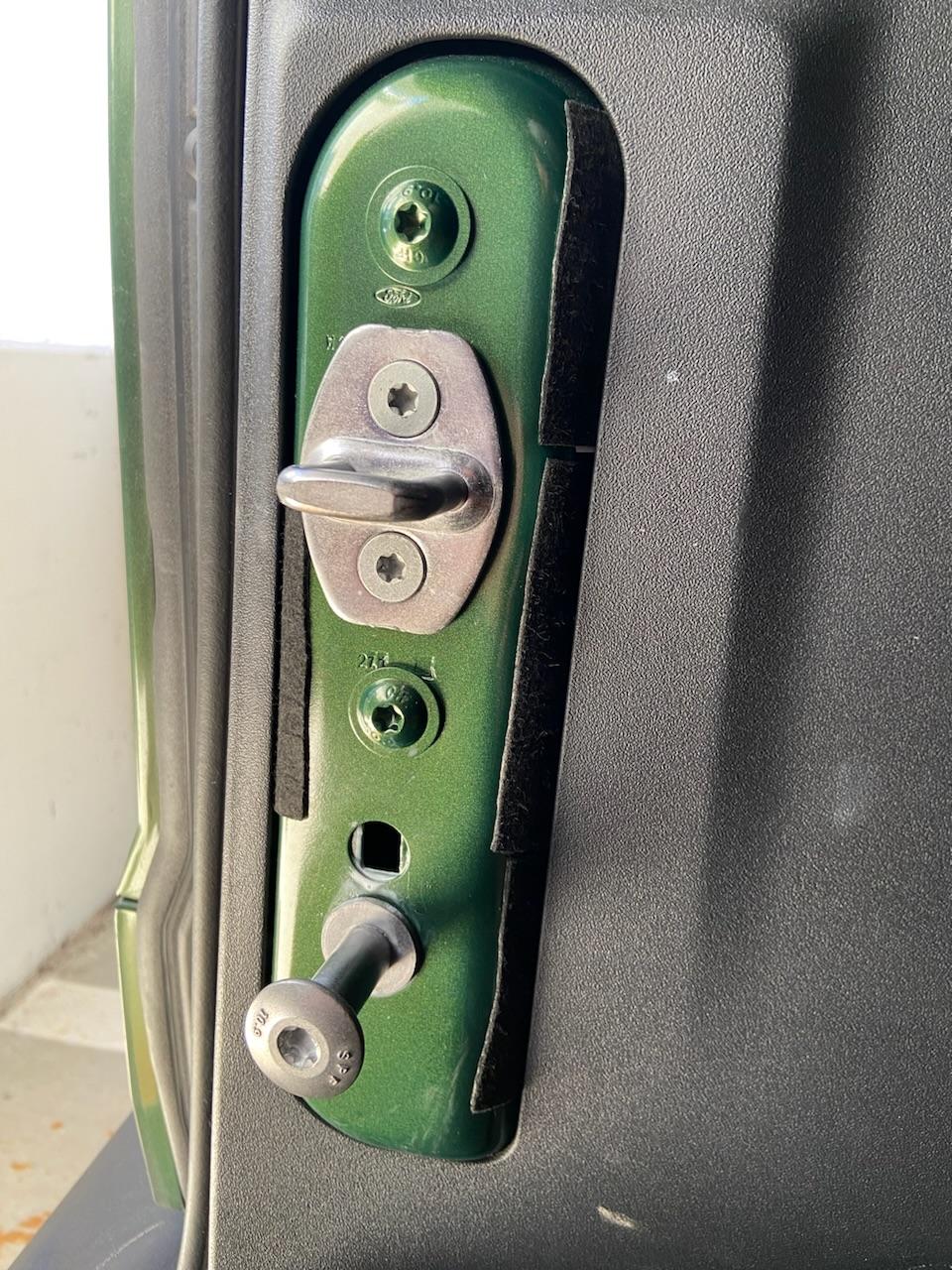

I fixed that damn sound and it has nothing to do with the tailgate itself. I went to the back and just started pushing on random pieces / panels. Lo and behold, when I tapped on the plastic to the right of the latch area, where it meets the body, it made the exact sound I was hearing. I happened to have some felt tape, so I cut it up and shoved multiple pieces in there. The side making the most noise was the inside, towards the cabin. The outer side made little noise but I figured I'd cover it just to be sure. I took it for a test drive and sure enough, it was that plastic panel making that loud ass noise. I'll take it for another drive tomorrow on a bad road to be 100% sure, but I didn't hear it once on the drive I took.

Wow! Thatā€™s awesome, great investigative work! I will get some more felt tape and give that a go. I used up all my rolls on the other rattles šŸ˜‚
