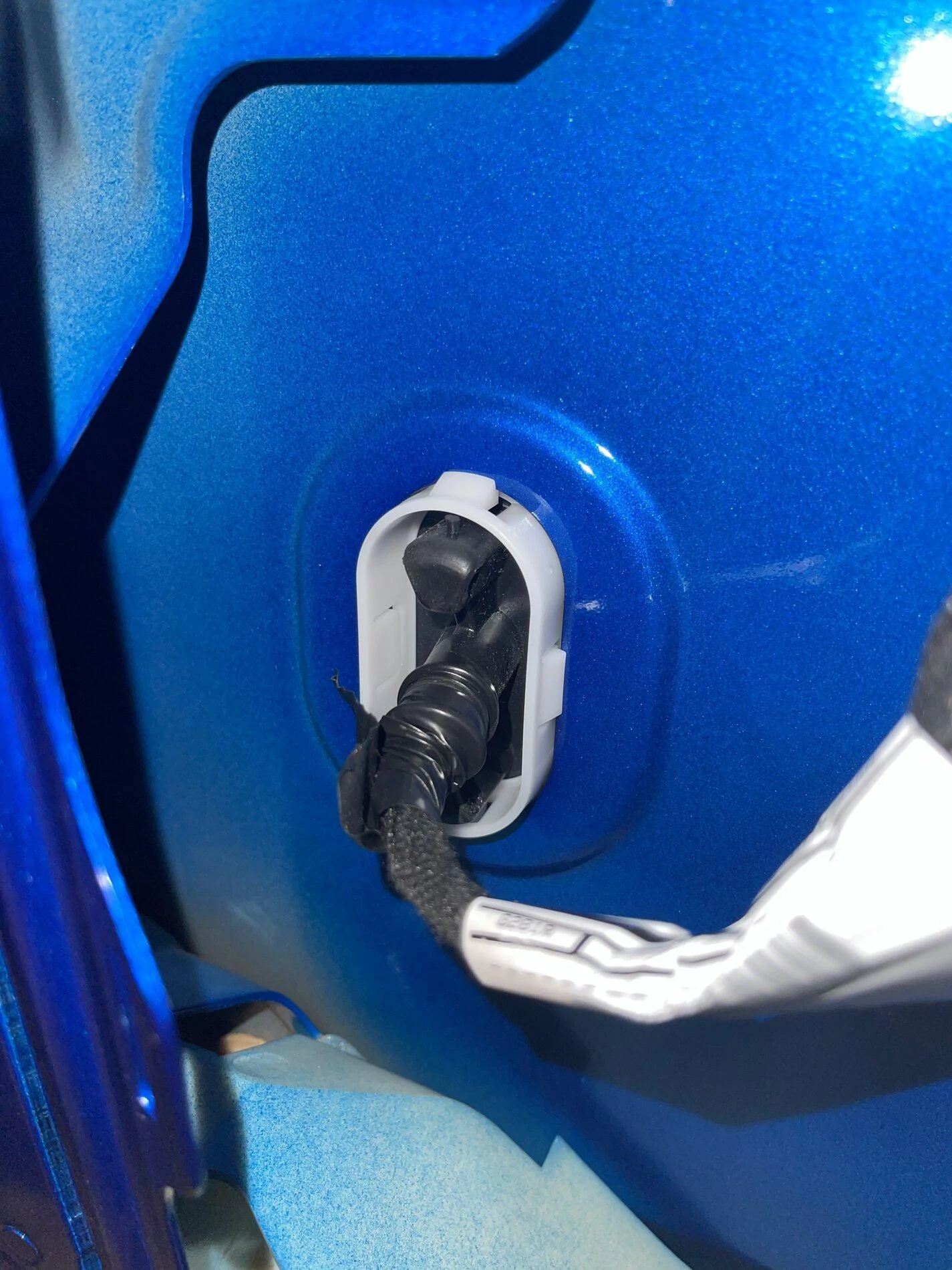

I have your same issue, I took it to the dealer and the thought they fixed it… but they didn’t. After taking apart the rear myself I found the issue. Its the door seal for the camera’s wiring harness. Attached are some pictures of it, and a video of the sound. I‘m still working on a solution to fix it, as I don’t think a replacement part is going to solve the issue. I might make a gasket to press the part on the panel better so it cant make that noise. I’ll do write up if I get the fix down. 👍

At first I definitely thought you were trolling us as it looked like you were tapping on the cargo door for a second lol.
Man, I don’t know how you found out that was the annoying sound. Good for you! Maybe try stuffing a cloth or something in there and drive around? Before you do a permanent “fix” just to make sure it’s the issue.

I had my wife dive me in the back and I could feel it happening. I’m confident this is causing my issue.
I’m first going to try to shorten the harness’s play to see if that helps. I will likely need to make a spacer out of some plastic sheet material to space the back of the plug off the metal removing creating the play in the system.
Right now the plasic press fit on the plug doesn’t put enough pressure on the gate to keep the door seal form moving. That moving is making the noise against the thin door making the tin pop noise.

It needs a cable strain relief like this

WOW! Very impressive detective work. I think you just saved a bunch of folks the headache.

Alright I have some good, bad and better news. I was able to fix that noise from the gasket, and it does help the problem. Just remove the panel, remove the tape & cable tie and shorten it. At that point you just reassemble. The bad news is there is another noise still.
The better new is I think I found the issue. After my last fix for the plug, with the spare removed the noise goes away. However, when I put the spare back on it came back again. After looking into it deeper I think its related to the rubber tire supports on the door. The rubber and the finish sound like they stick together, and when moved make the noise I’m now hearing.
Attached is a video of the noice they make, which sounds like what I’m now hearing. I tried removing them, but they use a body Fastener I’m not use to and don’t seem to want to come off.
They appear as if you just screw them in, but screwing them out didn’t do anything. Before I just drill them, anyone familiar with these or have access to the service repair diagrams or parts diagrams? Parts have been rare on the broncos, so I’d rather not burn a part that has likely has no timeline.
