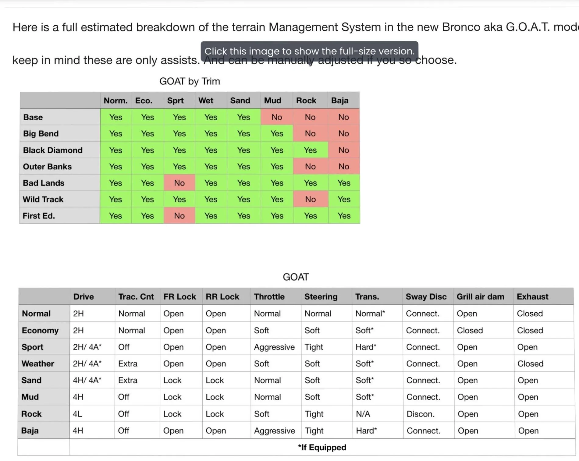

Ford has said that Trail Turn Assist requires the Auto... but... who knows what will change between now and delivery (or even B&P).
Also, here's what I have on the GOAT modes. I honestly don't know the source for this (and it even says "estimated", so I can't speak to its accuracy:
Ford Bronco GOAT and Manual Goat Modes

GOAT modes adjust engine mapping, shift points (auto), ABS thresholds, and from what I understand may automatically control 4wd and possibly lockers.
The only thing I think you'd loose in the 7spd is control of the shift points, obviously.
And, yes trail turn assist and one pedal driving are auto only features.
