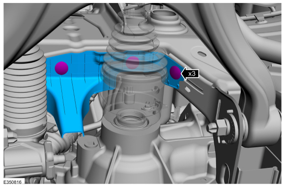

  1. Remove the engine rear undershield.
    Refer to: Engine Rear Undershield (501-02 Front End Body Panels, Removal and Installation).
  1. If equipped.
    Remove the retainers and the front fender splash shield.

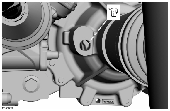

  1. Remove and discard the front differential fill plug.
Ford Bronco {thread} {filename}

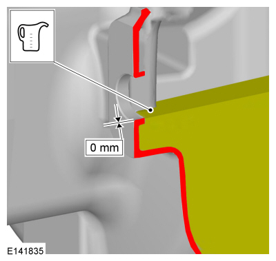

  1. Check and top off the differential with clean differential gear lubricant.
    Material: Motorcraft® SAE 80W-90 Premium Axle Lubricant / Lubrifiant pour essieux de très haute qualité SAE 80W-90 Motorcraft® / CXY-80W90-1L (WSP-M2C197-A)
  1. Make sure the front differential lubricant level should be to the bottom of fluid fill plug opening.

Awesome thank you so much. Is the diff plug an OEM part or can I just get a replacement? I'm familiar with working on vehicles just not well-equipped off-roaders.
Rednek
Jimmy
1,443
3,890
Northern Alberta
2021 Bronco BD/2023 Maverick XLT/02 F150/68 Torino
wouldn't worry too much about the plug on a low millage unit,just use a little blue locktite on threads
