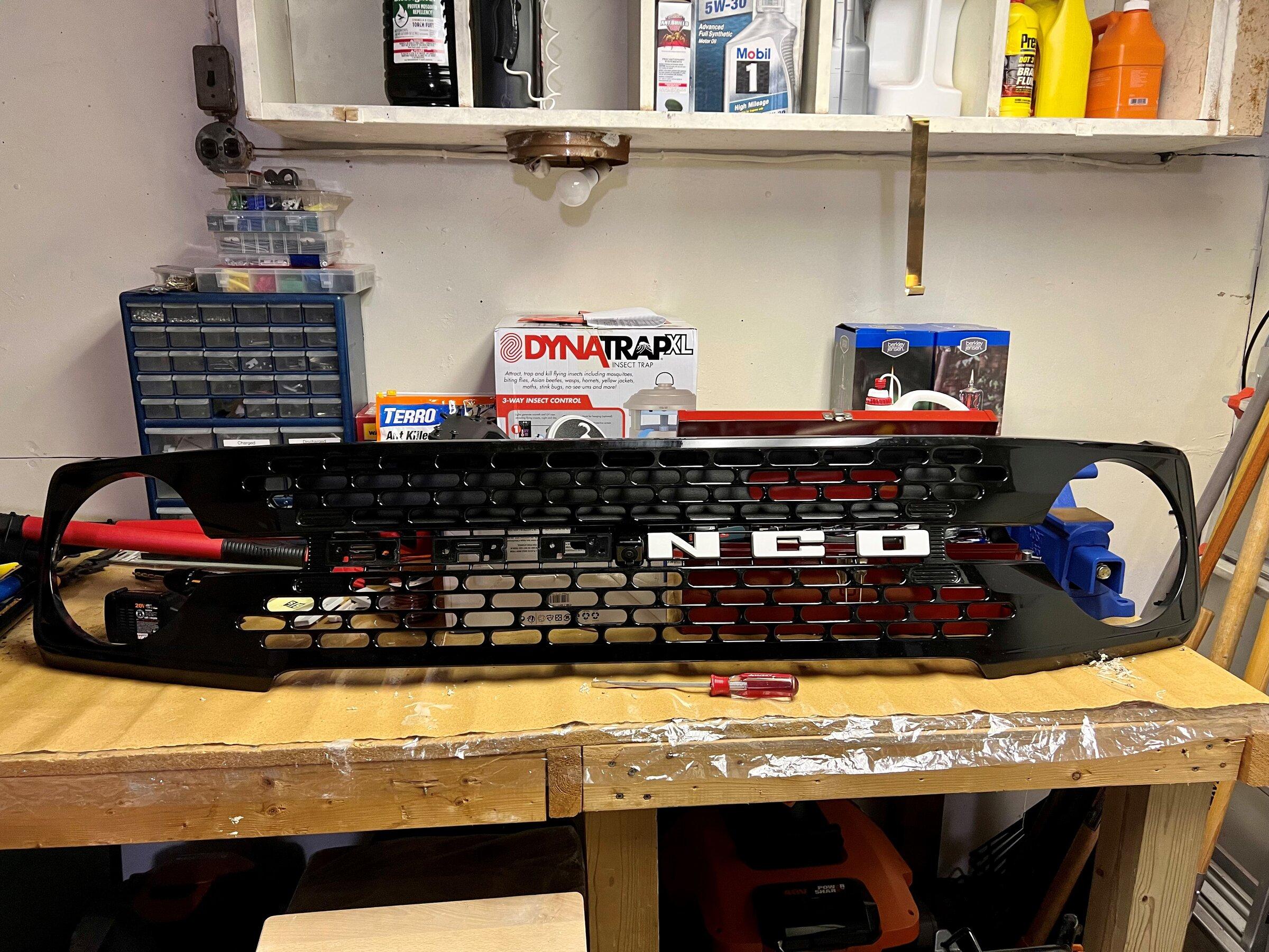

Ford Bronco Grille Letter Removal? grille2
That's a good look at what'll be missing.

They a plasti welded as part of the grille assembly, you would need to use a drill bit and cut/drill where the plastic is melted together on the back side. I was looking into this to put the amber lighted letters on the front of my grillewhen/if my WT ever shows up.
What they said :) there is two posts for each letter that are plasti welded through so there are two circular wholes for those and two or three of the letters also have a third alignment pin whole which is square.
The plastic that is left is basic shape of the letters that go on them they are not as defined but you can tell what letters they actually are.

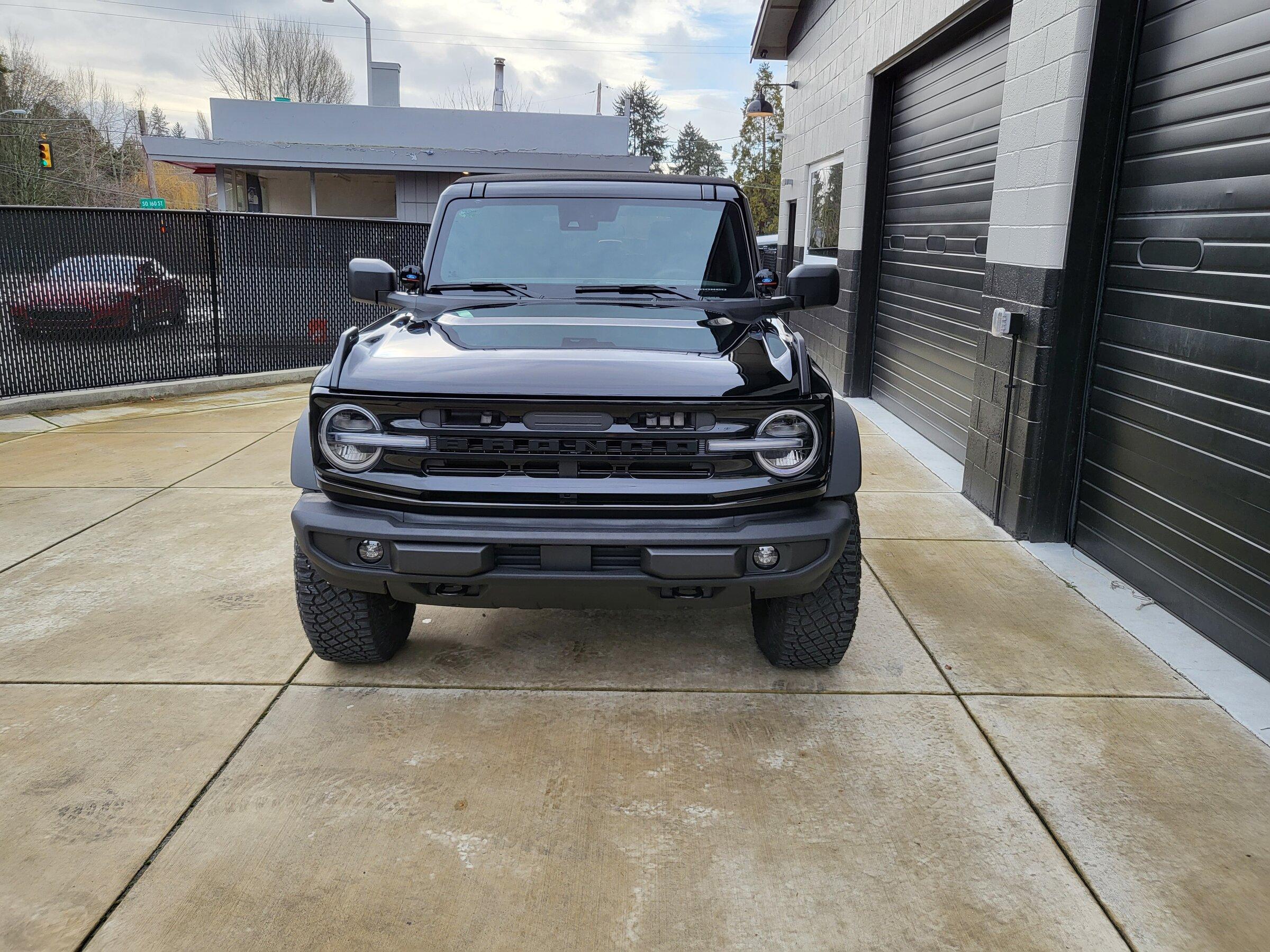

Has anybody removed the letters on their 2021 full-size grille?
Don't want to paint mine black but want the grille to be blacked out. I know they are removable, but are there holes or letter outlines that remain when you do?
Next alternative is to 3D print an overlay panel that just covers them. Then will add an offset Bronco emblem like my old 'stang!
Easy to do. 1/4 inch bit and just drill out the plastic melted in the holes that holds then in place. Painted mine shadow black and did matte black letters. Think I'm going to replace the letter with oracle while light up letters.

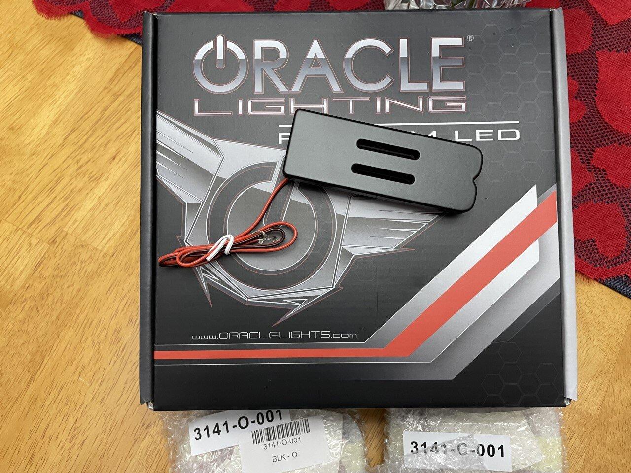

Here's a photo that I took while replacing mine with the Oracle LED ones. It shows the imprint under the letters clearly.

That looks hot. Can you brief me on how you re-inserted the painted letters?
Thank you. Just used a hot glue gun to reinstall it the letters back in the same holes. Easy to take off again if I use a heat gun and remove the letters again. Oracle letters come with 2 sided tape but I think using something like hot glue makes it so dirt can't get behind the letters. Gorilla glue gun on Amazon for around $12.
Ford Bronco Grille Letter Removal? 2021-12-29 19-44-43
Are you happy with the quality of the oracle white letters? Easy to install and wire? I ordered the white letters because I think the black letters have white on the sides and will look strange. My painted matte black letters look great but I think they blend in almost too much. You hooking them to an aux switch?
I actually am happy with the quality of the Oracle lights, I did connect them to Aux 3 and the prerun wire to the grille. It was pretty tough hiding the wiring on the Wildtrak but with some time and patience it's doable and imo totally worth it. The light up lights on the front REALLY pop.
