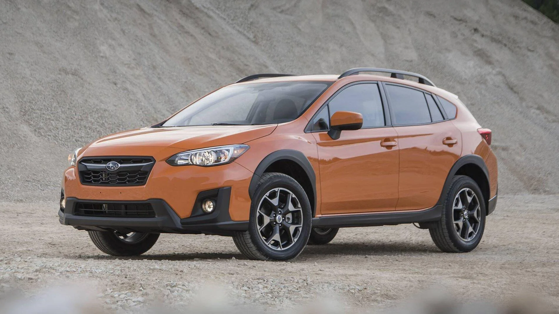

This is nuts. You mean to say that I'll have basically the same ground clearance in A Bronco as I have in my Subaru Crosstrek? This is wild to me.
