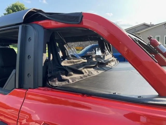

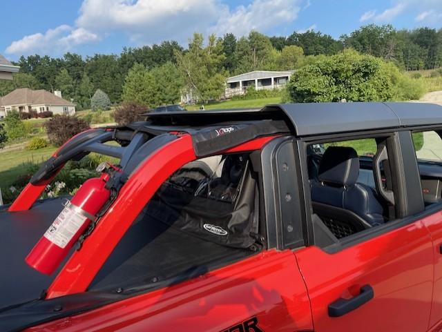

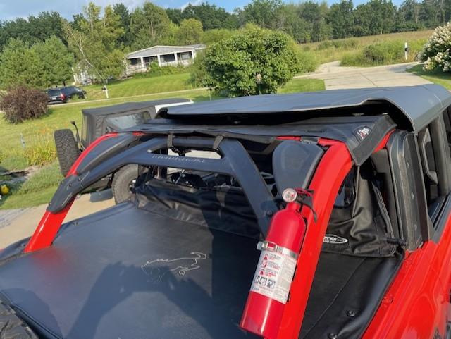

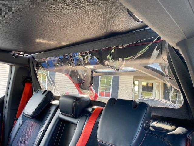

I take my rear clam shell off in spring and don't want to mess with it till fall. The problem is what if it rains...... Best top sells these for jeep so I thought i would make my own.
- I bought a soft topper rear window for a f-150 ( its close but still now a perfect fit on the sides )
- ran 1/2" conduit through the top and bottom to give the window rigidity
- used my existing ford accessory tonneau cover I attached it to the bottom of the window with wire ties
The top of the window just rests on top of the frame and I can drop it down behind the rear seats if I don't need it. The speakers are outside but not much you can do about that and their relatively waterproof.
