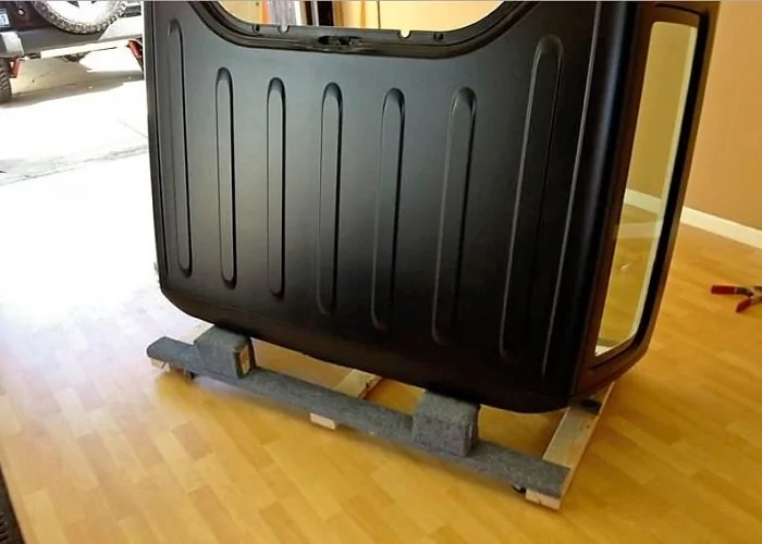

If have the room to store the top on the floor and have the manpower to get the top off manually, you can build a dolly to store your hard top on, keeping it off the ground and easily moved out of the way.
Ford Bronco Hard Top Storage Options 113426-115032
Source: https://www.jk-forum.com/how-tos/a/jeep-wrangler-jk-how-to-make-a-hard-top-cart-407361

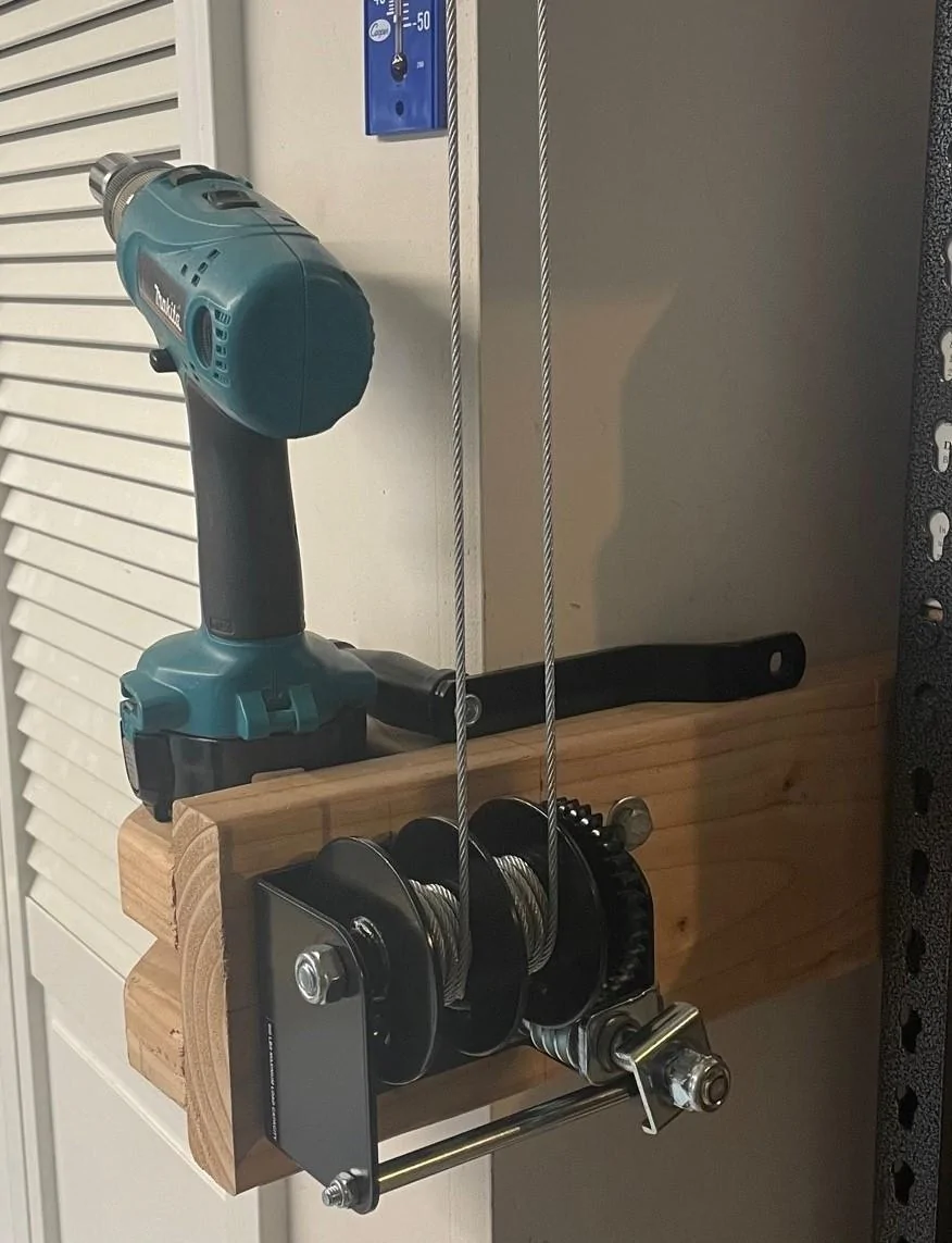

I installed the hoist-a-top system for our 4dr wrangler jk and it works great. Just make sure to use a stud finder to to drill in the pieces of 2x6 with good 3.5ā€ screws into the ceiling and back wall. You donā€™t need the electric wench, just a drill with a 3/4ā€ socket you probably already have, instead of the hand crank. I found it for $200 2 years ago, but $250 and using a drill and socket you probably already have is the best bang for your buck.
https://langeoriginals.com/products/hoist-a-top-crank-jk-2-4-door-2007-up
My guess is that it will be compatible with the bronco top, unless the bronco top is significantly wider.

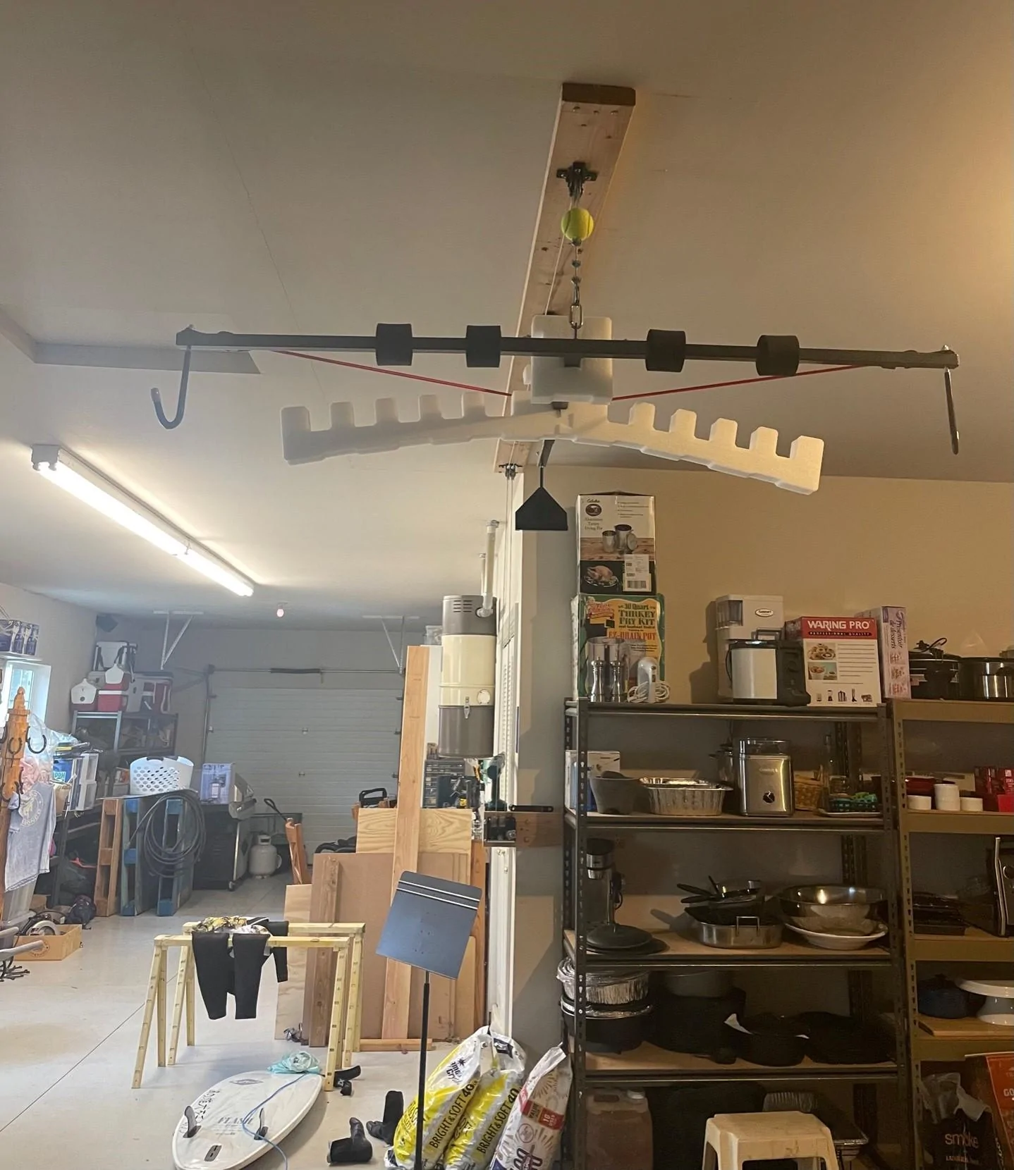

I use the Hoist-a-Top as well, and works great. And don't need to buy the electric version, just take off the handle and use a drill with a 3/4" socket.
Ford Bronco Hard Top Storage Options hoist1
Ford Bronco Hard Top Storage Options hoist2 (2)
**EDIT** And just noticed my old Bronco t-shirt hanging on the left side of the top photo... just waiting for the new horse in the stable!
