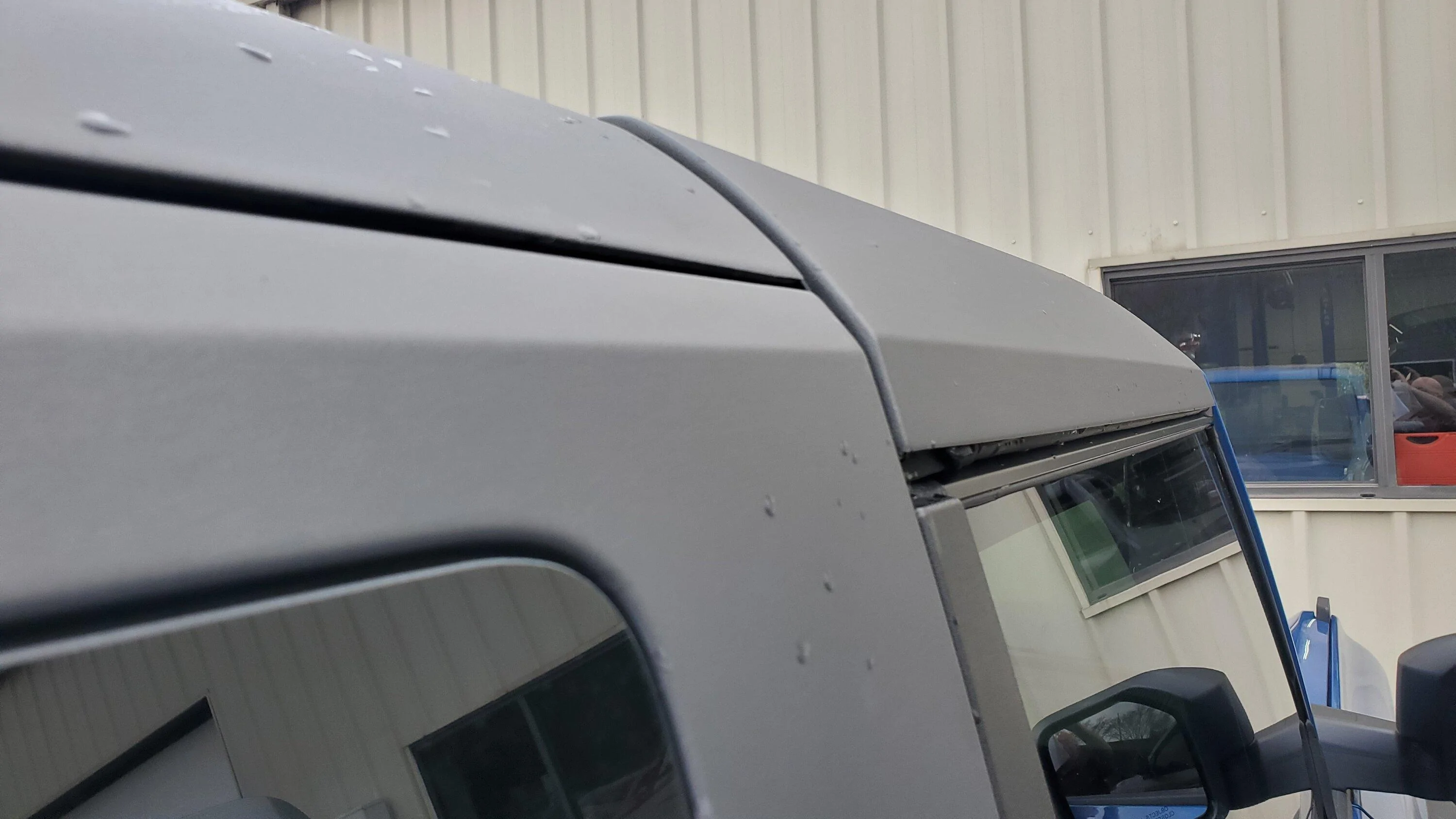

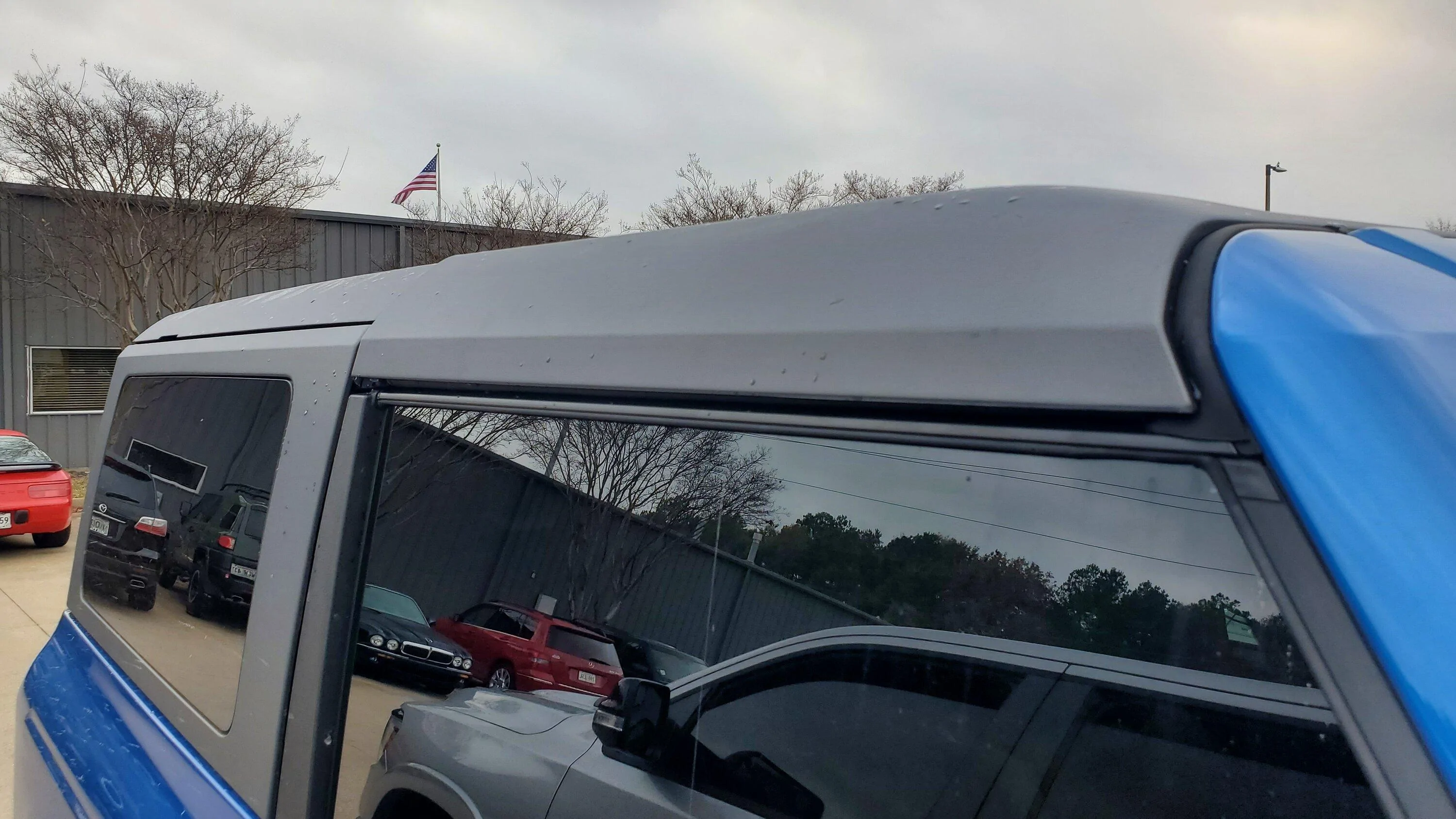

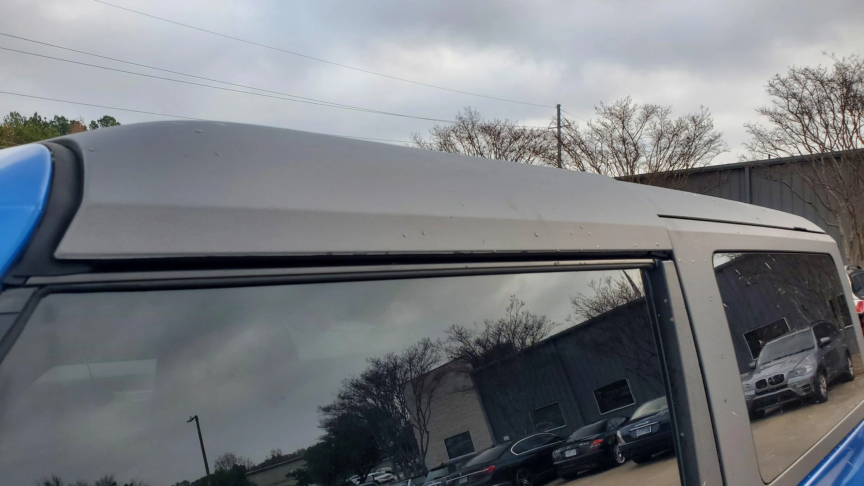

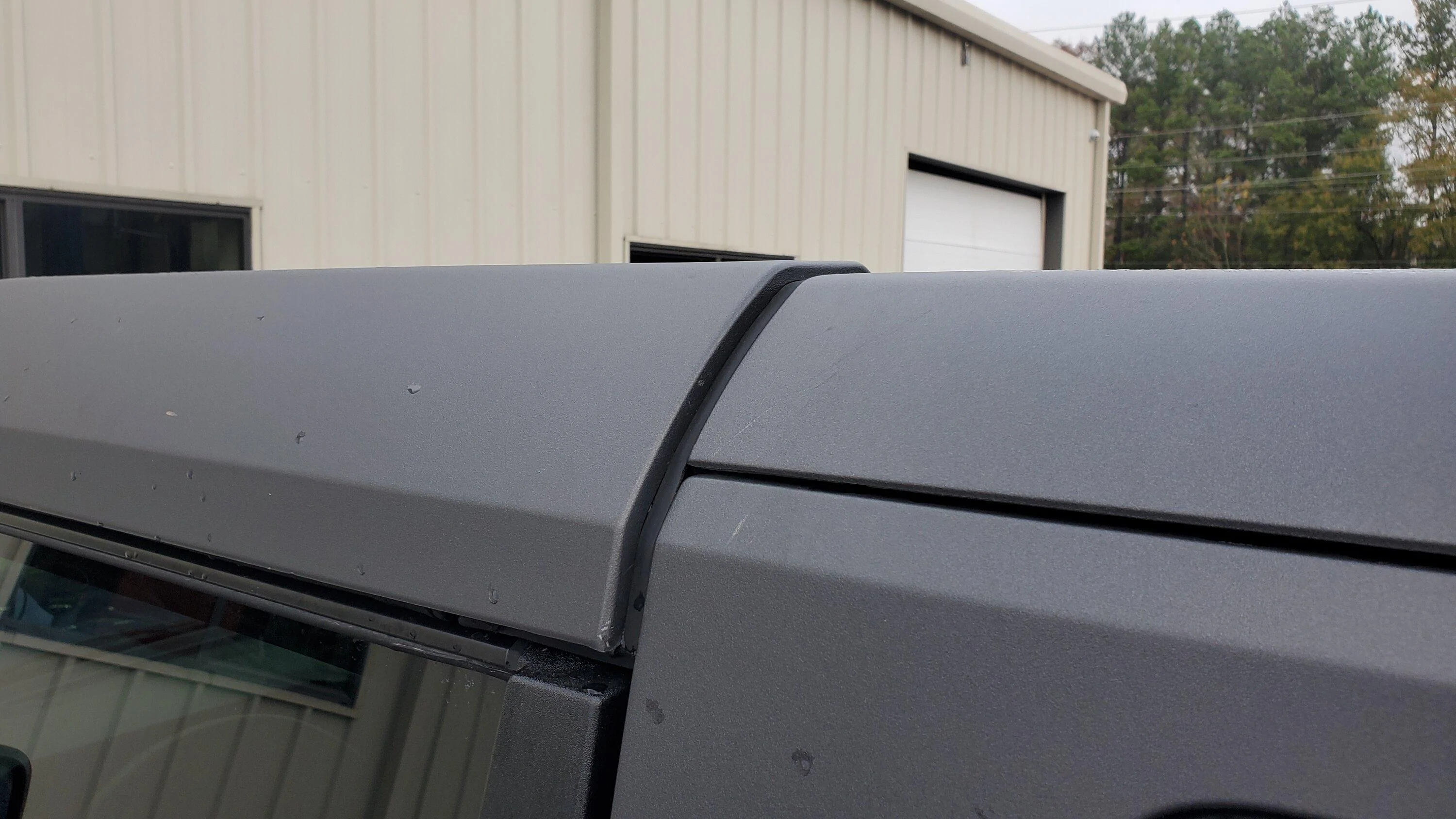

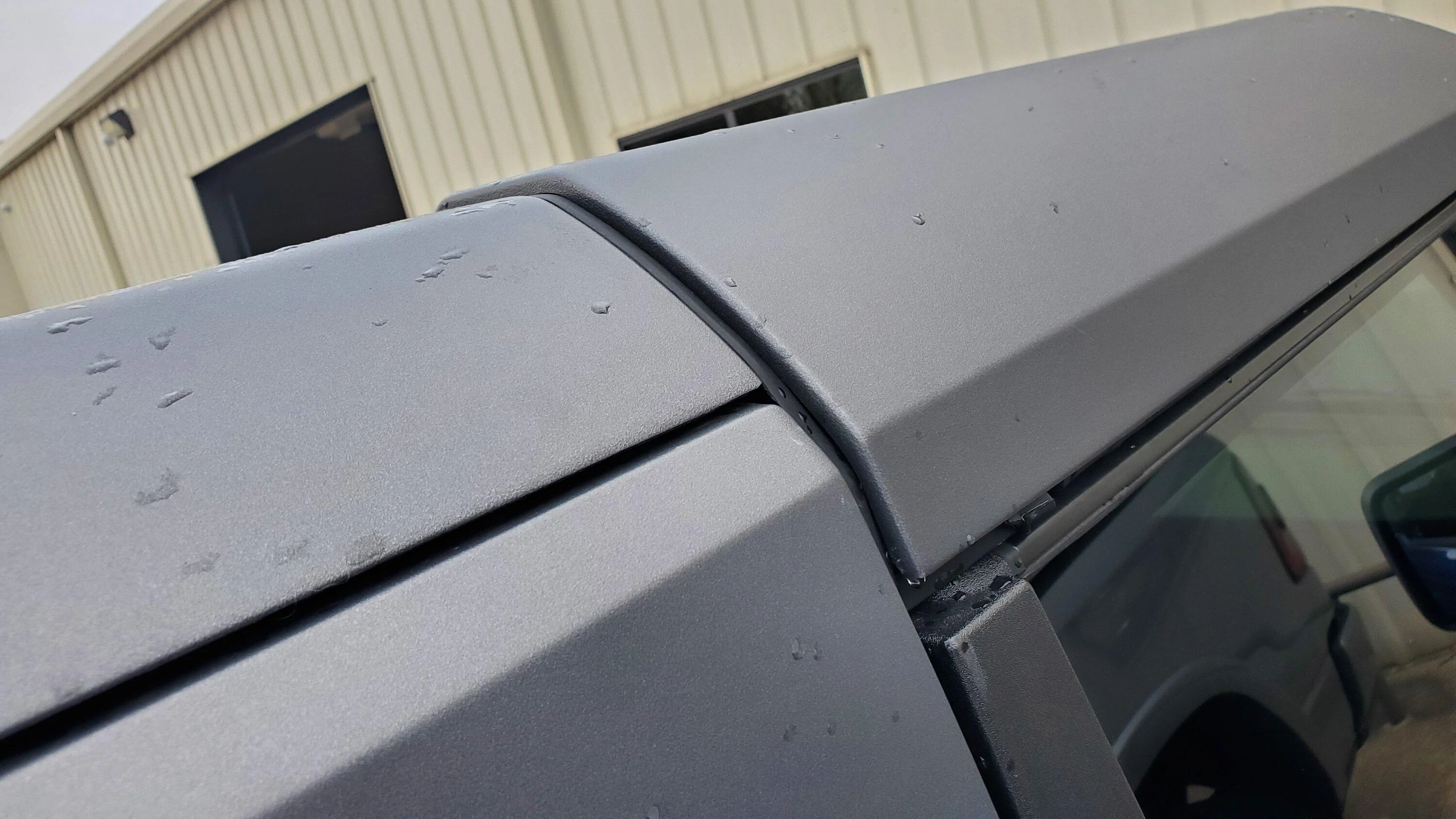

Since day 1 Ive alignment and wind noise issues.. Front panels dont sit flush and I can actually feel air between the 2 panels above the passenger seat. My dealer has attempted to adjust the top a couple times only to make it worse. Its currently in the shop now being readjusted back to how it was. If I shine a flashlight from the outside rear corner where the front panel meets the clamshell I can see light on the inside. Theyre basically telling me thats just how its designed and theres nothing else they can do. Ive already messaged Ford on here and waiting for a reply but curious if anyone has had similar issues and what results did you get.

I have a two door as wellā€¦.even same color. Mine does not sit flush either, but more so than yours. I canā€™t see gap light nor any leaks. Because they do overlap eachother and sit on a lip from the other panels; I would think it canā€™t sit totally flush. But light through no no no

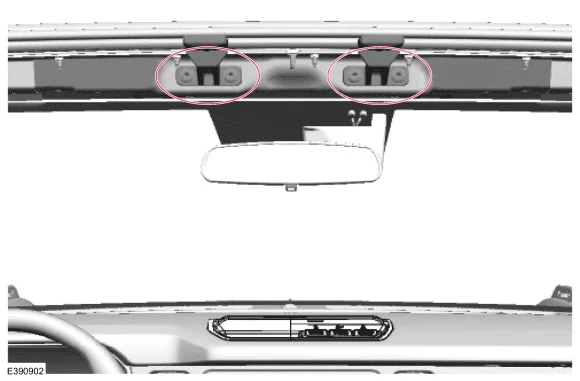

Sorry to hear. It looks like Ford has a TSB on thisā€¦
July 21, 2022
MANUFACTURER COMMUNICATION NUMBER: TSB 22-2288
Components: STRUCTURE
NHTSA ID Number: 10216460
Manufacturer Communication Number: TSB 22-2288
Summary
Some 2021-2022 Bronco vehicles equipped with a hard top roof may exhibit symptoms from the front roof panels that sit at an uneven height which may result in a poor appearance, excessive wind noise, water leaks and/or difficulty latching. This may be due to incorrect vertical adjustment of the front roof panel latch strikers. To correct this condition, follow the Service Procedure to adjust the front panel latch strikers.

My dealer has tried that. It brings the front latches down. My problem is the rear latches. They did this and it actually caused my front left panel to bind and not release from the front inner alignment pin and its currently back at the shop getting fixed. The way I see it is if they pull the front down thats gonna raise the rear so thats countering my issue.
