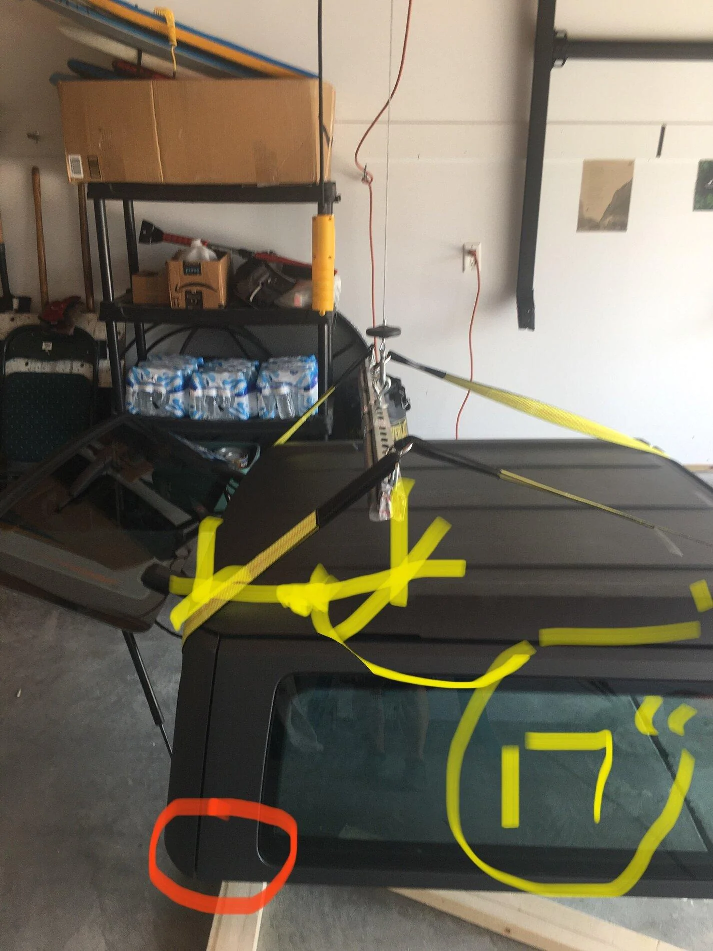

So I do it with a crane setup. I got one like this for $80 awhile back. All in cost was about $120 with decent lifting straps.
The key to this is that the MIC bottom mounting flange near the back glass flares in about 2" (Circled in Red in these photos. ) At this point it is damn near the width of the roll bar. You need to make sure when lifting straight up that you hold the top horizontally to the back a few inches and your are dead level. ( there is a photo of a 6G member breaking this flange. Can easly see this could cause it )
I had some unistrut and made a spreader bar to keep the straps in position and not rocking.
In the front the MIC top seems weak at the rolled corners, so it looks best to keep the straps on the flat section. As for the back, you need to keep them to the outside edge to avoid the wiring and washer lines.
This photo shows the weight center is about 17" from the back.
With the front panels off, you can stand on the seats while running the crane. Once you clear the locating pins, just give the top a push to the back while lifting.
First run is best to have help and mark the Bronco's location on the floor. Keep adjusting until you find it dead level and perfect from side to side. Otherwise will screw up the roll bar paint.

Dude - nice set up. I was thinking of setting up a manual pulley from my hoops net and using a similar strap set up. Any "watch outs" other than the flange? since I'd pull it by hand I would probably feel the flange snag if it got hung up.
Thanks- The various videos I have seen don't state it but there are Torque setting for the mounting flange as well as roof rack bolts. My owner's manual shows 15 lb/ft for the clam shell flange- 7.7 lb/ft for the rack mounting bolts and 5.9 lb/ft for the mounting bolt cover.
