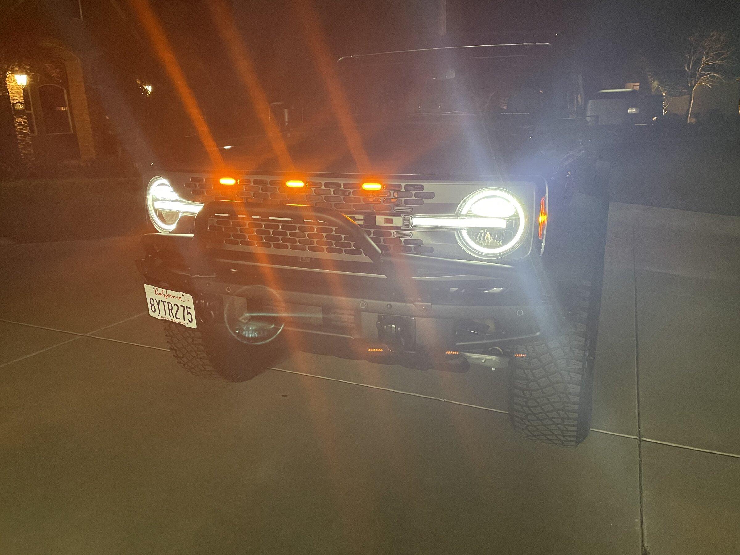

Ordered last week, received today and installed....easy install as described, made harder by my JCR Offroad pre-runner hoop (self-inflicted)...and the fact that install video calls to be plugged into fuse slot 21, which at least on my loaded Badlands is empty but also void of fuse slot, so I ended up using slot 65: Upfitter Aux #6, which works out in case I want to switch It off. FWIW their test mule in the video is a Wildtrak which I am going to assume makes a difference in the fuse box. Overall I like it, easy DIY clean install.

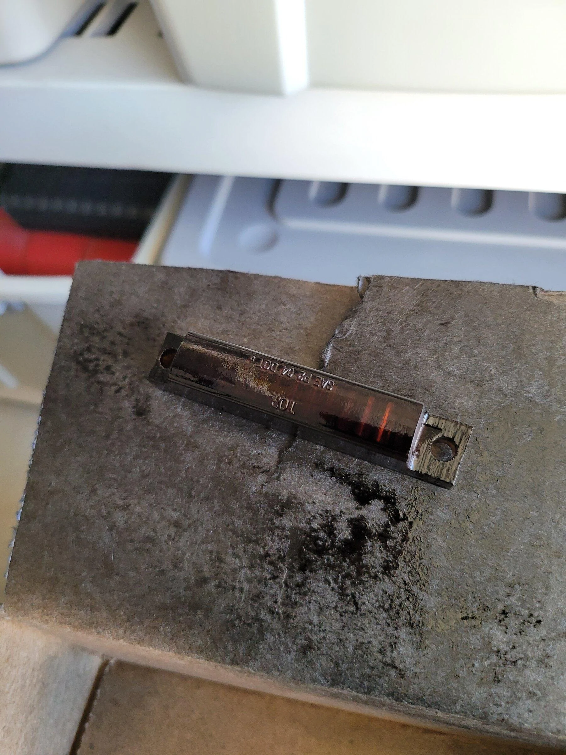

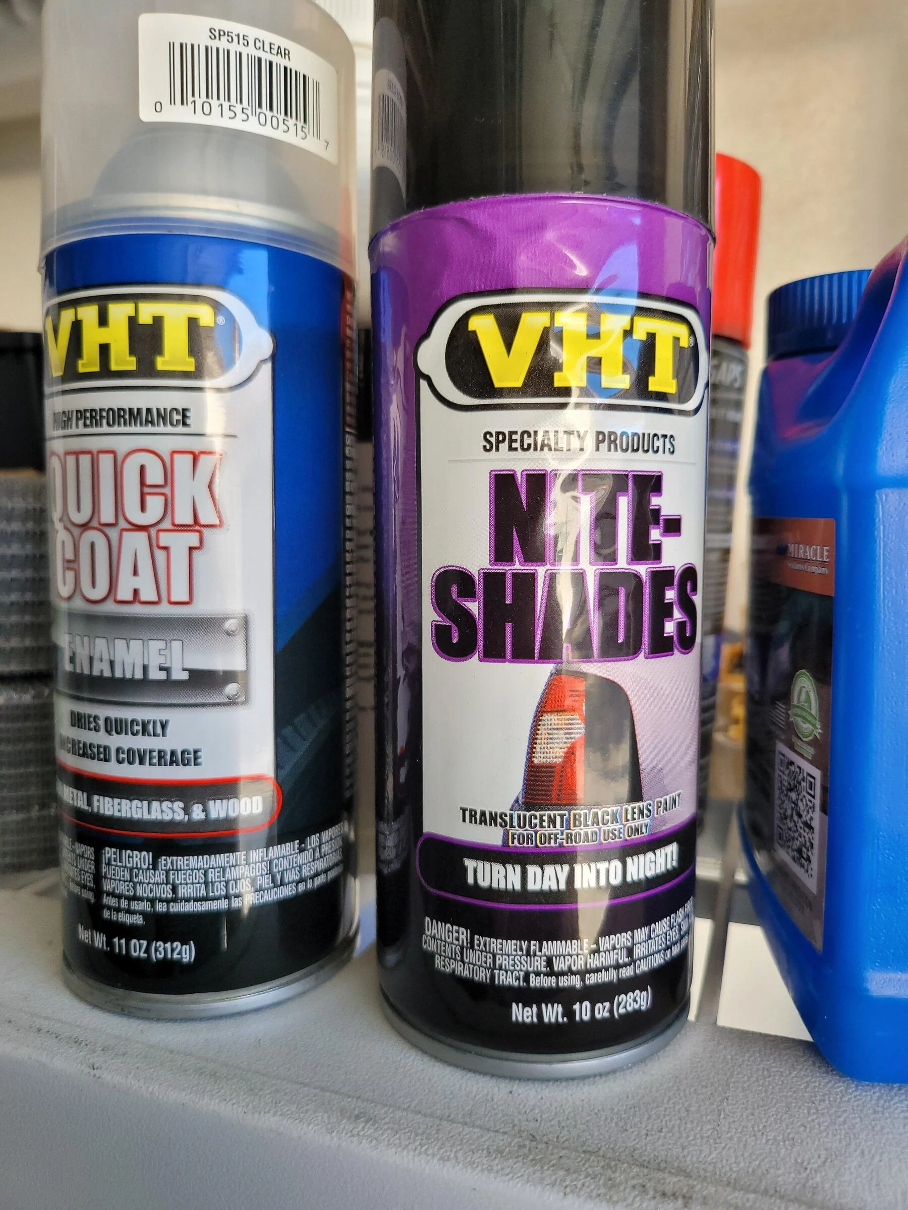

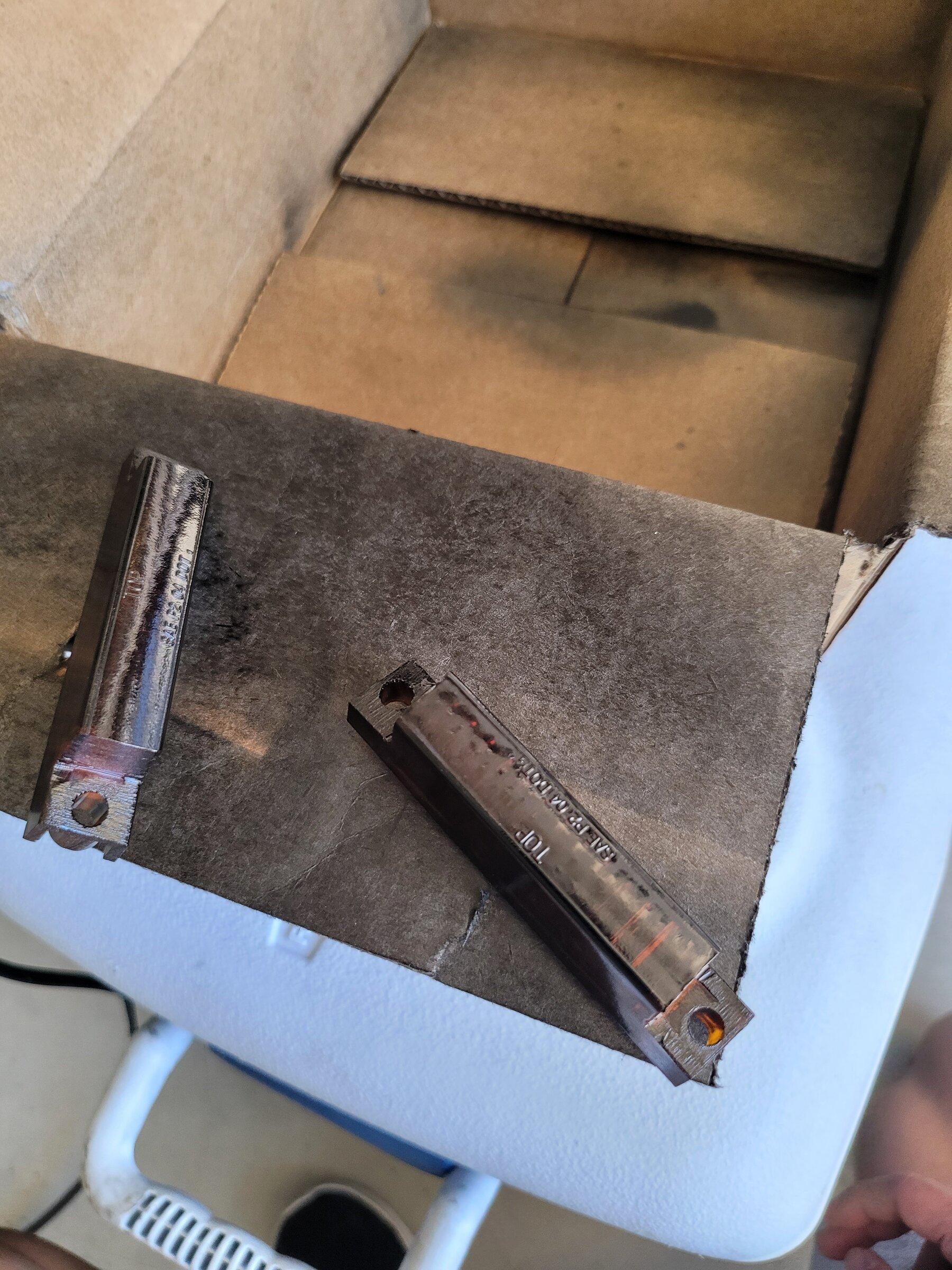

Received my kit but am trying to smoke them so they don't stand out so much. Hope I can still see the LED through the smoke....Will hook up the DD fog backlights that are already wired to the upfitter switches

I may be doing this in the near future. Was thinking about seeing if the window tint guy would put something on them while he was doing my front windows, but I like this better.
