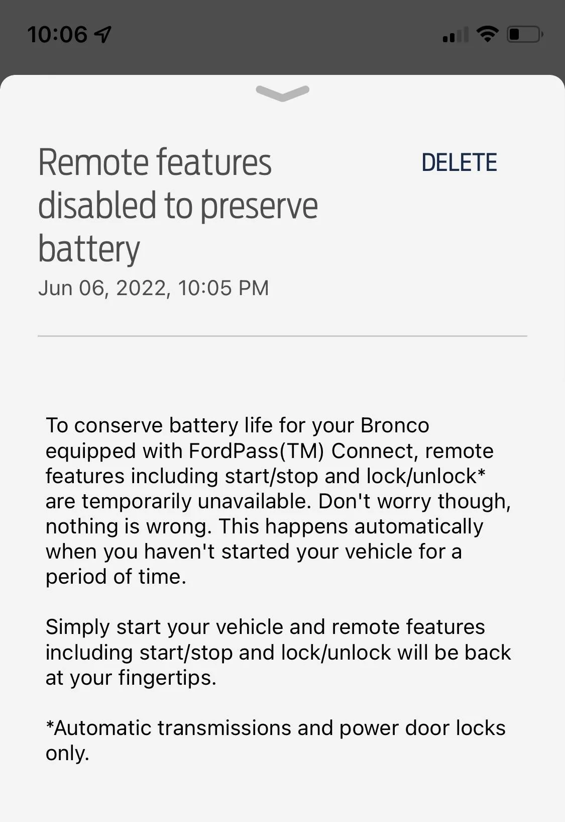

Oh, and I already have a service appointment with Ford for tomorrow morning to look at a battery voltage issue. I keep getting notifications that my Bronco is going into deep sleep mode due to low voltage.
