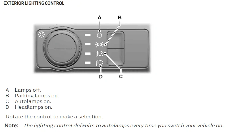

I am experiencing a strange behavior with my headlights.
When I set the dial to off, turn off the ignition, exit the vehicle and lock it, upon returning, the dial is set to auto. Video attached.
I have found my headlights on a few times when parked. In those cases, the dial was definitely set by me to the off position, but I found it changed to the on position.
In addition, sometimes when turning on the vehicle and driving, I have noticed there is no indicator illuminating at all, with nothing lit. Turning the dial "wakes it up".
Has anyone experienced these things? Possible bad switch or programming bug/failure?
EDIT 12/19/22: FIXED
Note: Video below does not correctly demonstrate the issue. This is the default behavior, but can be changed in Forscan to default to last used setting, rather than auto mode.
Issue: Headlamp switch becomes unresponsive ~70 minutes after turning vehicle off. Headlamps then turn on by themselves for approximately 10 minutes. Vehicle then activates power save mode and headlamps turn off. Headlamp switch remains unresponsive until rotating the dial 2-3 times.
Cause: Bad headlamp switch.
Solution: A new headlamp switch was released by Ford to address this issue.
Replacement switch part # (No Fog Lights): M2DZ-11654-GC
Reference: SSM 51166 2021-2022 Bronco - Headlamps Turn On By Themselves When Vehicle Is Off - DTC B1533
Some 2021-2022 Bronco vehicles may exhibit a condition of intermittent headlamp operation while the vehicle is OFF and have diagnostic trouble code (DTC) B1533 stored in the body control module (BCM). This may be due to the internal logic within the headlamp switch. To correct this condition, replace the headlamp switch (service base PN: 11654). Refer Workshop Manual, Section 417-01.

I've been in some cars that you can turn the lights off, but on the key cycle they will return to auto as a default (kinda like the auto start/stop). However if it's actually turning the lights to "on" that doesn't seem right.

Mine automatically switch back to auto if they are in the off position when I get out.
Thanks for confirming that is intended.

In my 2009 F150 I’d hit the dial with my knee on occasion and bump the dial to a different position than what I left it in. Might be what’s happening as that dial is mechanical only I believe.
<edit 2022-02-18> From my experience with my Bronco and with confirmation from the manual, the light switch in the Bronco is electronic, and will return to the “auto” position when you restart your Bronco. Like other switches in modern cars, it resets each use.

Mine does it too. Looked it up and its a feature.
