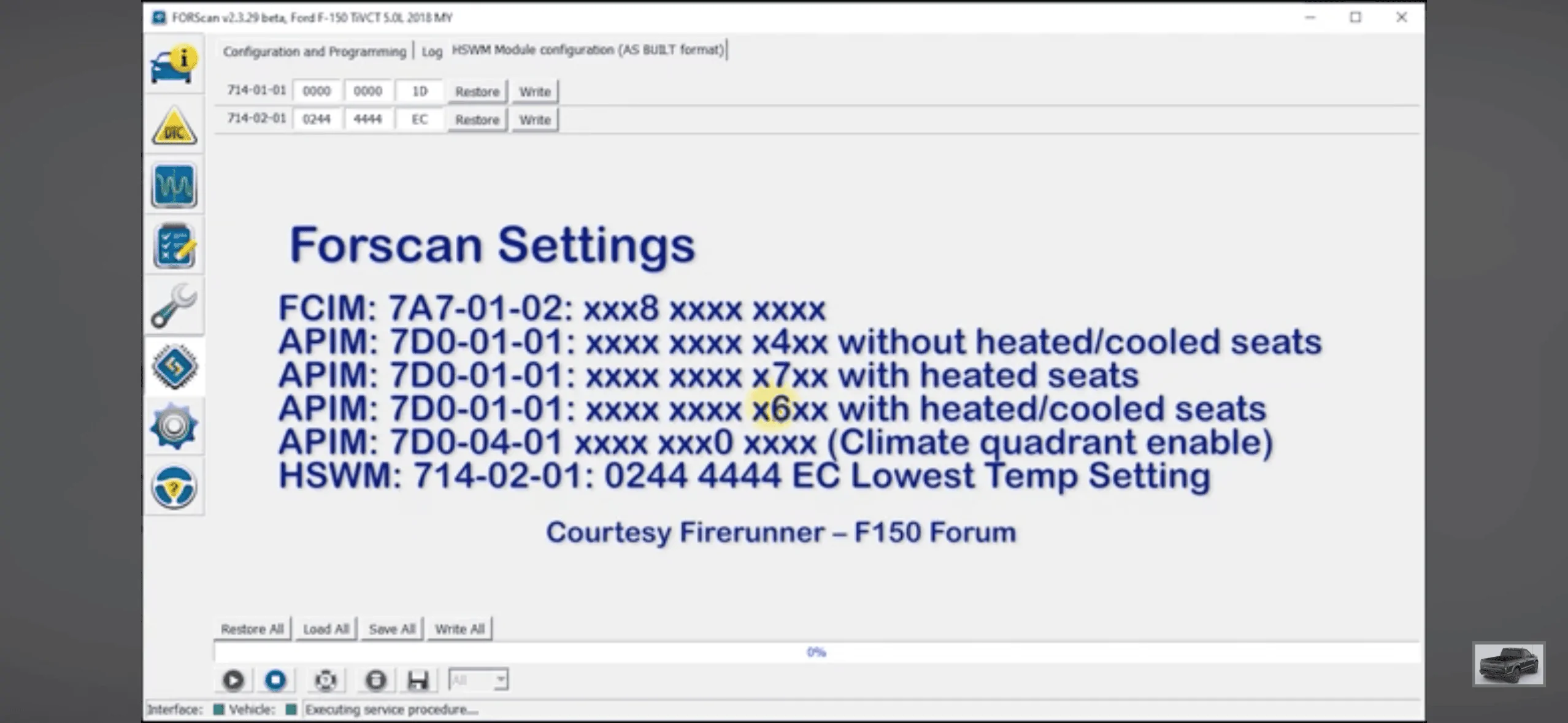

The temperature of the steering wheel can be adjusted via FORscan if that is the issue.

According to a few threads there is a FORSCAN line that changes the temperature of the wheel.

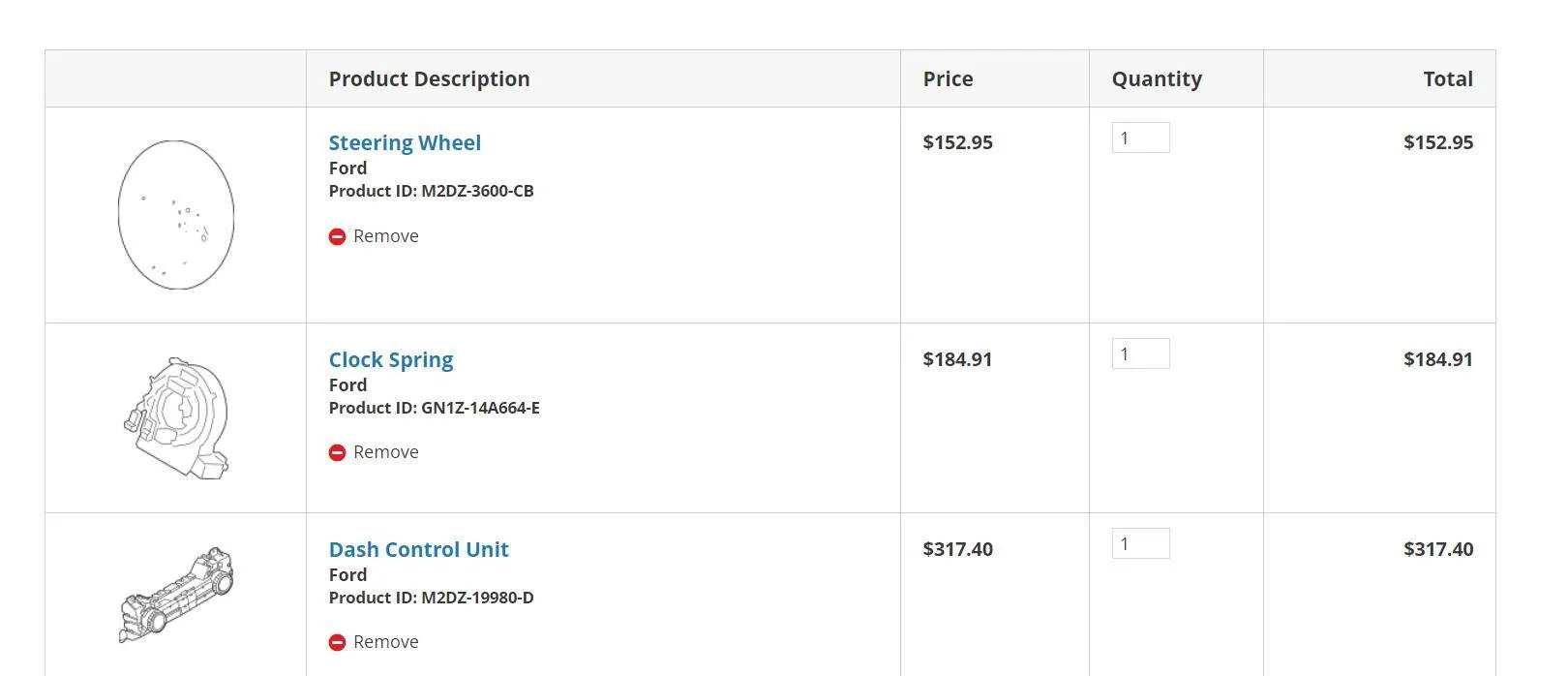

Bringing this thread back alive, heated steering is the only thing I regret not getting LUX
seeing if anyone has dug into adding the heated steering to a high package.
I’ve done some research on the parts page and see that the steering wheel, clock spring and heater controls will need swapped at the least.
I can’t figure out if there is any type of wiring that needs changed or added, I don’t have access to schematics or anything from Ford.
I’m also not familiar with FORSCAN to activate them

Bump! Really interested in this. I just bought an used 2023 leather covered steering wheel with the heated element and all the lane centering and adaptive cruise buttons for my base (I know I need more hardware for the ACC).
