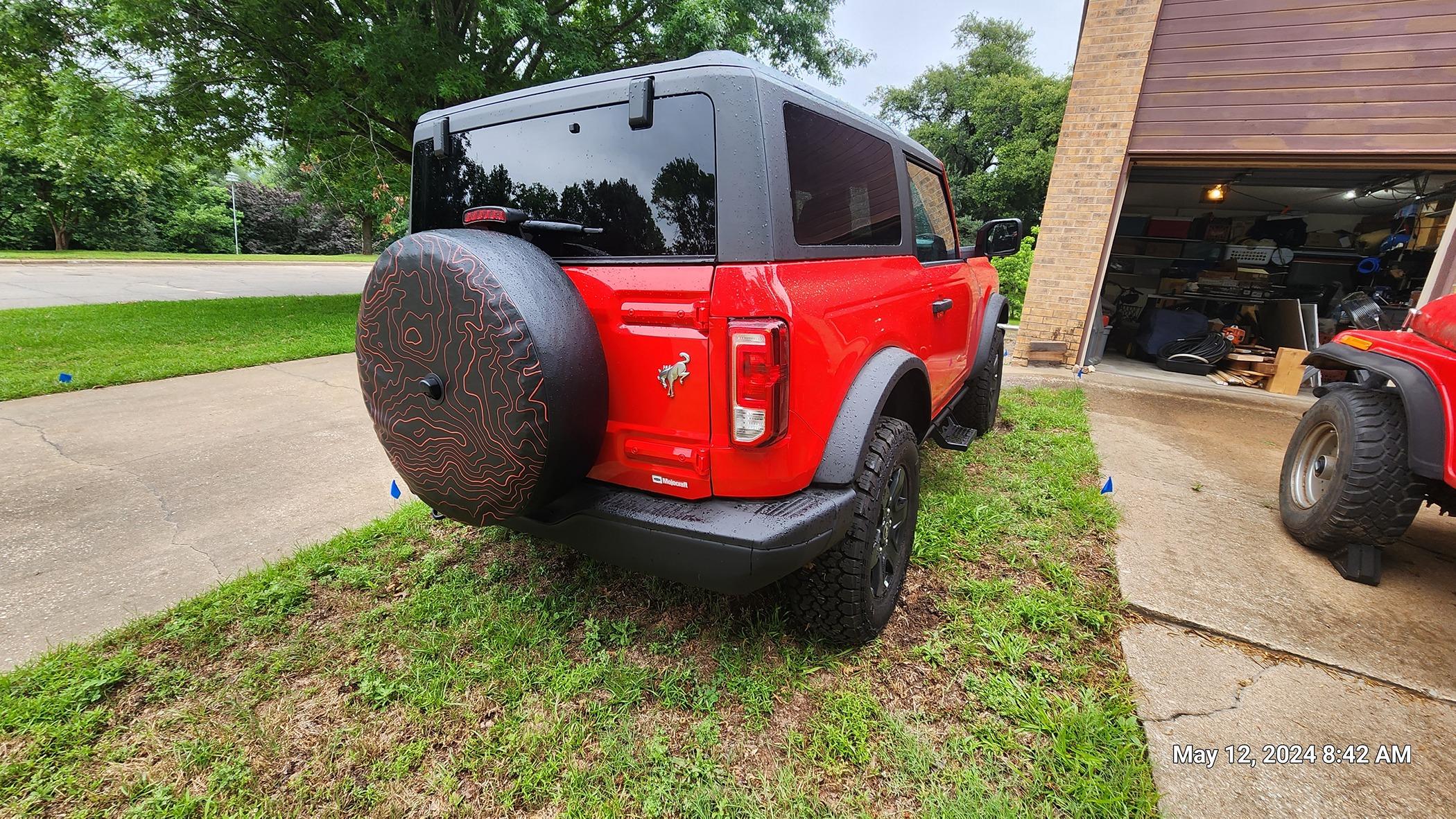

redmudtexas
Mar 22, 2024
2024 Bronco 2 dr
I really love my new BD 2 Dr. I really, really do. Have not been excited about a ride in fifty years. But this thread reminds me why I also
Ford Bronco Heavy Rain Warning Messages 20240512_084236
like my stripped- down '85 CJ-7.
It doesn't argue with me.
