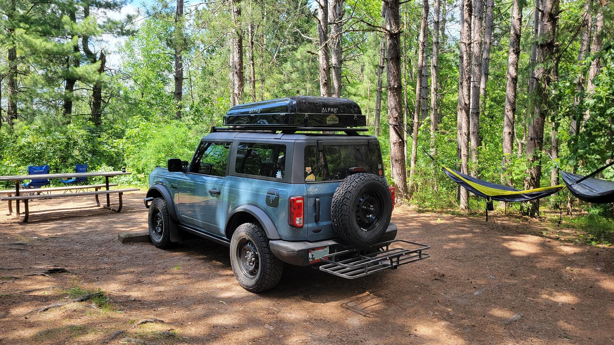

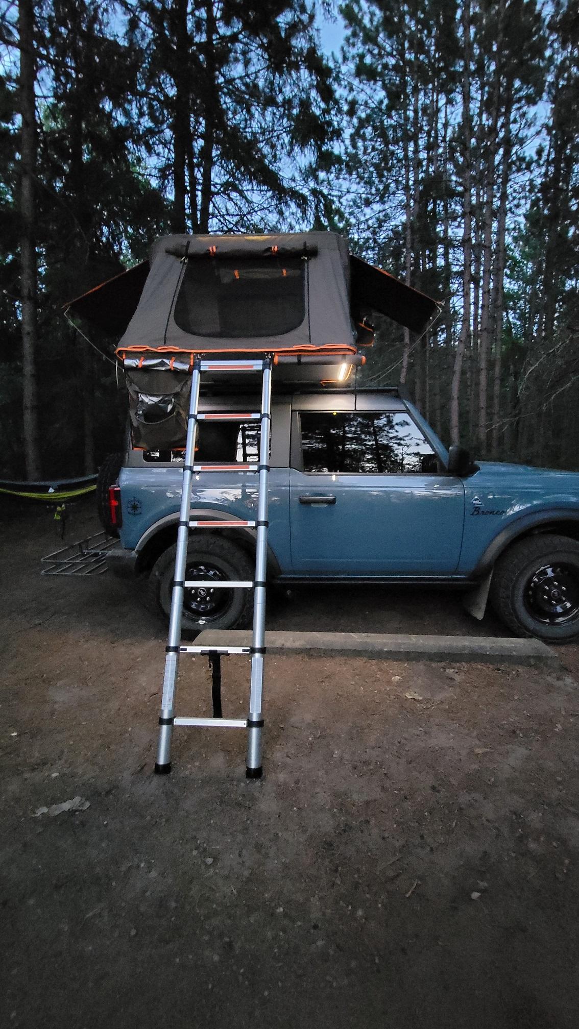

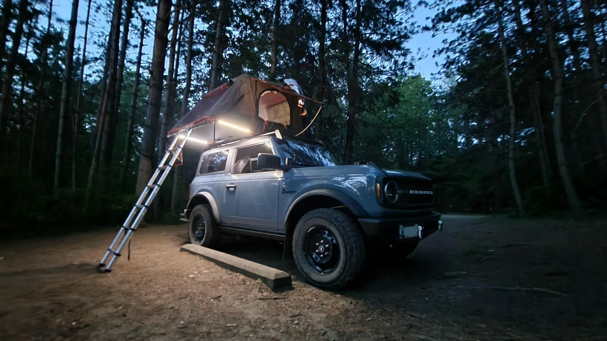

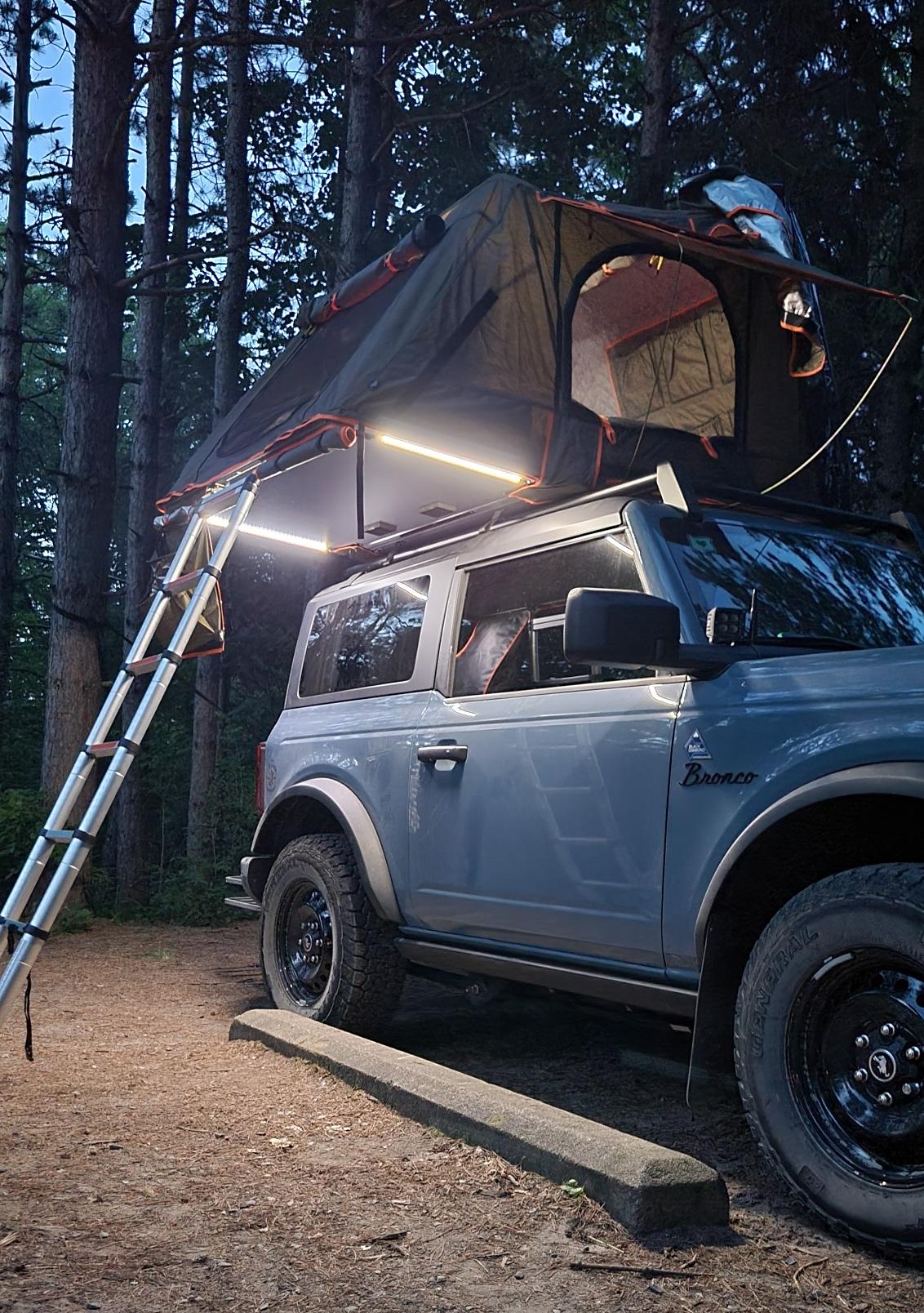

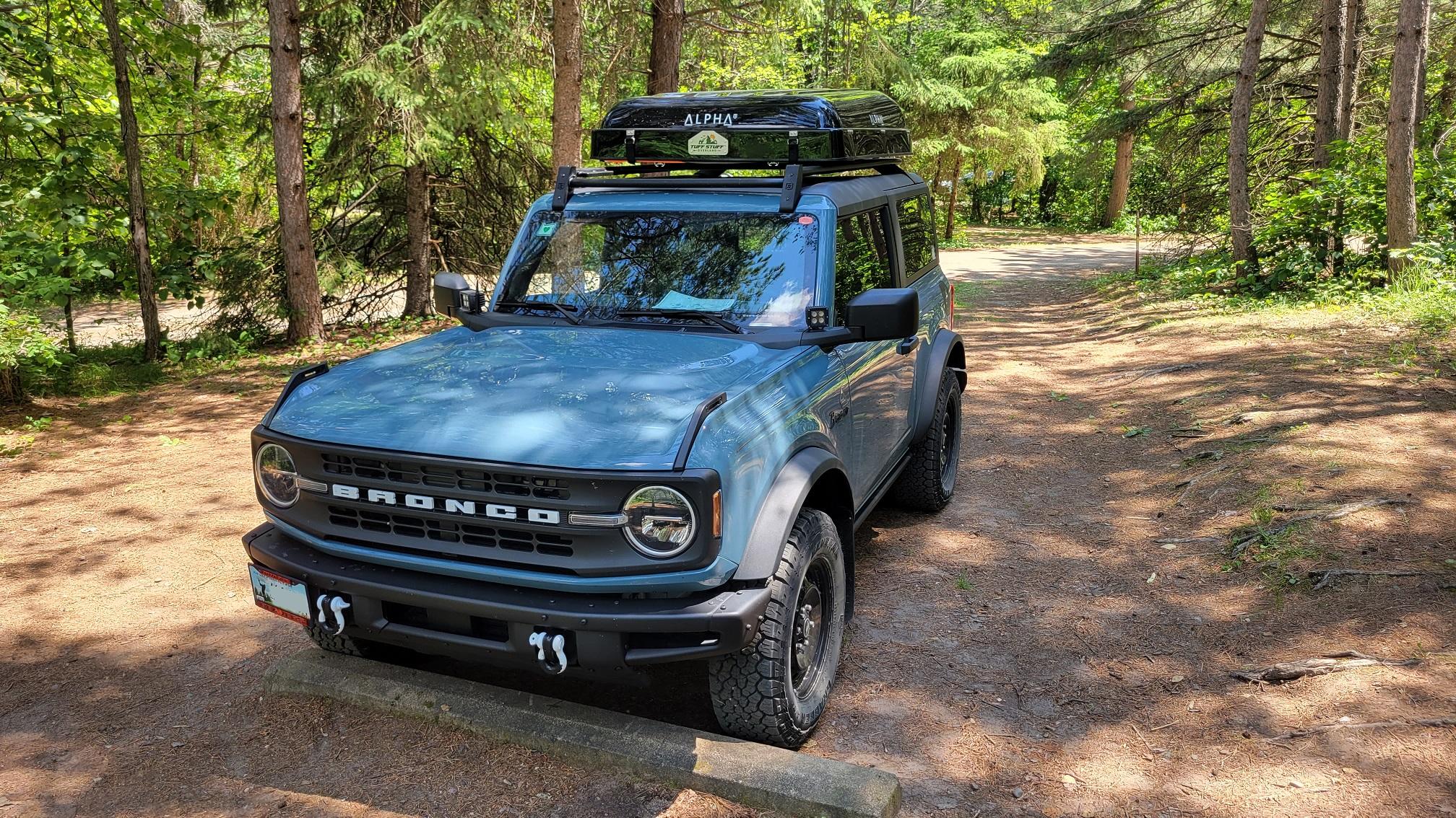

Finally got the tent up and took the Bronco out for her first, and long overdue camping trip!
Zroadz rack and the Bronco roof held up great to the 141 lbs tent, felt very stable and never felt like we were overloading the roof or the rack. With me and my wife and our bags and bedding, we had probably 530 lbs sitting on the rack.
While driving, you barely even notice the tent up there, maybe a little more body roll when going around a highway clover. I kept speed down to about 65 mph max just to be safe since it was my first time driving with it up there. Wind noise seemed pretty much the same as having just the rack with no tent, I expected it to be a lot worse with that up there. Didn't do any offroading this time but the gravel roads did get a little bumpy and the roof didnt make a peep about it, handled the jostling just fine at about 25 mph. Also, I expected my mileage to be a lot worse but I was getting the same mileage with or without the tent, about 20.2 mpg. Without the tent I definitely drive faster and harder, so makes some sense that I was getting the same mileage driving like my granny with that up there.
Two tips I have for anyone considering the Zroadz rack for a RTT:
1. If you can't use brackets around the crossbars and have to install the tent using bolts through the holes in the crossbars, I would suggest taking the rack off the Bronco, install the tent and tighten the nuts, then install the rack back on your Bronco with the tent already on it. The space between the roof and the underside of the crossbars is so tight that it was hard to get the nuts tightened down. Also, due to the shape of the rear crossbar, you can get about 1/20th of a turn each time, so even with a ratchet wrench it took me forever to get the nuts tightened down. Which leads to my next point.
2. I should have replaced the bolts that came with my tent with shorter bolts. With how hard it was to get my hands in there, it was really a bummer to have to tighten the nuts almost 2 inches up the bolt getting tiny turns each time because they were locking nuts and were too tight to spin by hand. Also, the ones that came with my tent stick down a little farther than I would like. When removing the front panels, I have to be really careful to not drag the sharp end of the bolt across the roof panel.
Overall, I'm very happy with the rack and how it handled a 141 lbs tent. Very glad I sold the OEM rack and got the @ZROADZOFFICIAL rack!

The OEM rack had a dynamic weight limit of 110 lbs and the tent I had weighs 141 lbs. The Zroadz dynamic weight limit is 240 lbs and also had a much higher static weight limit at 570 lbs. It even listed an offroad weight limit of 195 lbs. There wasn't much to the OEM rack, it just isnt very useful for anything big or heavy.
For the cargo carrier I went with the Ironton Steel Hitch Cargo Carrier from Harbor Freight. I only use it for firewood so I didn't need anything crazy, it was on sale for $50 so I just grabbed it. It seems a little shakey on there but once you have weight on it it doesn't move. No extender on my hitch so the spare tire would be in the way if I tried to put a bigger item on there like a cooler or something.
