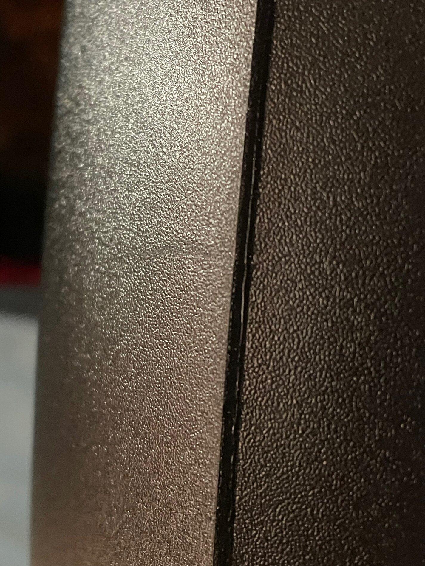

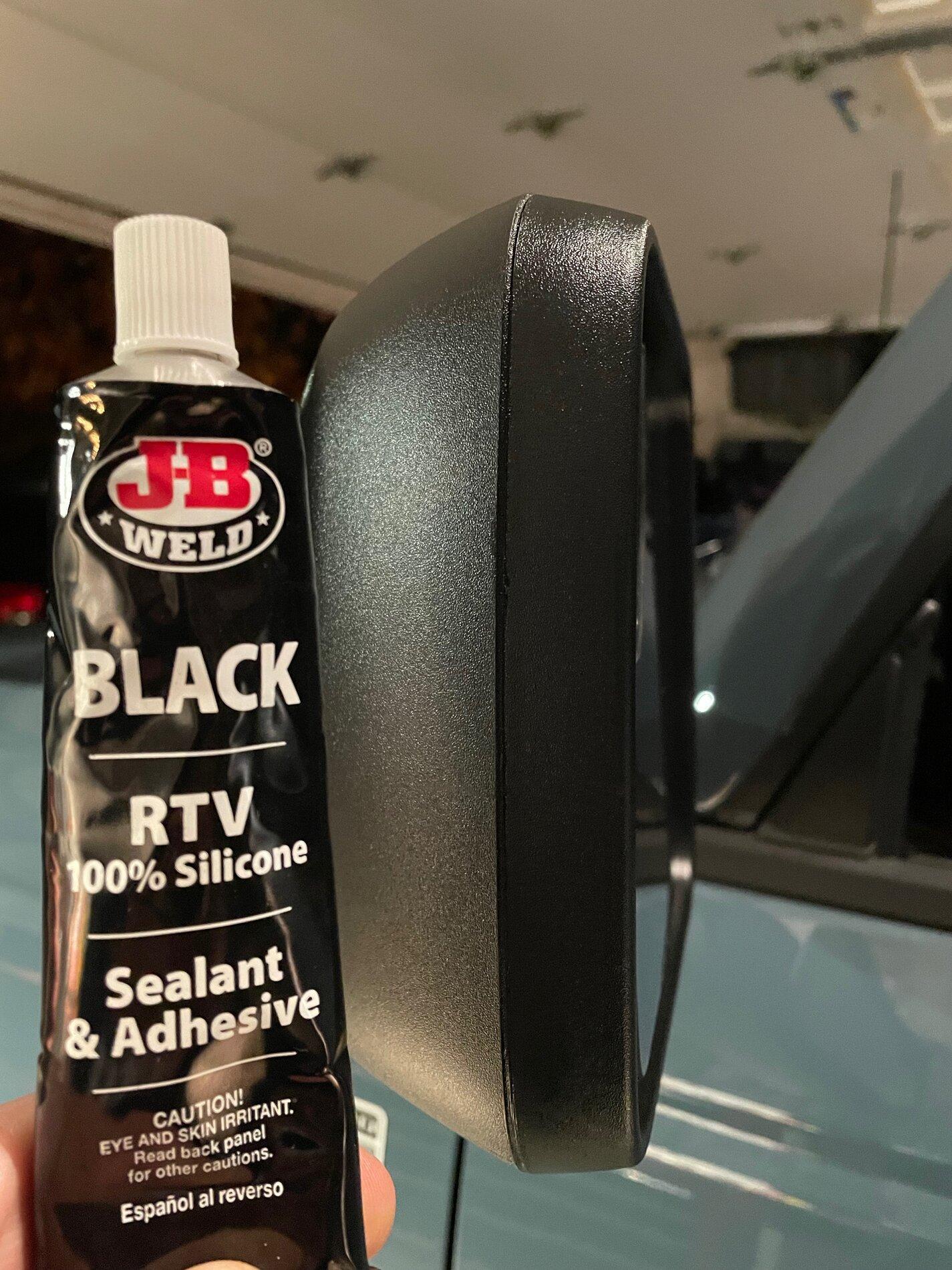

Hey all! So here's a super simple fix to the obnoxious whistle coming from the driver's side mirror-- which admittedly took me some time to pinpoint. I'm sure there's a handful of other fixes out there, but this worked for me.
Run some RTV along the seam. I ran some painter's tape along the outside of the mirror just to keep a clean line, but otherwise it's just that simple. Whistle gone.

I happen to have some RTV in the garage, will be trying this tonight. Did the rtv want to stick to the tape when u removed it, or did u run a blade across the edge before removing tape?

Nope, no sticking. I just ran a small bead and then smoothed it over with my finger, pressing it into the crack. I pulled the tape immediately- last pic was fresh RTV before it cured.

Yes, It did go away when I folded the mirror in and when I placed my hand along the outside, which ultimately led me to the root of the problem. My whistling started around 30/40mph. The good news is this fix completely eliminated the mirror whistle.

New BB owner. The wind noise drivers side mirror still an issue. The seam on the edge as pictured in other posts is the issue. You can feel the edge with your hand. Filling the crack or covering with electrical tape will fix it. I filled the crack with black flex seal. Can't see it unless you're looking for it.
