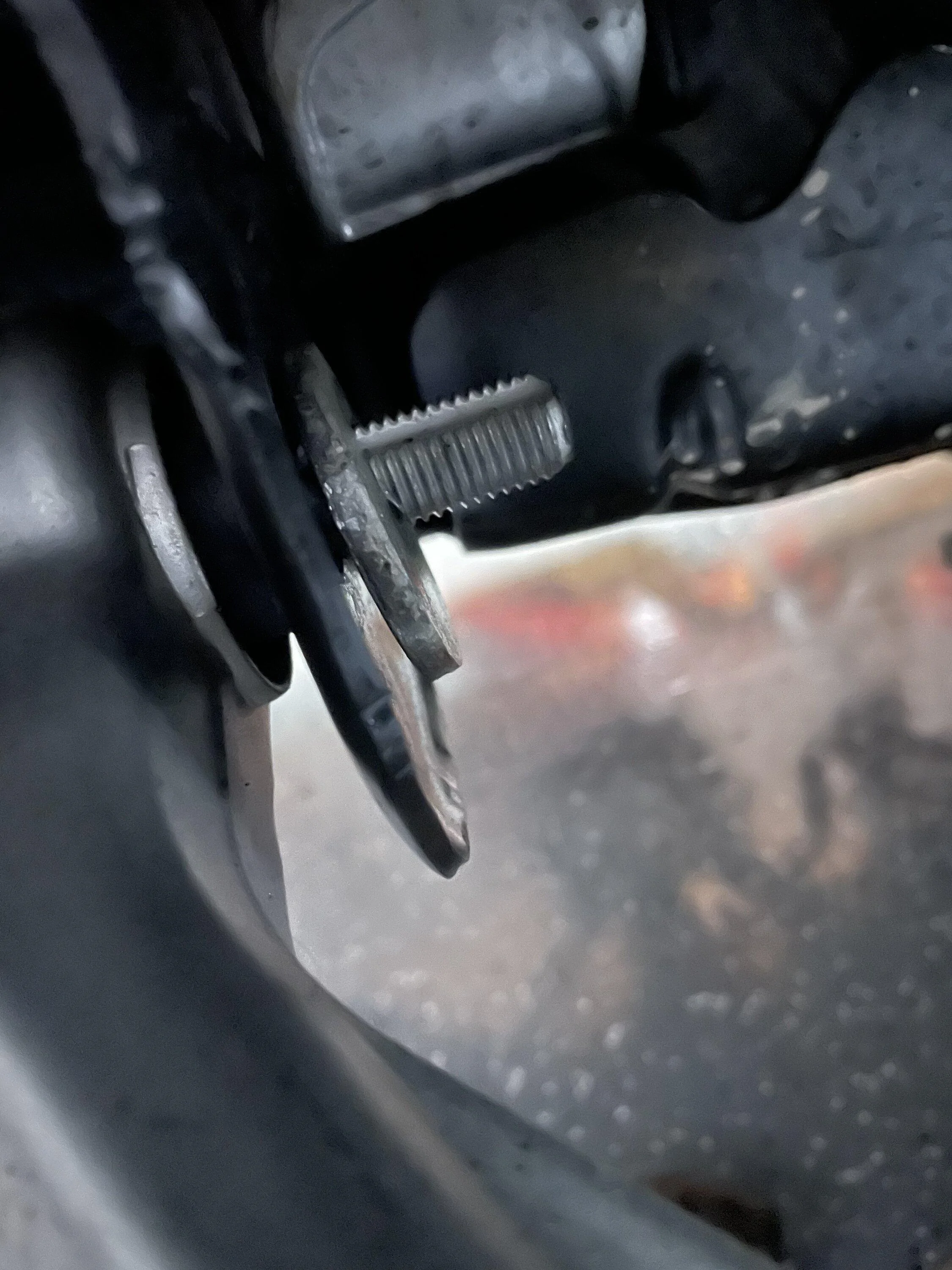

I can’t seem to get them out. Installing leveling kit and got nuts off but seem to be stuck. They just slide out, correct?

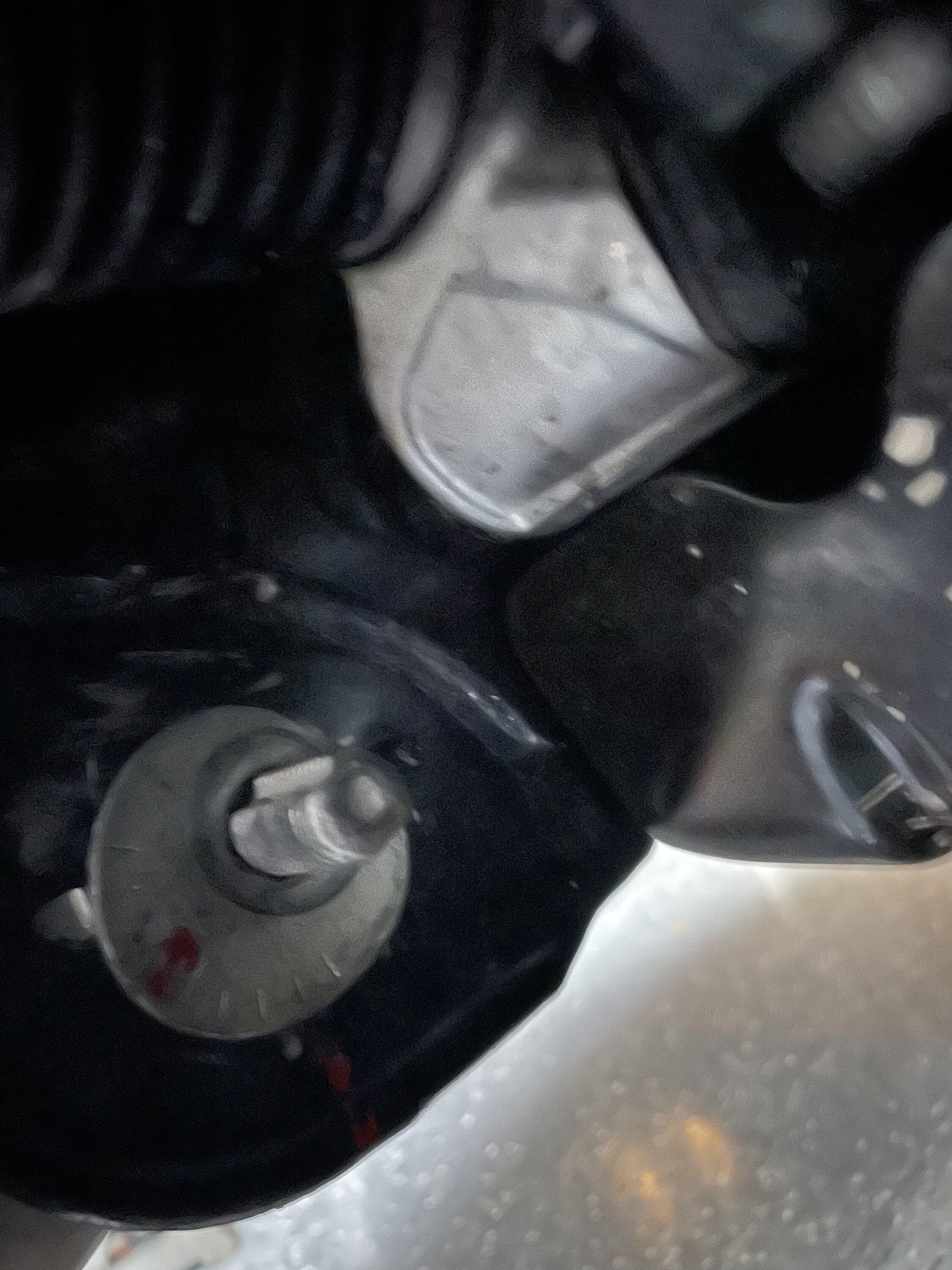

Makes sense. Shouldn’t the cam washer come off freely and bolt tap out? I’ve removed tension on arm and still seems immovable.

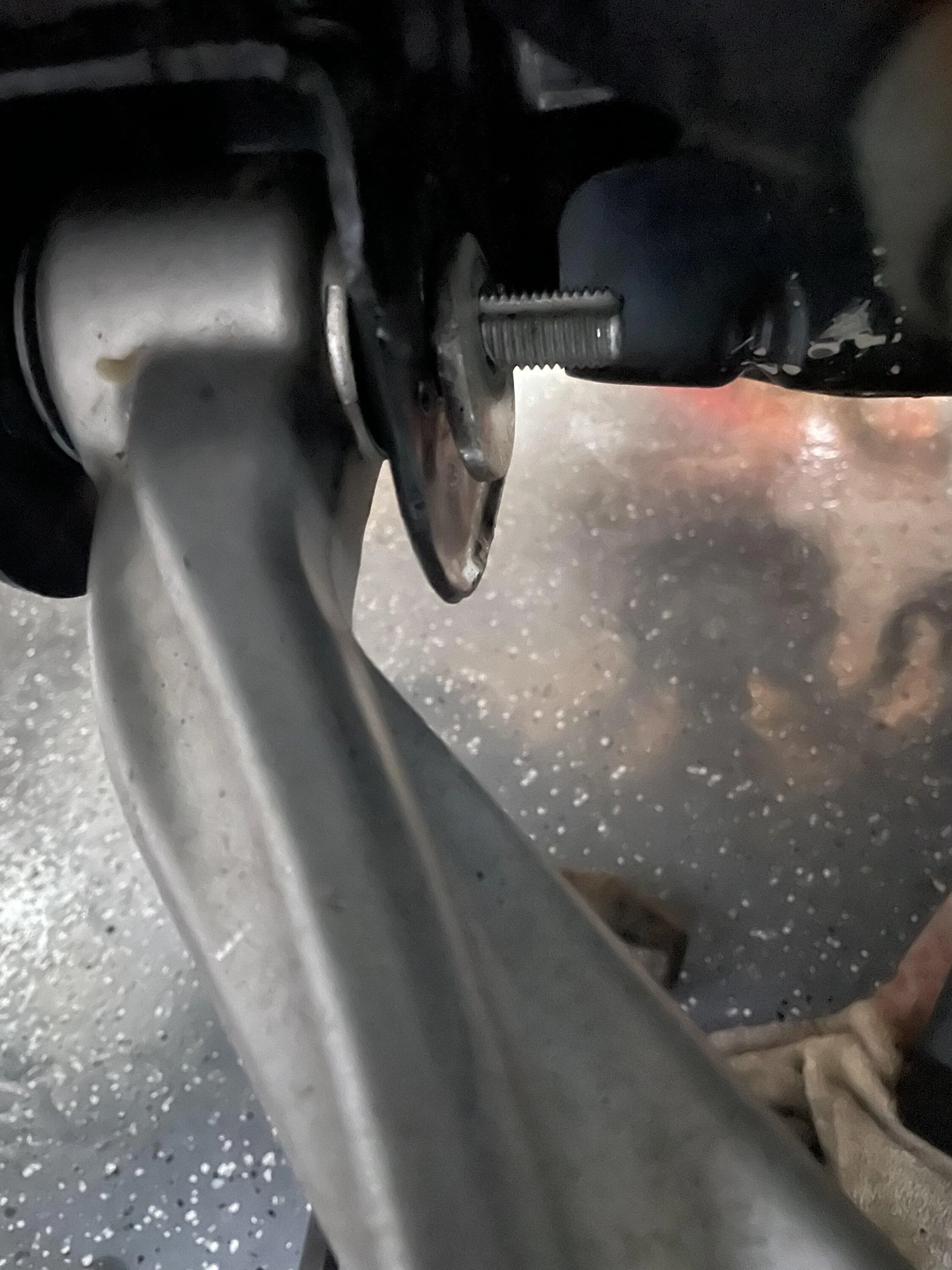

Not sure if you figured this out but after disecting ours last night for our RC lift it appears your cam washer has twisted on the bolt?

I second this. If this is the case, you will need a hammer and a new set of cam bolts and washers. This can be caused by trying to loosen the bolt instead of loosening the nut.

Yes, it’s now clear. I didn’t remove via the nut side and, therefore, torqued the cam washer onto bolt pinning washer to frame. Not fun to remove. Note to others…. Put a wrench on bolt side and don’t allow to move and use impact on nut side and bolt slides out without issue. Very simple and kicking myself for such a no brainer. I have all new hardware. Other side was done in an hour and even installed revised crash bars. I look brilliant on other side of car😁
