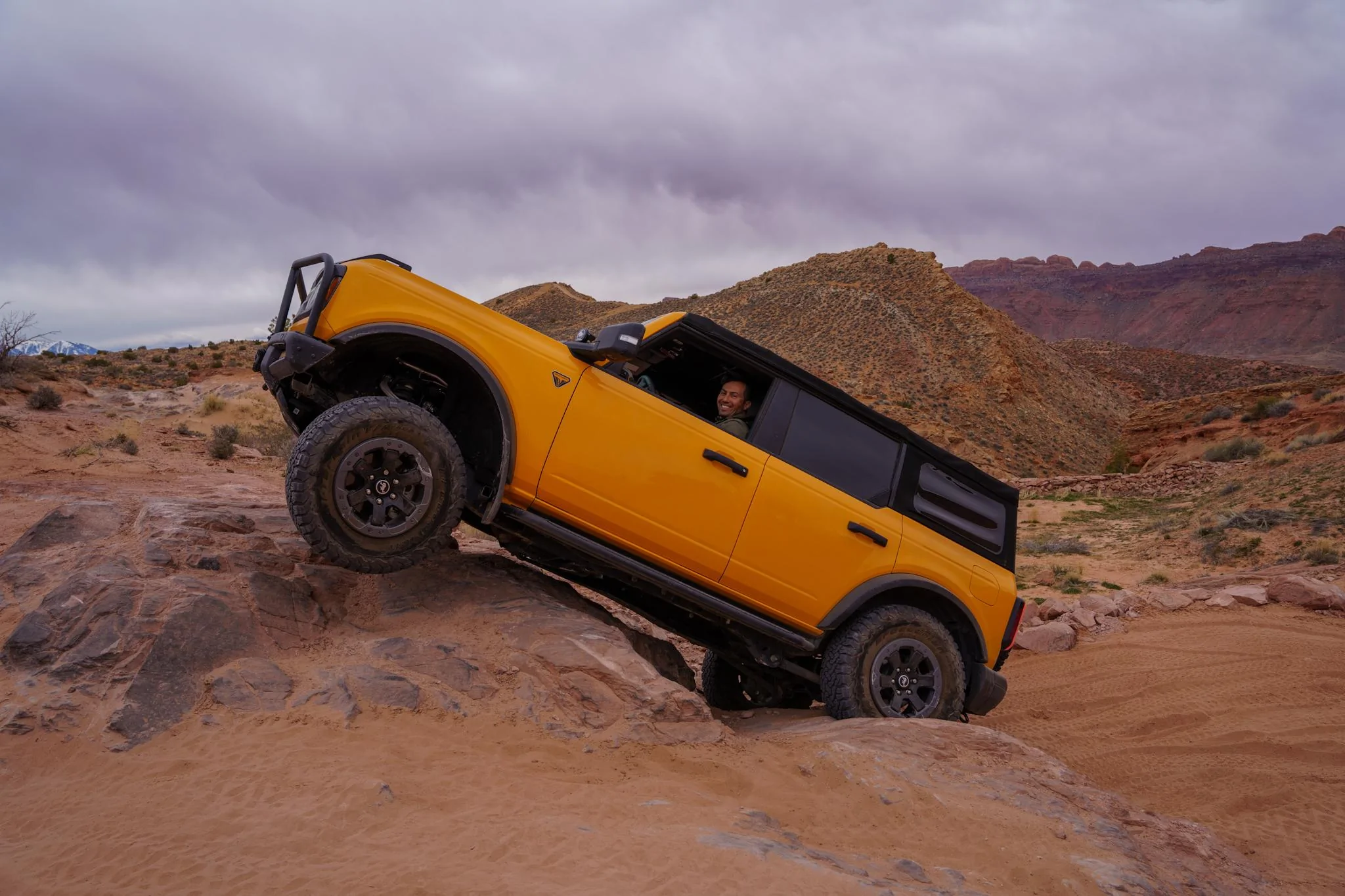

Hey all,
I’m working towards self-squatching my non-SAS BL, and I was curious for constructive feedback on how the Zone 1221 might compare with a “cheaper” coilover option like the 6100’s. ~ $175 vs $1,100 parts.
I know there’s the perch collar options as well, and lots of coil overs. I’ve mostly settled on my decision being between Zone’s hybrid 2” lift and the Bilstein 6100’s. As far as I can tell, the 6100’s seem to be at a great point of cost vs quality…and it already came with Bilstein 🤷🏻‍♂️
I’m mostly daily driving, but want it capable. I took it to Moab earlier this year, and I’m sure I’ll go back, but I’m doing more local in Texas. After that Moab trip, I decided I only wanted and extra ~2” lift. I’ll probably only 1-3 trips per year going forward. I can’t justify $4-5k for King or Fox, but I could probably justify 6100’s.
