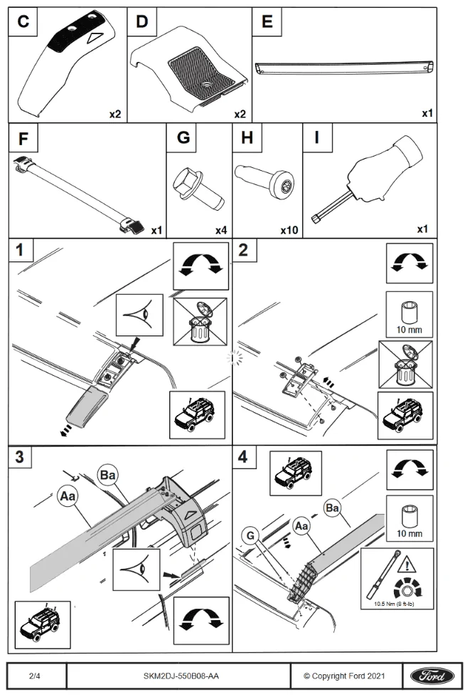

Hello, friends
Bought a roof rack second hand, didn’t get all the bolts included. I’m hoping someone can help me identify the bolts marked G so that I can get my hands on em. If you could help with a part number that would be even better. Thanks in advance for your time.

Have tried threading H in to see if threads match? If you’ve got any spare bolts laying around, experiment to find thread size and then go find the right style/length at the hardware store. I didn the same with after market second hand rock sliders and awning mount that were missing bolts. I’m sure someone will give you the right answer soon, I just wasn’t that patient enough…lol. A lot of 8/10 mm bolts on these trucks too.

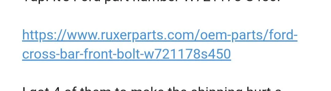

Maybe u could message @DaveInSA looks like he was missing "H" so maybe he knows what "G" is. Looks like a website he used to buy was successful

Ford Rail Nut W721183-S450B
